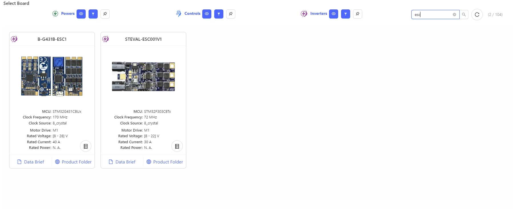

Dear ST Team,
I have a STEVAL-ESC002V1 board and tried to generate the source code using MC Workbench, but I could not find the STEVAL-ESC002V1 board in the available options.

Hello ​@Prashant016,
The STEVAL-ESC002V1 is not supported by the MC Workbench.
The firmware is available at the STSW-ESC002V1 Product page, and it is an IAR Embedded Workbench® project.
Ask STM32 Sidekick (bottom-right window) how to create an STM32CubeMX project from an IAR Embedded Workbench® project.
