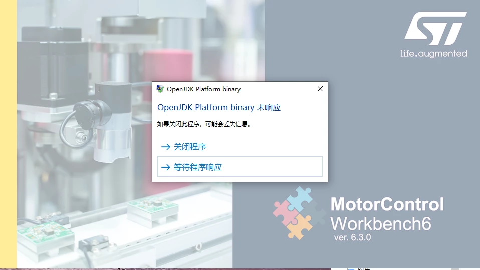

btw, when I open the Workbench, many times I get this as below
even when I used STM32cubeMX, I got the openJDK issue, how can I do to deal with it?
Thanks.

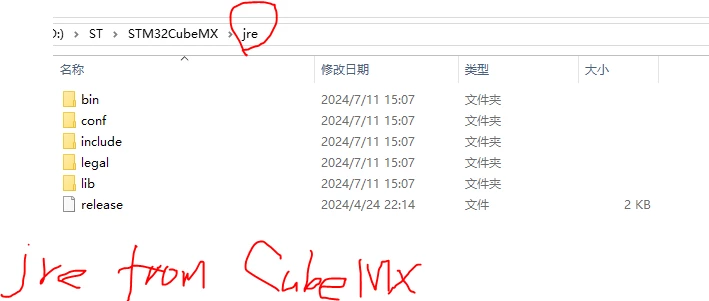

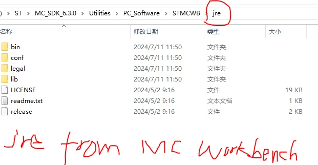

dqsh06Author
Senior
October 16, 2024
hello @GMA
- MC Workbench Ver6.3.0, STM32CubeMX ver6.12.0
- OS: windows10 professional 22H2, Ver19045.4780, simplified Chinese.
- JRE is within MC workbench. jave version: 11.0.20.1, JRE version:11.0.20.1+1-LTS
   I am not sure it is older or not, it was installed by MC workbench Ver6.3.0
   but there is another JRE, which is within STM32CubeMX, java version: 17.0.11
   why MC workbench and STM32CubeMX are not the same jre?  I dont know, it was installed by ST.
   below as your reference.
- I only has 1 PC, I am not sure on another PC.
Thanks.
GMA
October 25, 2024
Hello @dqsh06,
As error is not systematic, could you verify, via your task manager, that no OpenJDK process remains active once all WB/CubeMx processes are closed?
May be that using MC Workbench Ver6.3.1 could help.
If you agree with the answer, please accept it by clicking on 'Best answer'.Best regards.GMA
