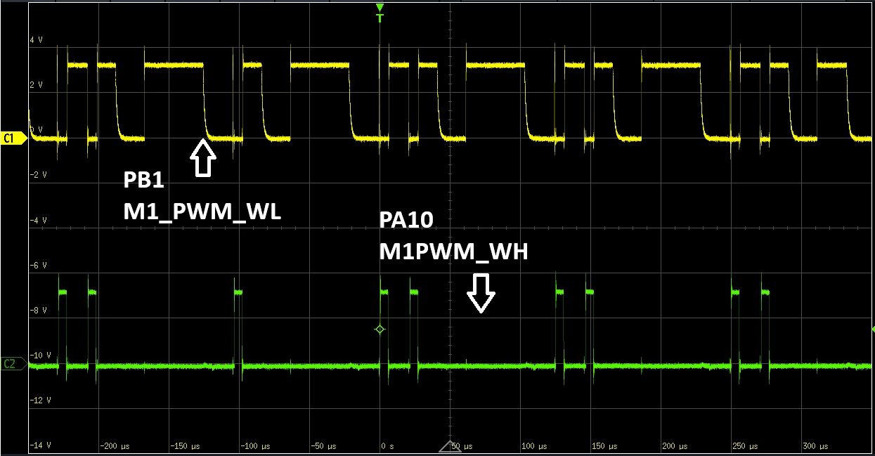

When I try to start the motor through the Motor Pilot, the PWM output looks glitchy and irregular (see appended picture), and after a few seconds, the Motor Pilot reports "Port Open but no answer from the board." Note, I have not even connected the Nucleo boards and IHM11M1 board together at this point. I'm only using the control board.

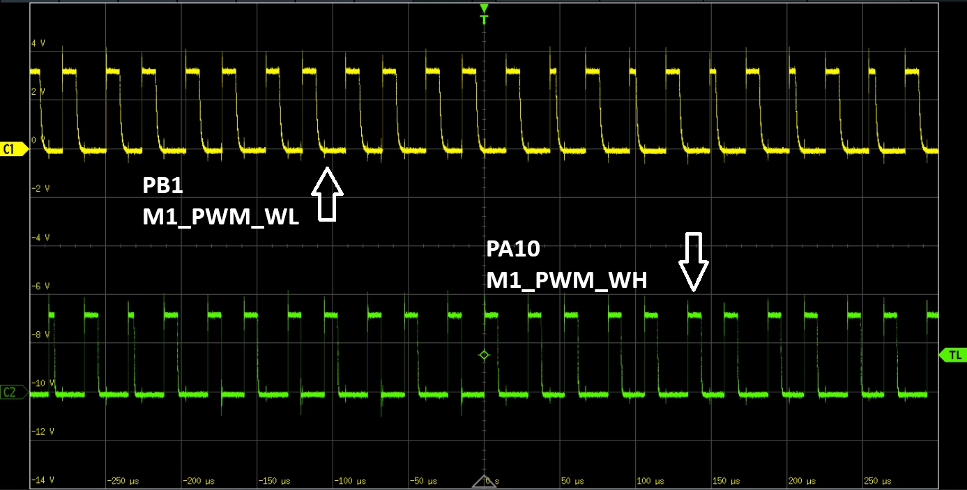

The expected behaviour/output is shown in the picture below and I got this from a project using a F401RE nucleo board.

-) My first thought was that the application was still overloading the MCU. In an attempt to minimize the workload for testing purposes, I tried lowering the PWM frequency to 2 kHz and running the 6-step algorithm at a period of 5 times the PWM period (3 ms intervals).
-) I compared the generated IOC file for the F401RE and the F030R8 projects. The only difference I saw and could not explain was that in the timer 1 settings for the F030R8; the generated configuration from the MC Workbench did not preset the clock source to be used. I've tested setting it to use the internal clock.
-) I tested generating the project using both HAL and LL drivers for the peripherals.
-) I've created an inverter board using the recently released board designer for the MCU sitting on a Nucleo - F031K6 with the same resulting PWM outputs.
None of the tested countermeasures improved/noticeably changed the generated PWM outputs and the motor pilot behaves the same.

Hi GustavEckerbom, the default setting of PWM frequency for a MCSDK project (i.e. X-NUCLEO-IHM11M1 + NUCLEO-F030R8) generated with WB6.3.0 is 15KHz. I read that you tested from 2KHz to 10KHz, but did you try with this 15KHz value?

After returning after my holiday I reinstalled the MCSDK 6.3. STM32CubeIDE and cubeMX to the latest version and this particular problem was not present anymore.
Thanks for everyones input.
