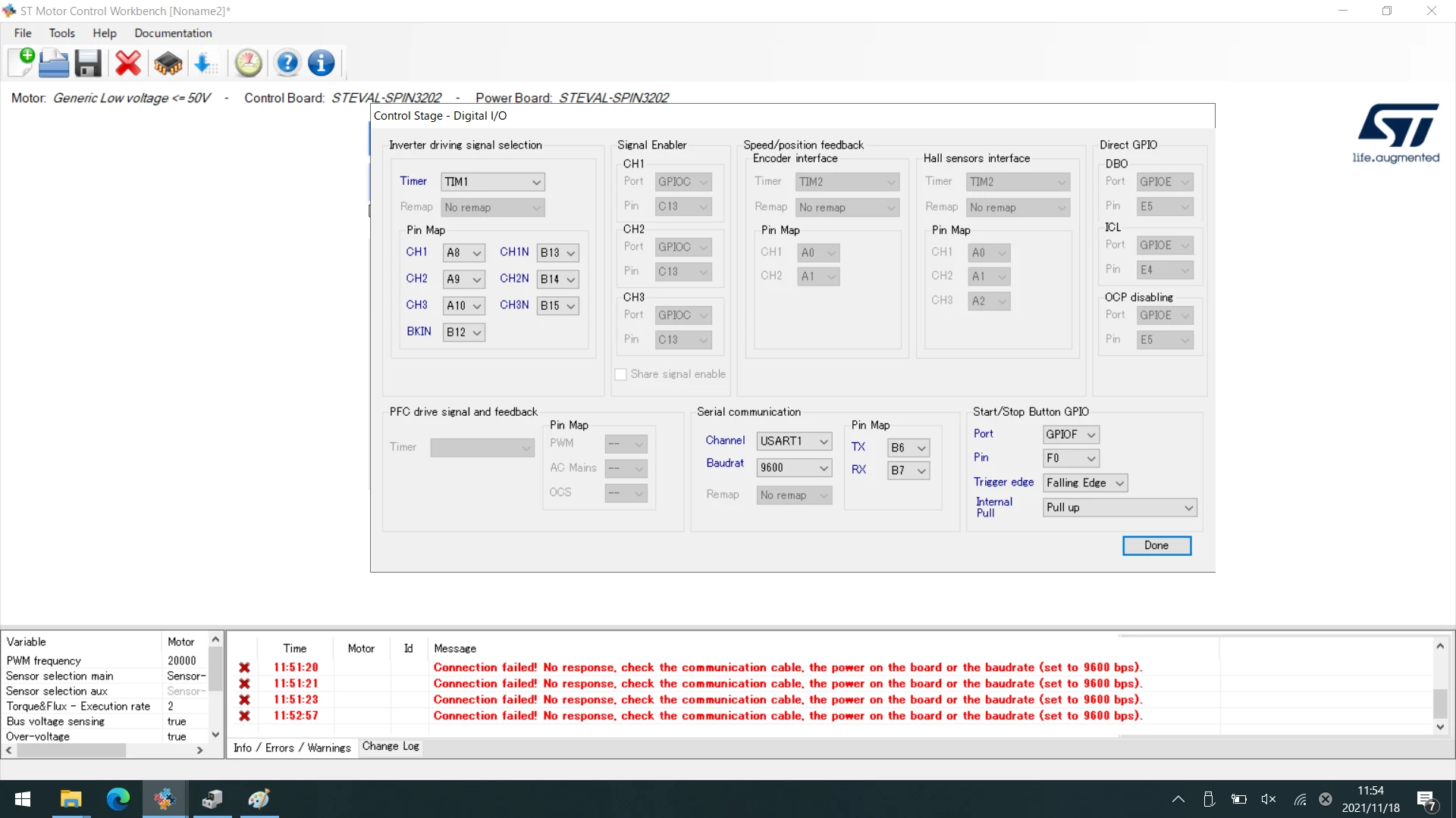

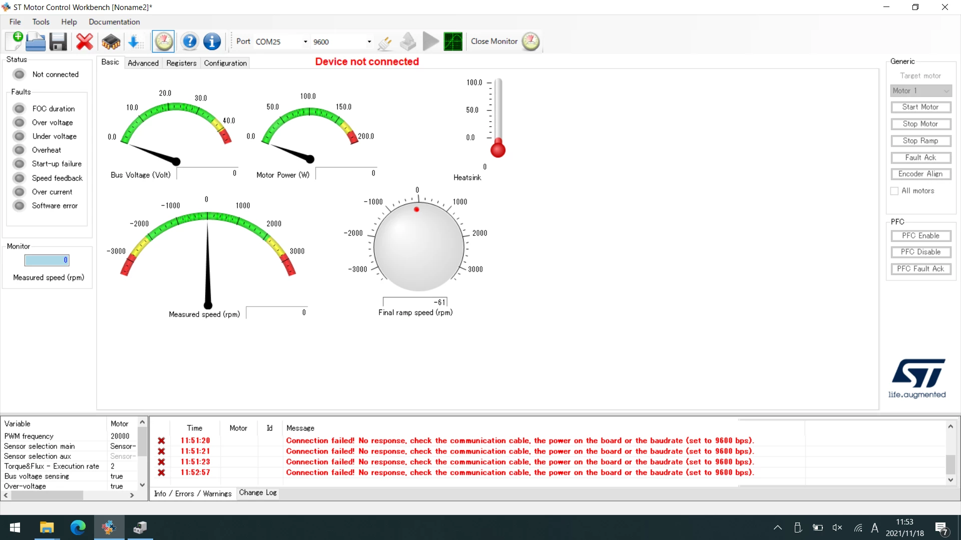

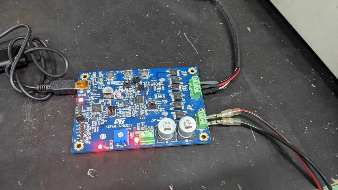

STEVAL-SPIN3202 workbench connection problem (Already Set Baudrate).
I'm just getting started with STM32 and got my hand on STEVAL-SPIN3202. I did follow the manual and install X-CUBE-MCSDK, stsw-link009 driver and everything the manual suggested. However, I couldn't get the workbench to regcognize the board and keep getting the error "Connection fail! no response, check the communication cable, the power on the board or the baudrate".

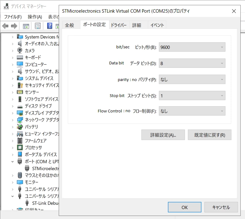

I did look around in this forum and realized this is a common occurance. However, even though I making sure setting the workbench baudrate, Digital I/O parameter and Device manager comport baudrate to 9600, the problem still persist. I did re-generate the code everytime I change the parameters so I don't know the cause of the problem anymore.
