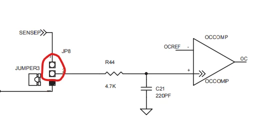

The comparator of the SPIN32F0A can be used in two different ways:
  1. OCP when connected to the BKIN input of TIM1
  2. Current control when connected to the ETR input of the TIM1
I guess you need case 1, so the proper hardware configuration in your case is Jumper 3 closed in 2-3 position:
In this way you will sense the voltage on the shunt directly instead of the amplified value.
If this is already your configuration, please share some of your waveforms.

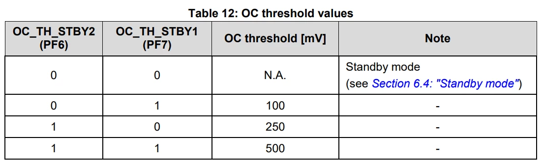

Another question, what about the reference threshold of the comparator? STSPIN32F0A can select between different intervention values:
Enrico

Hi Enrico,
I am attempting to use Hall Sensor control. I have tried all of the threshold values to no luck. I found that the signal that led into the comparator was very noisy and that seemed to be tripping the comparator.
