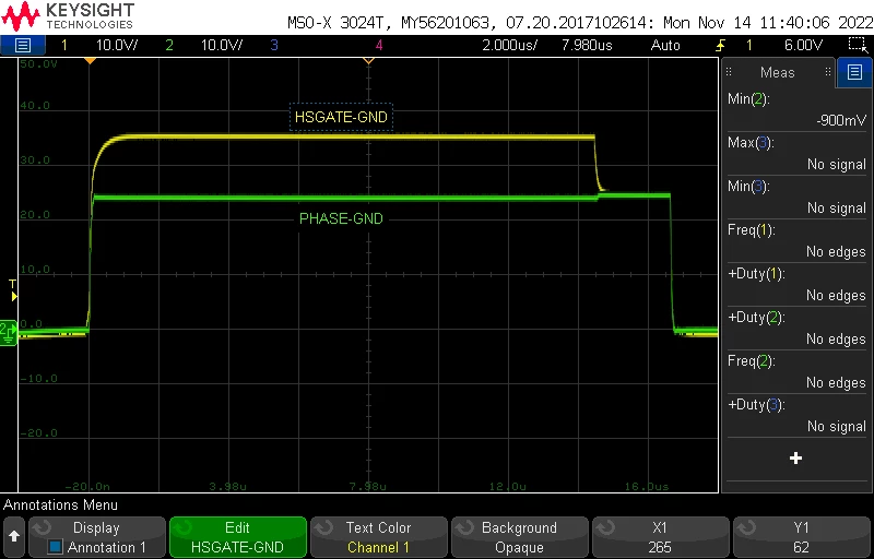

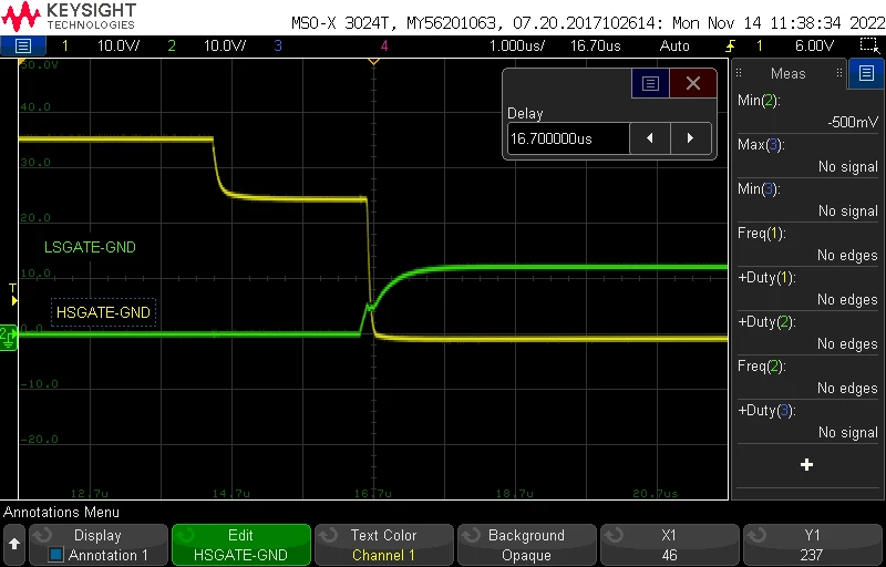

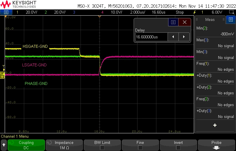

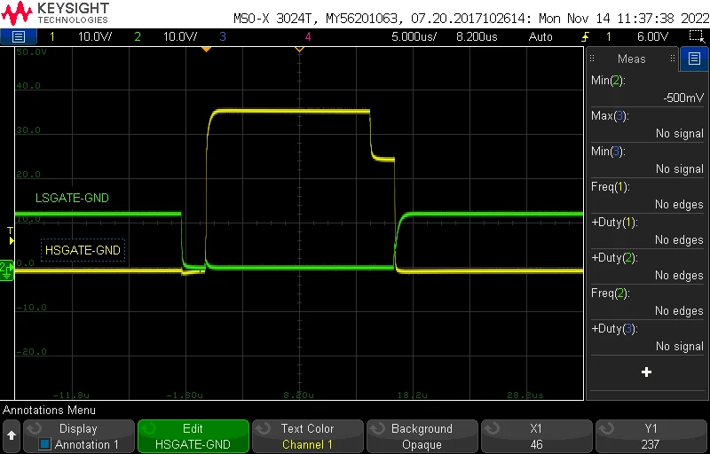

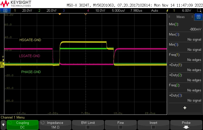

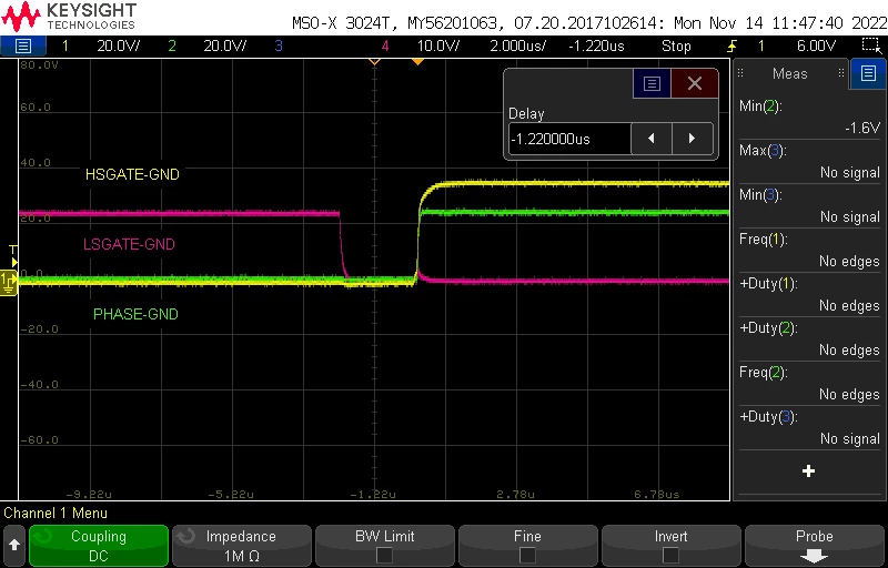

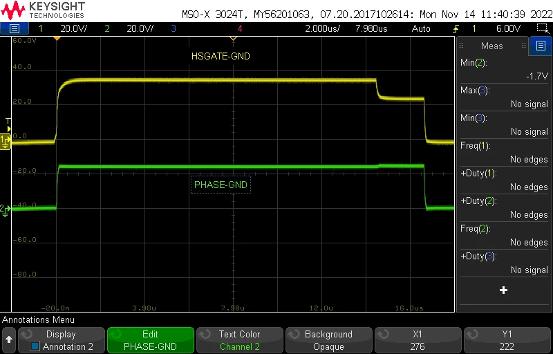

I have a steval-spin3201. It includes stm32f031 mcu. I am programming it by using stm32cubeide. When I was testing PWM and dead time, I noticed that the one of phase output is not synchronous with mosfet gate signal.
I shared the scopes below. Can you help me to understand?0693W00000WIGEmQAP.png0693W00000WIGESQA5.png0693W00000WIGE3QAP.png0693W00000WIGEwQAP.png0693W00000WIGFkQAP.png0693W00000WIGFLQA5.png0693W00000WIGFzQAP.png

Your waveforms show expected device behavior.
During the dead time the phase output is in high impedance and its voltage it is not driven at any level.
