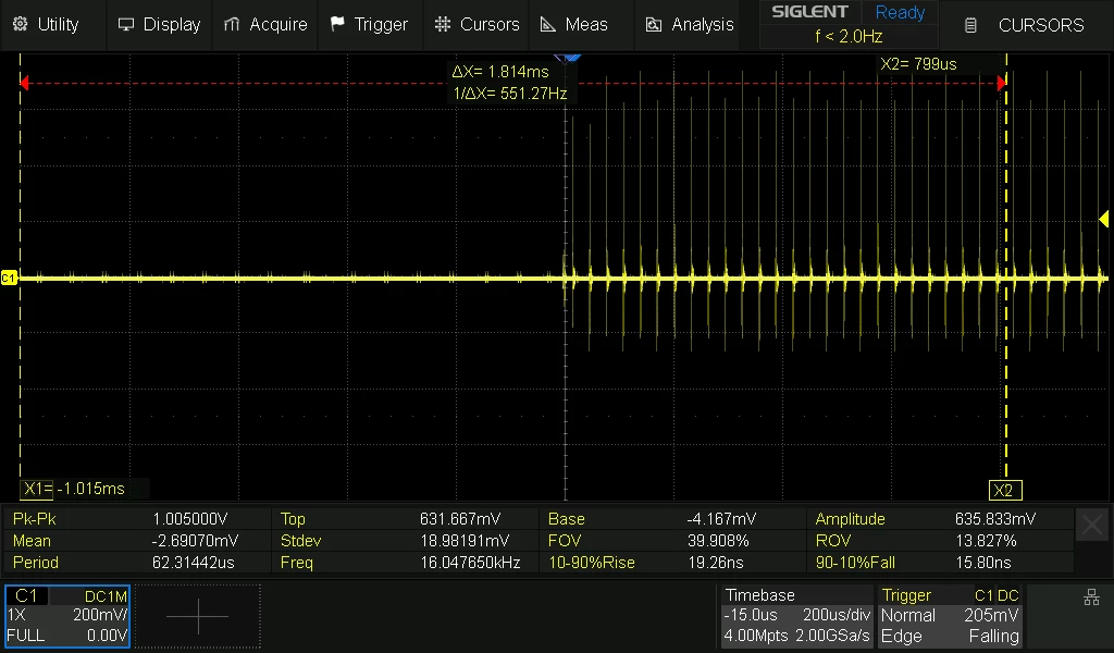

When the start command is issued on the STEVAL SPIN3202, while in FOC mode, the board immediately falls into overcurrent protection mode. The voltage on the current sense resistor is captured in the attached oscilloscope image. The board is configured as follows: Header JP8: Pin 2-3 closed, FOC mode. Header J11 closed, Header J12 open.
When overcurrent protection is turned off in the MotorControl Workbench, there is no PWM output.
The motor is driven in sensorless mode, 30V DC, 10A max. When start is pressed, a short audible "click" can be heard from the motor, until overcurrent protection kicks in.

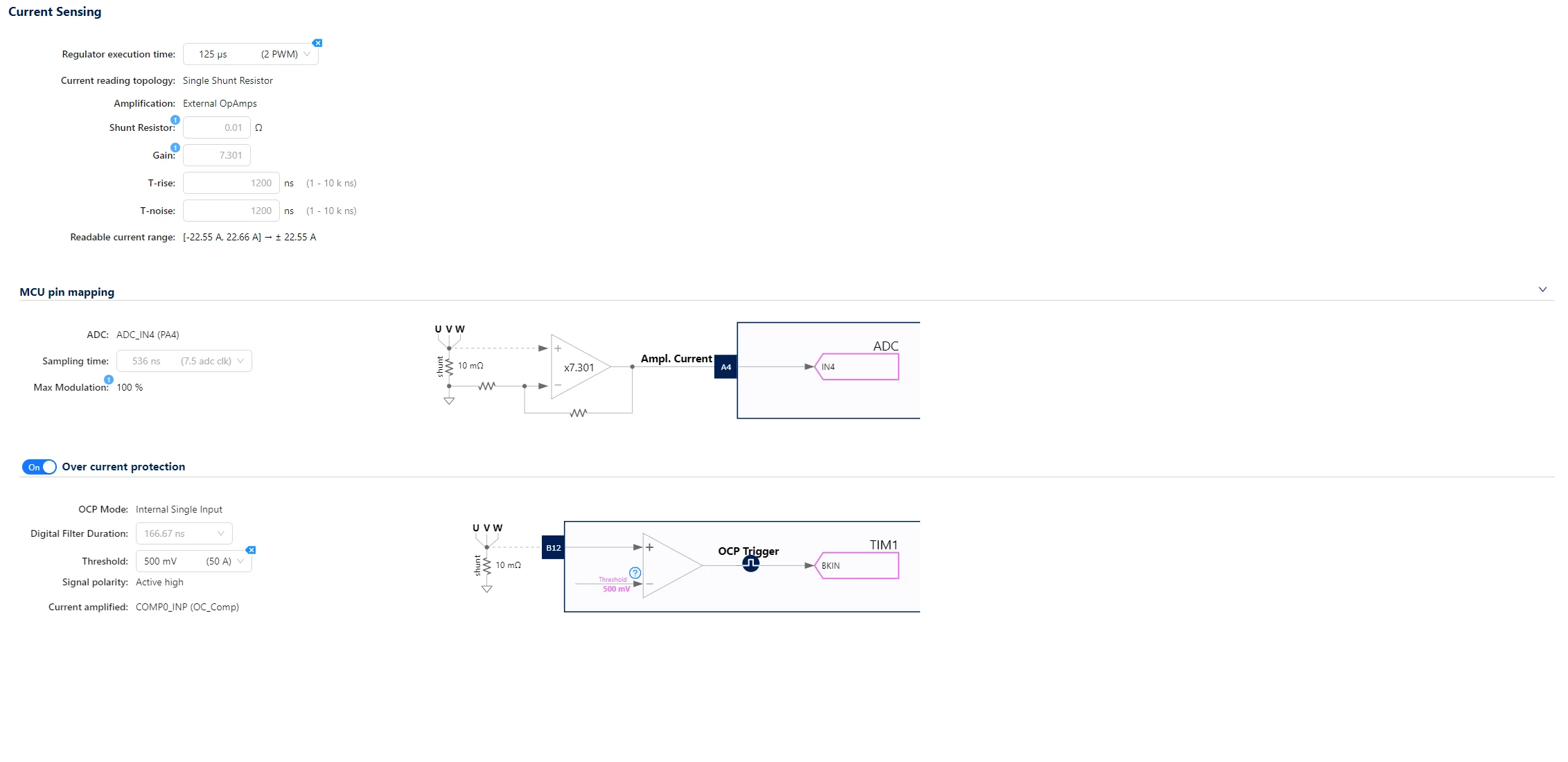

Hi @GMA ,
I have reviewed the user manual you have provided. I did not set the OCP threshold manually, as it is managed by the MC Workbench app, which I have set as in the attached screenshot below. What is weird, is the fact that the user guide you provided mentions different amperage thresholds than the MC WB program at the same mV setting. The OCP trips on every setting possible in the MC Workbench app (10A, 25A, 50A). Furthermore, the lab PSU I am using will output a max of 10A @ 30V (which should definitely not trip the OCP when set at 50A).

You are correct about the user manual table (the question has been sent to the STEVAL-SPIN3202 team, and it has been confirmed that the Workbench values are the correct ones. Documentation will be updated accordingly, thank you for the report).
Use an oscilloscope to measure the OCCOMP input (JP8 2-3) and verify the achieved level.
You can also try to decrease the current target in the start-up profile on the Motor Pilot tool Rev-Up tab.
