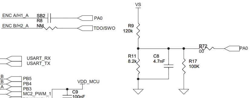

which user AC6 project can be used in combination with STEVAL_IHM042V1?
I would like to use the STEVAL_IHM042V1 to run two motors with hall sensors
Is it: \Web\Project\AC6\STM32F30x_UserProject -> config STM32303C-EVAL_DUALDRIVE?

Hi Gerber,
I tried to generate the MCWB project starting from yours, but looks like the STEVAL-IHM042V1 doesn't support a dual-motor driving where both motors use Hall sensors and 3-shunt sensing.
In fact the Hall3 input of motor 2 is shared with one of the current sensing input:
And Hall1 of motor 1 is shared with voltage sensing.
You should change your target topology if you want to use this board.
In any case, I attach you a WB projecthighlighting all these problems.

Hi Enrico,
Thanks for your feedback.
Workbench Project has been configured (Power Stage -> Current reading topology -> One Shunt Resistor) as 1 shunt resistor sensing for both motors.
Is 1 shunt resistor sensing for both motors supported in combination with Hall sensors?
