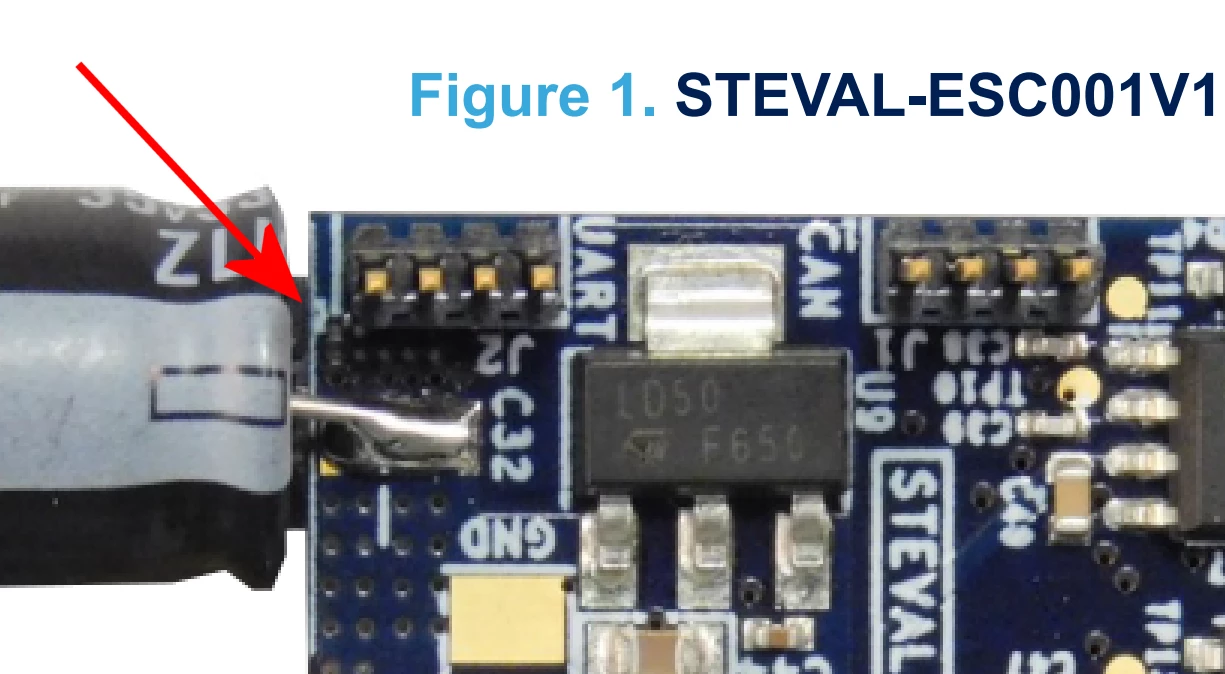

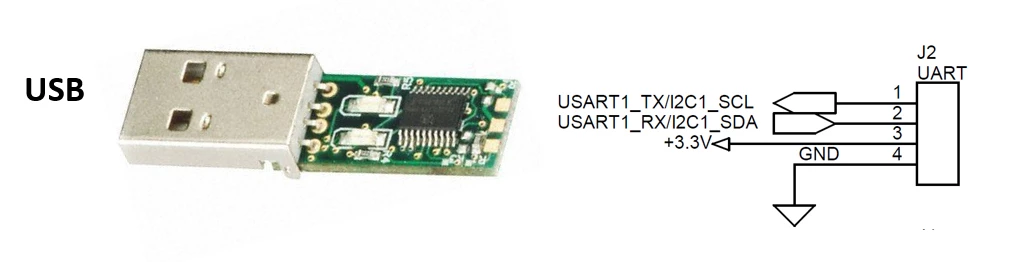

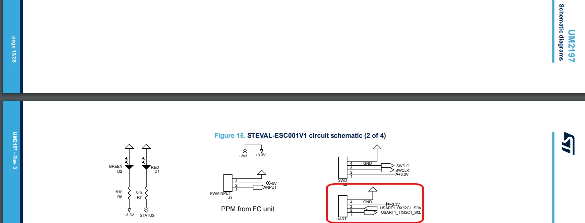

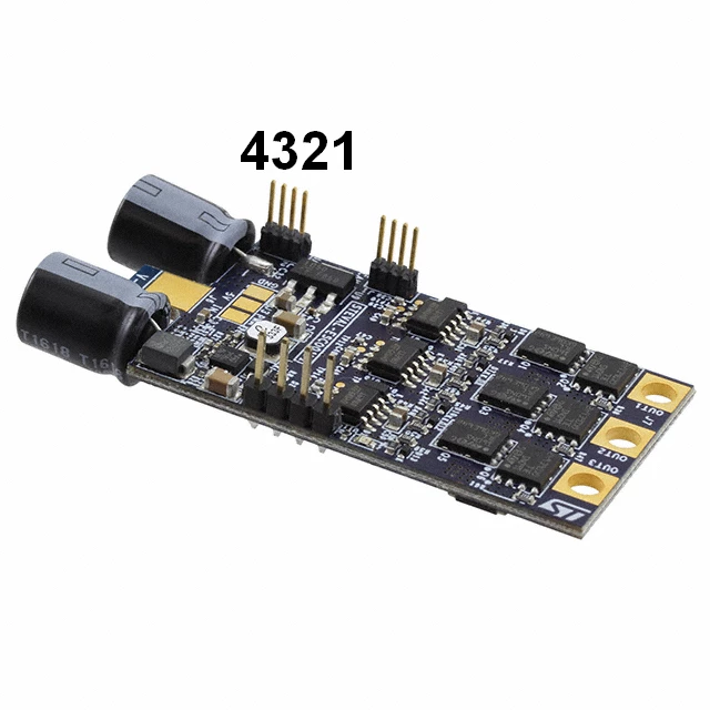

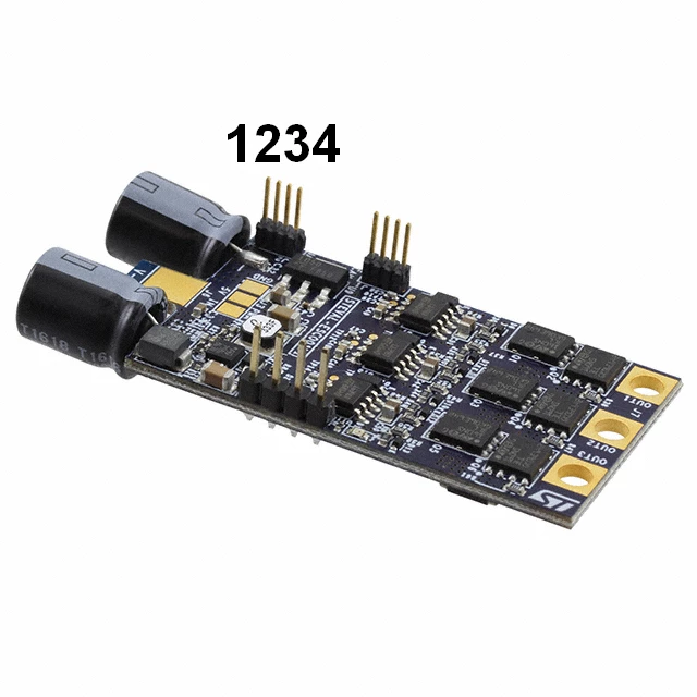

Hello, could someone please advise me what is the correct order of the UART pins on the steval esc001v1.
thank you
Kamil
uart pins 4321uart pins 4321uart pins 1234uart pins 1234from esc manualfrom esc manual

Do you have the board? Is there an ident marked on it?
It looks like there might be  but, in the photo, it's obscured by the capacitor:
Failing that, look at the Gerbers and/or CAD files: see which pin is GND - you can get the rest from that

Thank you for quick answer, however I need to know if the pin no.1 is closest to the capacitor or the oposite one.
