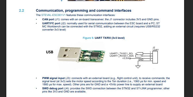

Kindly provide an example code to make my steval esc001v1 to a working ESC for a drone i have configured PA15 as input which accept PWM signal but throttle mapping is not done any help will be appreciated.

Hello ​@Aswin777,
Refer to the “2.2 Communication, programming and command interfaces” chapter of the user manual available here.

Hello ​@Aswin777,
I am referring to the “PWM signal input (J3/PA15)” chapter, which explains how to drive the motor.
