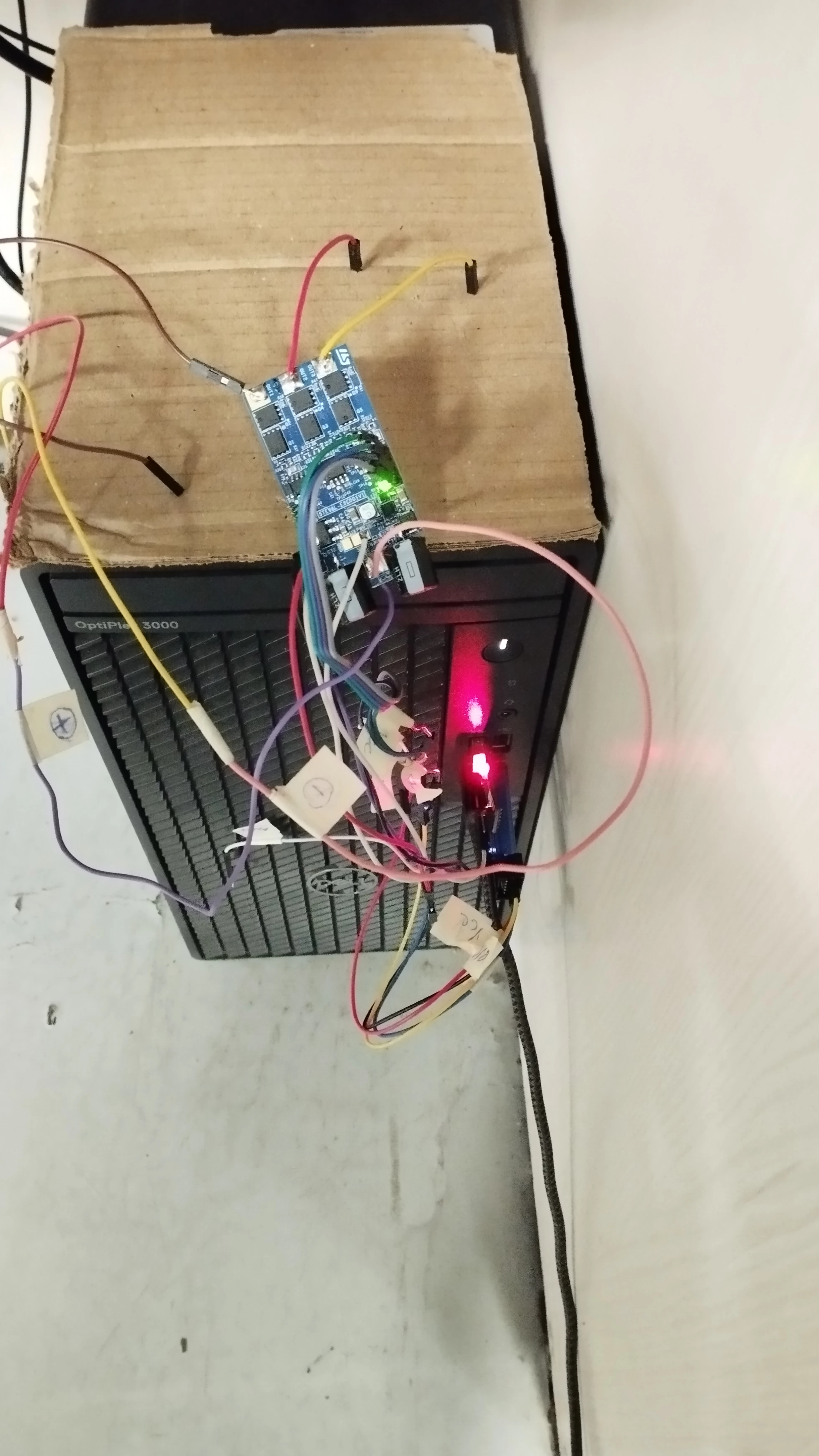

I have tried connecting both STLink and UART but Motor Pilot is not getting connected,
ERROR: No STLink VCP detected
I am using (V1.2.9) and tried using older version but still issue persists. Kindly help.

Gael A
December 17, 2024
Hello again,
Could you please tell me how you connect the board to your computer ? You can send pictures if you want.

tejas_ampAuthor
December 17, 2024
I have connected UART and ST Link connections
Gael A
December 17, 2024
Could you tell me what device you use for connecting the ESC001 to the computer ? Also please focus the picture on the connection between the two.
If you agree with my answer, please consider accepting it by clicking on 'Accept as solution'.
tejas_ampAuthor
December 17, 2024
I used "ST Link V2 Programmer For STM8 and STM32" (https://robu.in/product/st-link-v2-programmer-for-stm8-and-stm32/?gad_source=1&gclid=EAIaIQobChMIyYD6gdquigMV3j1ECB2KfiYtEAQYASABEgLi2vD_BwE) for debugging and usb to uart bridge for uart. Connections are same as specified in manual. Even uart is working fine when i am trying to send data through code and output on putty.
Gael A
December 17, 2024
I think I found the issue, as you are using a non official STLink device, the Discover Board function will not work.
You need to load the GUI you need and then manually connect using the correct COM Port.
