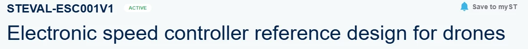

I am not sure i understand the question completely but go through the below post may be useful,
Solved: Profile a motor which is not in the Workbench Moto... - STMicroelectronics Community
and the STEVAL-ESC001V1 | Product - STMicroelectronics what i can see from the website is it is for drones
You have to generate the code using MCSDK6.4.1
