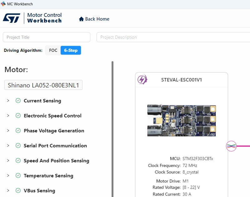

Does STEVAL-ESC001V1 evaluation board support 6 step ?.
it already supports FOC
if so any idea how to implement 6 step in steval esc001v1

Hello ​@Aswin777,
Using MCSDK6.4.2 available here, you can generate a STEVAL-ESC001V1 project selecting 6-Step mode:

Thanks a lot .
earlier when i checked STEVAL was not available in version 6.2 now it has been added.
