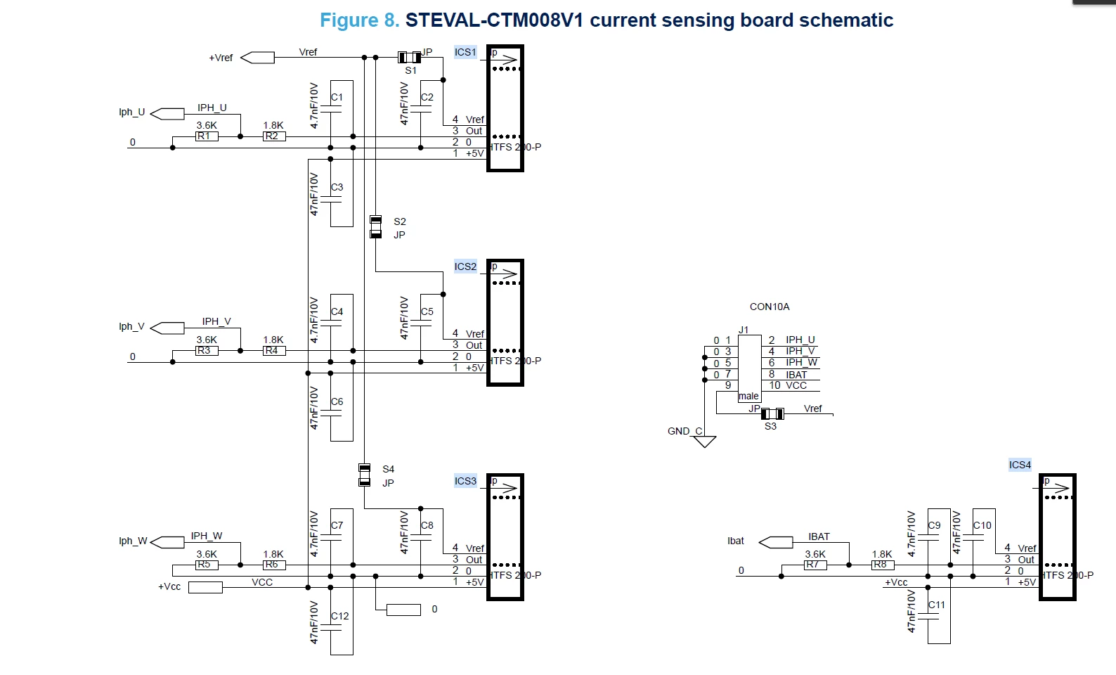

1. STEVAL-CTM008V1 schematic diagram defines that it is possible to use 3 ICS.

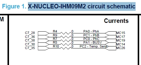

2. X-NUCLEO-IHM09M2 circuit schematic Fig.1 defines that PhC current can be obtained via MC19(PC0)
I've assembled STEVAL-CTM008V1 with 3-rd magnetic current sensor.
Could you please advise how can it be achieved?

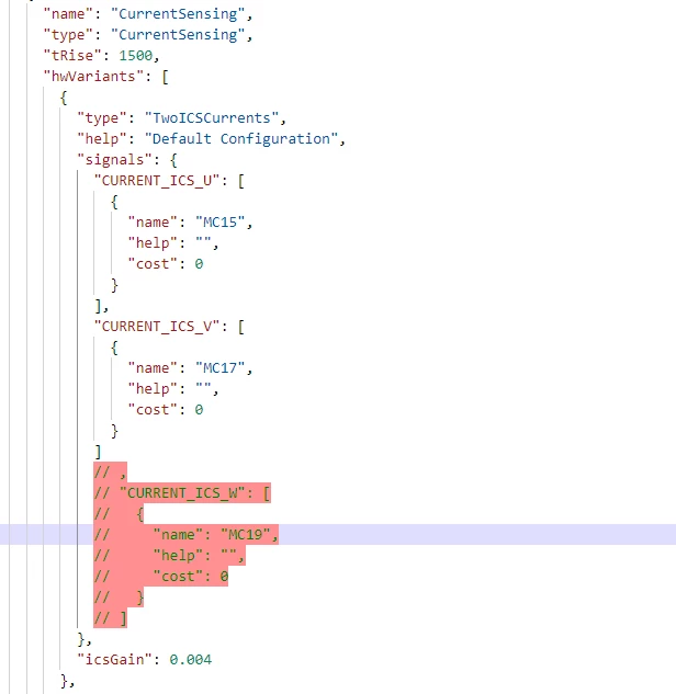

1. Can I configure 3-ICS reading via workbench?
2. If I clone STEVAL board, is it possible to configure the current sensing to read the 3-rd sensor?
3. Should I modify firmware sources, generated by workbench?

Hello tezz,
Currently only the 2-ICS configuration is supported by the MCSDK (latest 6.2.1). Thus, modifying the STEVAL-CTM009 board description won't help you.
You will have to modify the firmware sources to enable 3-ICS configuration for the STEVAL-CTM009.
