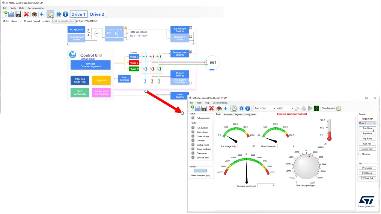

I have the IDE with the STEVAL-CTM01xV1 shunt_FOC and downloaded on the Board. As the example came, the motor doesen't work.
I opened the main.c file and I could see that it does not have any function inside the main while(1) loop. How could I have a working example to start testing the board?

Readme.txt is automatically opened once you select the example, I have attached the file in my previous response.
Selecting the monitor mode, you can select the motors and start/stop buttons.

Did you go through readme.txt document?
As mentioned in the readme.txt, for testing "6. Run the example : through the STM32 MC Workbench monitor GUI (Start Motor), or/and by pressing the Start/Stop button."
This example is for a Selni motor.

Where is the start/stop button on STEVAL-CTM011V1?
