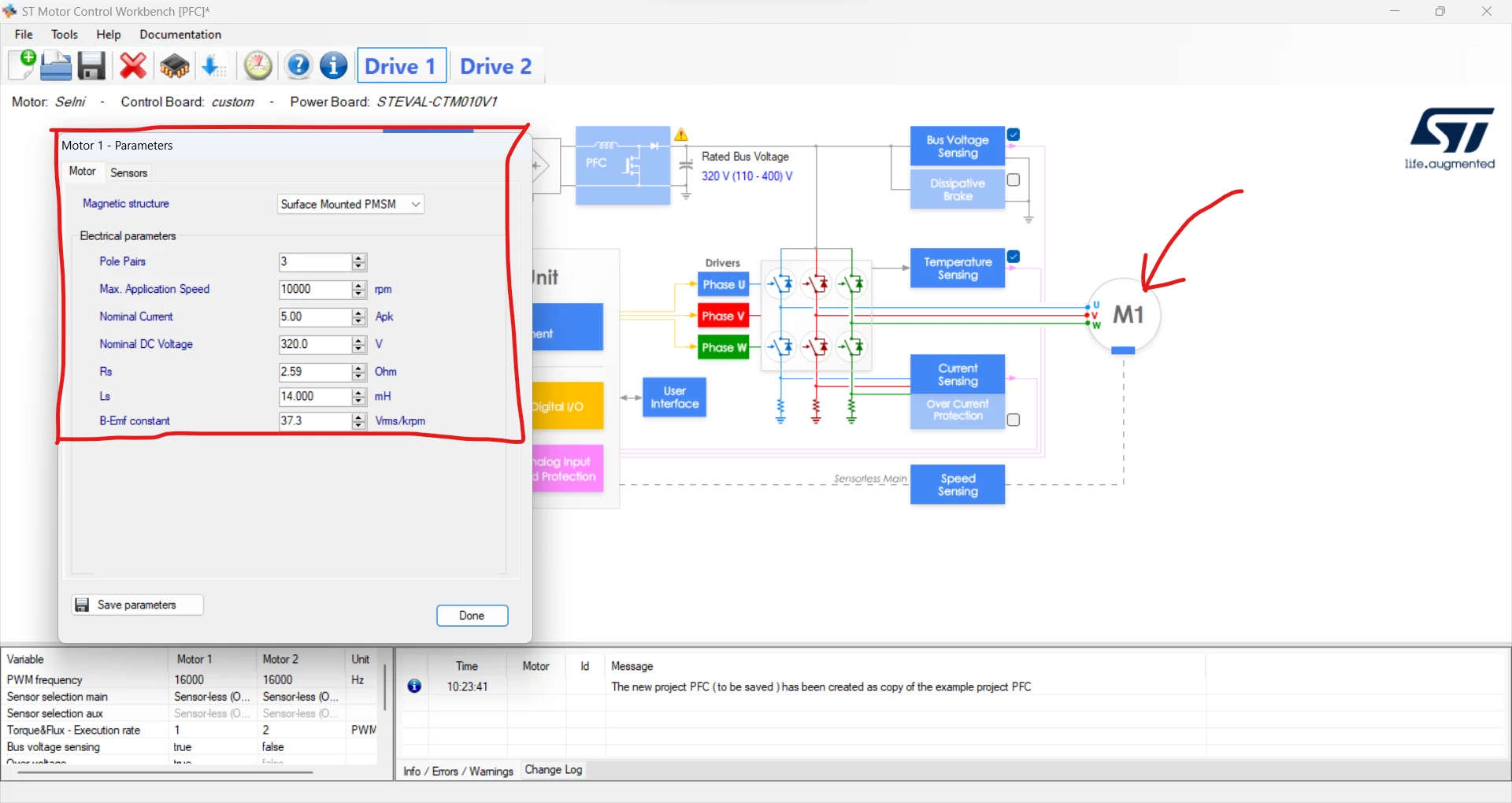

I need to evaluate the ST Motor Control Kit STEVAL-CTM010V1 with ST Motor Profiler GUI Tool v5.4.8.
But my board is not listed in the supported boards list. Can anyone please tell me if there is any way I can use the Motor Profiler tool with my Board.
Although I can easily select the board in the Motor Control Workbench GUI v5.4.8 and it shows the block diagram with all configurations.

    Hello ManishVerma,
    If you want to bypass the Profiler Tool step, I advise you to create a .xml file by taking examples on other referenced motors and then fill in all the needed values. Your motor will then appear in the WB as a referenced motor. This way, anytime you want to create a project using you motor, you won't need to manually enter its characteristics through the WB UI.

    Unfortunately, the STEVAL-CTM010V1 inverter is only supported as an example in MCSDK v5.4.8. It is not supported either in our latest version MCSDK v6.2. However, it will be added in an upcoming release.
    In the meantime, you can still profile your motor using another board, and then go back to your project using STEVAL-CTM010V1 with updated motor parameters.

    1. The data generated after pressing Start Profile button in the Profiler tool (inertia, friction, current etc.) is "No-Load Data" or "With-load/On-Load Data"?
    2. If I click on the Motor Block in the WB tool, I get this list of parameters to be entered:
      Can I enter these parameters manually (and skip the profiler tool part)? I can source these parameters from the Motor Datasheet/specification-sheet.
      Would this be sufficient or still there is something else that only Motor Profiler tool can provide and I can't.
    3. Even if I put in the Motor data manually, without using the profiler tool (as I said in point 2), would that impact my application/code/resulting system?
    Actually I have the STEVAL-CTM010V1 kit with me but looking at the current scenario, I want to make sure whether there is any workaround (related to profiler) or not before I order a new kit to get my work done.
