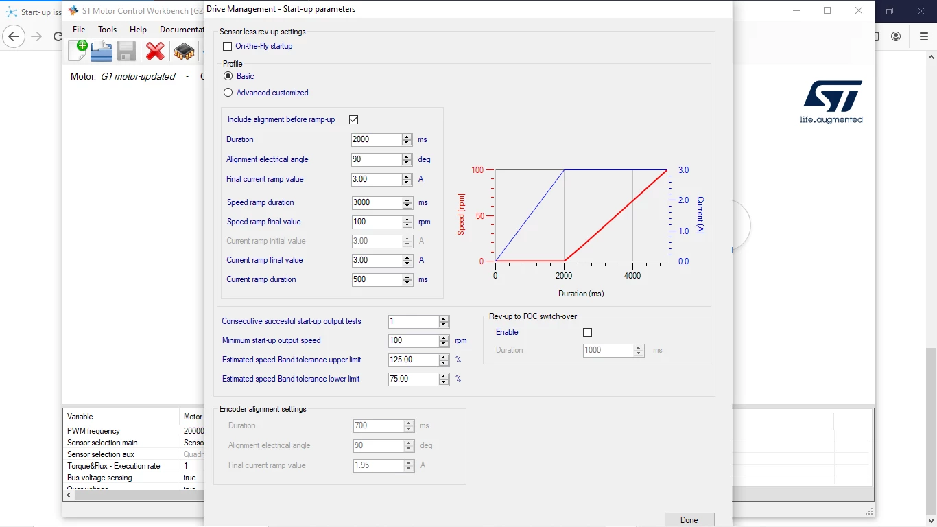

  1. This is a screen shot of the start up settings I am using in MC workbench:

First of all I noticed an issue in your startup parameters. Indeed your minimum start-up output speed is equal to your final speed ramp value (100 rpm), with this settings you can get a STARTUP_FAILURE error .Indeed one of the conditions to close the loop is that your observer measures a speed greater than your "minimum start-up output speed" (i.e. 100RPM). So when you will reach 100rpm the revup controller will detect that it is the end of the startup phase and as the observer has not measured a speed greater than 100rpm it will raise a fault. Then I suggest to decrease your "minimum start-up output speed" to maybe 80 or 90 RPM.
The other issue is that the motor does not spin during startup phase which is necessary to make the observer converge. So if your motor only wobbles that's not good. Could you please try to decrease the current of your startup phase. You can do it by opening "configuration" panel in the monitor and maybe divide by 2 the "final torque" value. Here the current is expressed in S16A unit which is equal to (current_in_ampere*65536*shunt*Amplification_gain)/uC_VDD.
In this panel you have access to the five stages of the startup phase so can try tune them and check that you are able to make the motor spin.
If it still not work then please activate the two DAC channels in debug mode (if not already done) in the panel DAC functionality and select Ia on one channel and Ib on the other. generate the project and copy\paste elsewhere the IOC file that has been generated by the MC workbench. Edit it with a text editor and look for OPEN_LOOP_FOC. Set this value to true and open this IOC file with cubeMX in order to generate the code. Compile and flash the firmware, display in your debugger the handle OpenLoop_ParamsM1. At this point you will be in open loop mode and the firmware will force the PWM duty cycles to inject voltage sinusoids without checking the currents.
Launch the firmware, open the monitor and start the motor. the motor should spin, if not or if it wobbles then try to increase/decrease the voltage by modifying in your debugger the value of the field "OpenLoop_ParamsM1.hVoltage". Take care of the current and temperature (apply a limitation on your DC supply). Observe Ia and Ib on the DAC channels and check that the current signals are clean and aligned with what is measured by your current probes.
Note: the speed that is displayed during startup phase is the speed of the rotating magnetic field imposed by the stator and not the rotor itself. The rotor usually follows it but when it does not follow it the startup phase needs to be tuned.  When the loop is closed then it is the rotor's speed.

I followed through on the steps to reduce the start up current, and edit the final torque values.
Although the motor did not spin, I noticed 2 improvements in operation.
First, the output current is now sinusoidal.
Second, the motor attempts to spin 1 or 2 rotations, before stopping.
The fault in this case is SPEED SENSOR FAULT.
