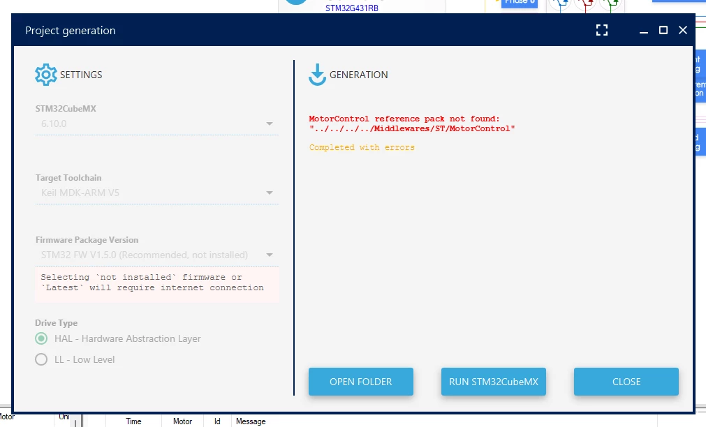

Hi
I wanted to test ST MotorControl Workbench for experimenting with brushless motors, I have installed and tested the MotorControl Workbench 6.2.1 and MotorControl Workbench 5.4.8 on win 11 and both of them would fail to generate the projects out of box with this error message,
I have set them to use keil IDE v5 and my stmcubemx version is 6.10.0
you can check the error log here
Quote
2024-01-28 18:56:58,742 DEBUG [Main.lambda$run$0] Arguments: [-ioc, C:\Users\Ali\Desktop\mc\EvalG0_SingleShunt_IHM023V3_HAL\EvalG0_SingleShunt_IHM023V3_HAL.ioc, -xdm, C:\Users\Ali\Desktop\mc\EvalG0_SingleShunt_IHM023V3_HAL\EvalG0_SingleShunt_IHM023V3_HAL.wb_def]
2024-01-28 18:56:58,745 DEBUG [ArgsValue.readPropertiesFile] [AppConfig] pack.source = "C:\Program Files (x86)\STMicroelectronics\MC_SDK_5.4.8\Middlewares\ST\MotorControl"
2024-01-28 18:56:58,745 DEBUG [ArgsValue.readPropertiesFile] [UserConfig] do not exist in "C:\Users\Ali\.st_motor_control\wb2mx.properties"
2024-01-28 18:56:58,753 DEBUG [ArgsValue.getConfigProperties] pack.source = "../../../../Middlewares/ST/MotorControl"
2024-01-28 18:56:58,758 DEBUG [ArgsValue.lambda$retrieve$2] CLI_ARG[xdm]: C:\Users\Ali\Desktop\mc\EvalG0_SingleShunt_IHM023V3_HAL\EvalG0_SingleShunt_IHM023V3_HAL.wb_def
2024-01-28 18:56:58,758 DEBUG [ArgsValue.lambda$retrieve$2] CLI_ARG[ioc]: C:\Users\Ali\Desktop\mc\EvalG0_SingleShunt_IHM023V3_HAL\EvalG0_SingleShunt_IHM023V3_HAL.ioc
2024-01-28 18:56:58,758 DEBUG [ArgsValue.retrieve] {xdm=C:\Users\Ali\Desktop\mc\EvalG0_SingleShunt_IHM023V3_HAL\EvalG0_SingleShunt_IHM023V3_HAL.wb_def, updftl=templates/wb_ioc_mc-middleware.ftl, mx_timeout=-1, exp=templates/wb-defines_where_and_what.txt, ioc=C:\Users\Ali\Desktop\mc\EvalG0_SingleShunt_IHM023V3_HAL\EvalG0_SingleShunt_IHM023V3_HAL.ioc, pack=../../../../Middlewares/ST/MotorControl, ftl=templates/wb_ioc_template.ftl}
2024-01-28 18:56:58,801 DEBUG [Main.run] Targeted MCU family = G0
2024-01-28 18:56:58,818 DEBUG [Main.run] Minimum associated CubeMx to the `G0` targeted MCU family is `4.28.0-a0`
2024-01-28 18:56:58,829 DEBUG [WindowsCubeMxFinder.lambda$findThem$2] Found 64-bit subkey HKEY_LOCAL_MACHINE\~~~\Uninstall\STM32CubeMX
2024-01-28 18:56:58,834 DEBUG [CubeMxCtx.EXE_version] Loaded path: 'C:\Program Files\STMicroelectronics\STM32Cube\STM32CubeMX\STM32CubeMX.exe'
2024-01-28 18:56:58,834 DEBUG [CubeMxCtx.EXE_version] Loaded updater jar: 'C:\Program Files\STMicroelectronics\STM32Cube\STM32CubeMX\plugins\updater.jar'
2024-01-28 18:56:58,846 DEBUG [CubeMxCtx.EXE_version] Loaded path: 'C:\Program Files\STMicroelectronics\STM32Cube\STM32CubeMX\STM32CubeMX.exe'
2024-01-28 18:56:58,846 DEBUG [CubeMxCtx.EXE_version] Loaded updater jar: 'C:\Program Files\STMicroelectronics\STM32Cube\STM32CubeMX\plugins\updater.jar'
2024-01-28 18:56:58,855 DEBUG [CubeMxCtx.EXE_version] Loaded path: 'C:\Program Files\STMicroelectronics\STM32Cube\STM32CubeMX\STM32CubeMX.exe'
2024-01-28 18:56:58,855 DEBUG [CubeMxCtx.EXE_version] Loaded updater jar: 'C:\Program Files\STMicroelectronics\STM32Cube\STM32CubeMX\plugins\updater.jar'
2024-01-28 18:57:17,327 DEBUG [CubeMxCtx.EXE_version] Loaded path: 'C:\Program Files\STMicroelectronics\STM32Cube\STM32CubeMX\STM32CubeMX.exe'
2024-01-28 18:57:17,328 DEBUG [CubeMxCtx.EXE_version] Loaded updater jar: 'C:\Program Files\STMicroelectronics\STM32Cube\STM32CubeMX\plugins\updater.jar'
2024-01-28 18:57:17,356 DEBUG [EnvironmentChecker.checkPack] STM32CubeMX.Version: 6.10.0-RC9
2024-01-28 18:57:20,083 ERROR [LineInfo_to_exitCode.manage_MCPackNotFound] MotorControl reference pack not found: "../../../../Middlewares/ST/MotorControl"
What's the problem? do you have any Idea what's wrong?

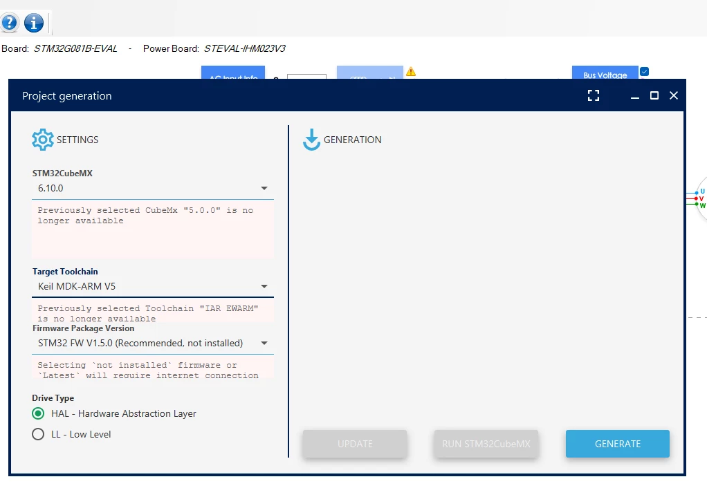

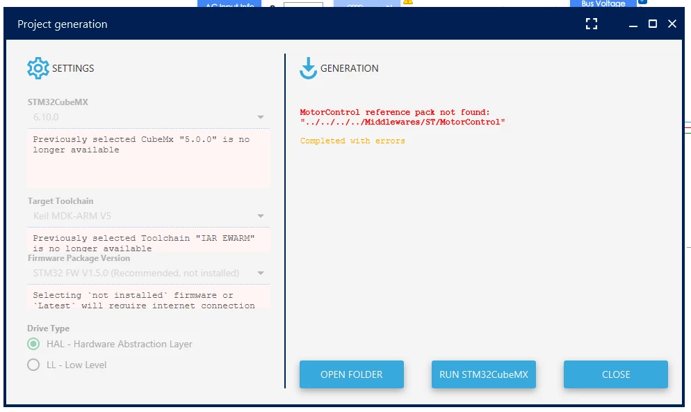

Here the steps that I have done,

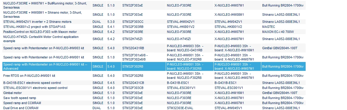

1- I opened the "MotorControl Workbench 5.4.8" and selected some random example project, in this case speed ramp with Potentiometer on P-NUCLEO-IHM001 kit-- Advanced
2- I hit save as project and saved that in an empty folder named motorControl in win11 desktop
3- from the tools menu I clicked the generate button
4- in the opened dialog, I choose target tool chain to be keil v5 and I hit Update,
5- I would get this nasty error
Please check the attached pictures,

cedric H
January 31, 2024
Hello @ali_dehbidi,
Could you check whether you have a wb2mx.properties file in your .st_motor_control folder located in your home directory ?
If it is the case, please remove it (or comment all the content)
Last remark, I highly encourage you to switch to MCSDK 6.2.1. The potentiometer example is now a built-in feature, no need to start from a custom example.

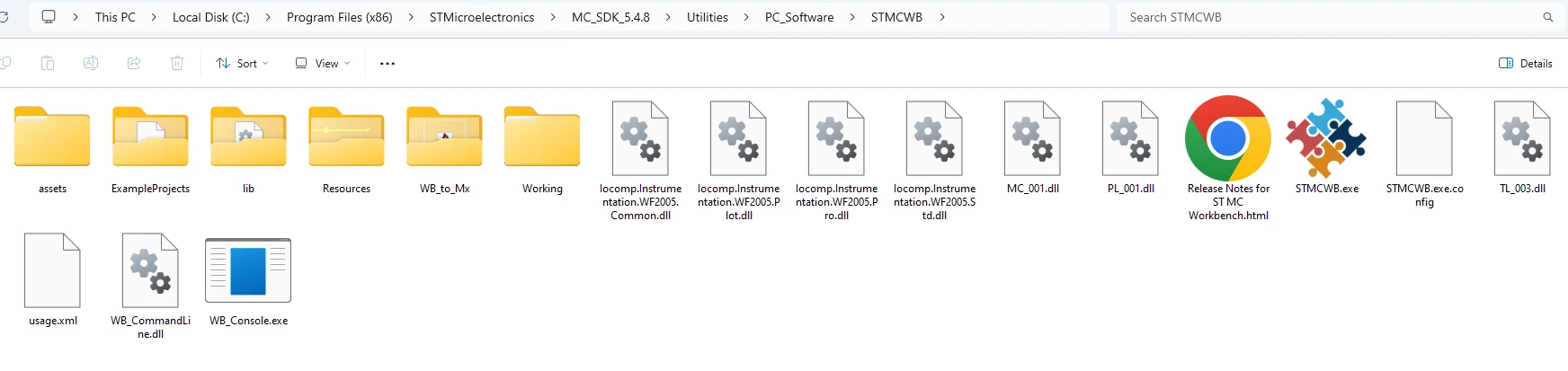

you can see all the files that are in the .exe file of MotorControl Workbench 5.4.8

There is no wb2mx.properties file, so the problem with V 5.4 remains, also v5.4 gives a lot more MCU selection, are you sure the new version would support 380 MCUs?
I have installed MCSDK v6.2 and could generate a test project successfully, But the problem with v6.2 is that It has very limited MCU selection, I can mainly see STM32G431, STM32F303 versions, I'm interested in STM32G030K6T6 or STM32F030K6T6 MCU, also I'm interested to be able to select custom board drivers And motors, it seems there is not an easy way of changing the MCU or Power stage to a custom board and selecting a custom motor, How could I do that? is there any tutorial on that?

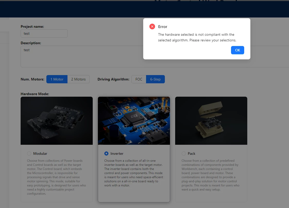

Thanks for the feedback, Now I have tried to modify a cloned JSON file for the STM32G030K6Tx part as an inverter, But the tools does not allow me to generate projects, it would says hardware is not compatible with the algorithm, please check my attached JSON file,
I hope you could find the bug.
ali_dehbidi
February 19, 2024
Hi Cedric
Would you please check my modified JSON file and help me solve the problem? I do not know why I can not make any project with that.
Thanks
February 19, 2024
The board you have chosen(based on  NUCLEO-G071RB)is not compatible with 6-Step algorithm ,meaning that the proper hardware for driving motor in 6-step algorithm doesn't exist on the board(Hall sensors or BEMF feedbacks)
Choosing FOC as your algorithm would probably solve the issue.
Regards.
