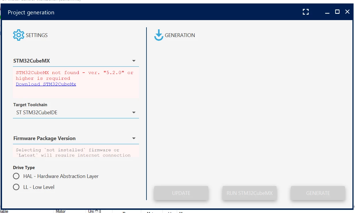

Hi everyone,I have problem about ST Motor Control Workbench.I can ' t generate project.I tried so many things(I installed and unistalled different versions , I changed OS language etc.) but I couldn't do it .Please help.stPic.PNG

Hello @ilker07
could you tell us which version of MCSDK and also STM32Cubemx you have already installed on your PC ?
Thanks in advance

December 19, 2024
@ilker07 ,
it seems that the STMC Workbench does not detect correctly the latest version of CubeMx installed.
Can we try to uninstall the Cubemx and reinstall it, and try again please (keeping MCSDKalready installed)?

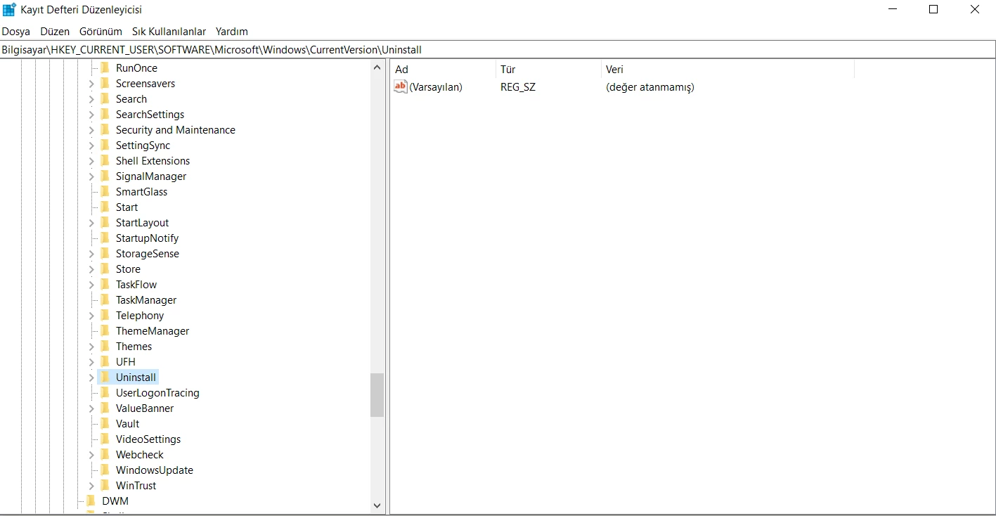

- can you check if when editing windows "register editor" in the following path Computer\HKEY_CURRENT_USER\Software\Microsoft\Windows\CurrentVersion\Uninstall you have the Key for your installation of Cube Mx ()
Regards
If you agree with my answer, please accept it by clicking on 'Accept as solution'.
ilker07Author
December 19, 2024

@ilker07 ,
your register key status explains that the MC Workbench cannot detect whether a CubeMx version is installed or not.

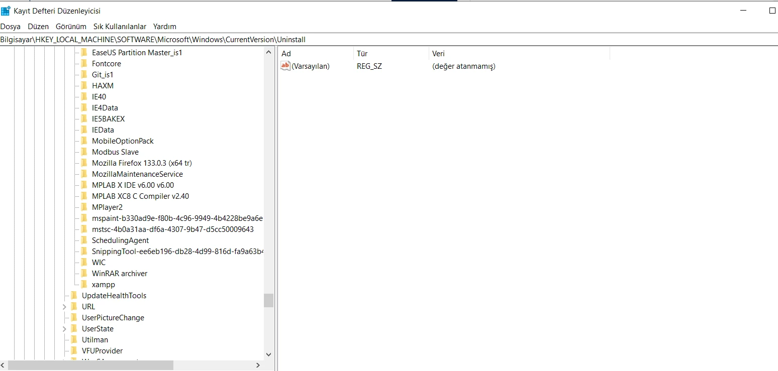

Can you check also this key in the following path :  Computer\HKEY_LOCAL_MACHINE\SOFTWARE\Microsoft\Windows\CurrentVersion\Uninstall\STM32CubeMX
ilker07Author
December 19, 2024
there is no folder named STM32CubeMX after  Uninstall.
December 19, 2024
@ilker07 ,
ok all this explain your problematic because the detection of CubeMx version through MC WB GUI is based on those windows keys, and the only way to solve it is to again, sorry but we need to do so again, is to
- uninstall and reinstall STM32CubeMx v6.2.0 or you can use also 6.4.0 which is compatible with MCSDK 5.4.8

Did you mean HKEY_LOCAL_MACHINE\SOFTWARE\Microsoft\Windows\CurrentVersion\Uninstall\STM32CubeMX?
December 20, 2024
@ilker07 ,
yes please if you can check this key.
Regards
ilker07Author
December 20, 2024
