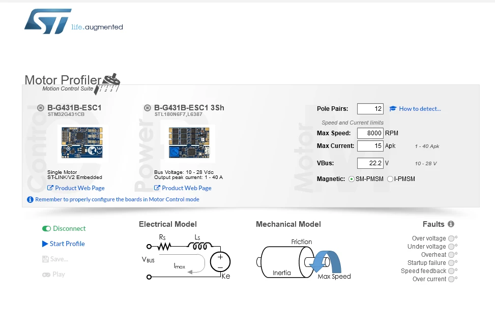

the version is 1.3.2 - 18 Dec 2020 (build : 20190628)
The version specified at the name of the application is 5.4.8

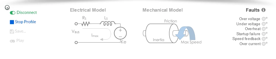

After clicking the start profile button, this is what happens
_legacyfs_online_stmicro_images_0693W00000bjBX4QAM.pngafter some time, Profile failed notification appears at the upper right of the window and that's it.

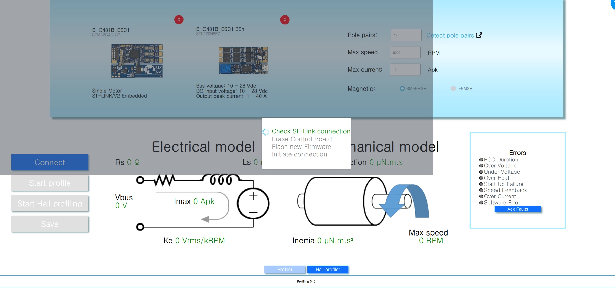

Hi, stuck again.
I downloaded the latest version, and clicked "connect" in a ST Motor pilot V1.1.5
then I clicked "accept" in the "Warning: motor profiler image required" notification
the problem is it is stuck in this stage (about 1 hour)
I am connecting to B-G431B-ESC1 via USB cable.
any advice would be helpful

JKong.3
JKong.3Author
May 2, 2023
It works. thank you
