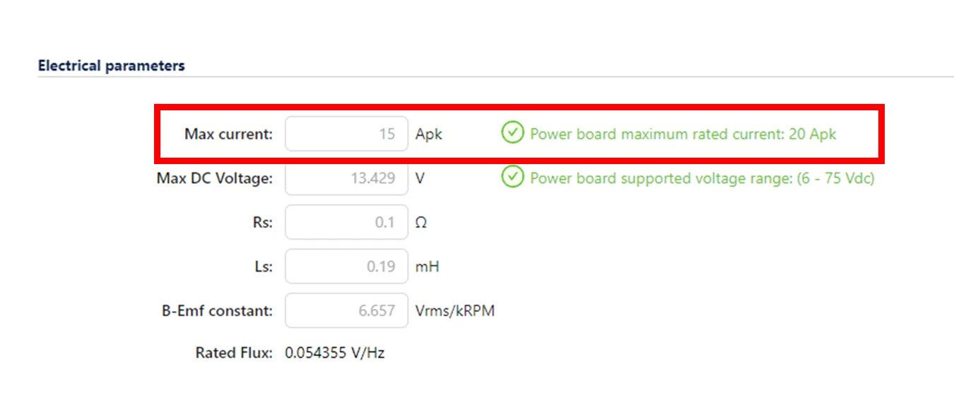

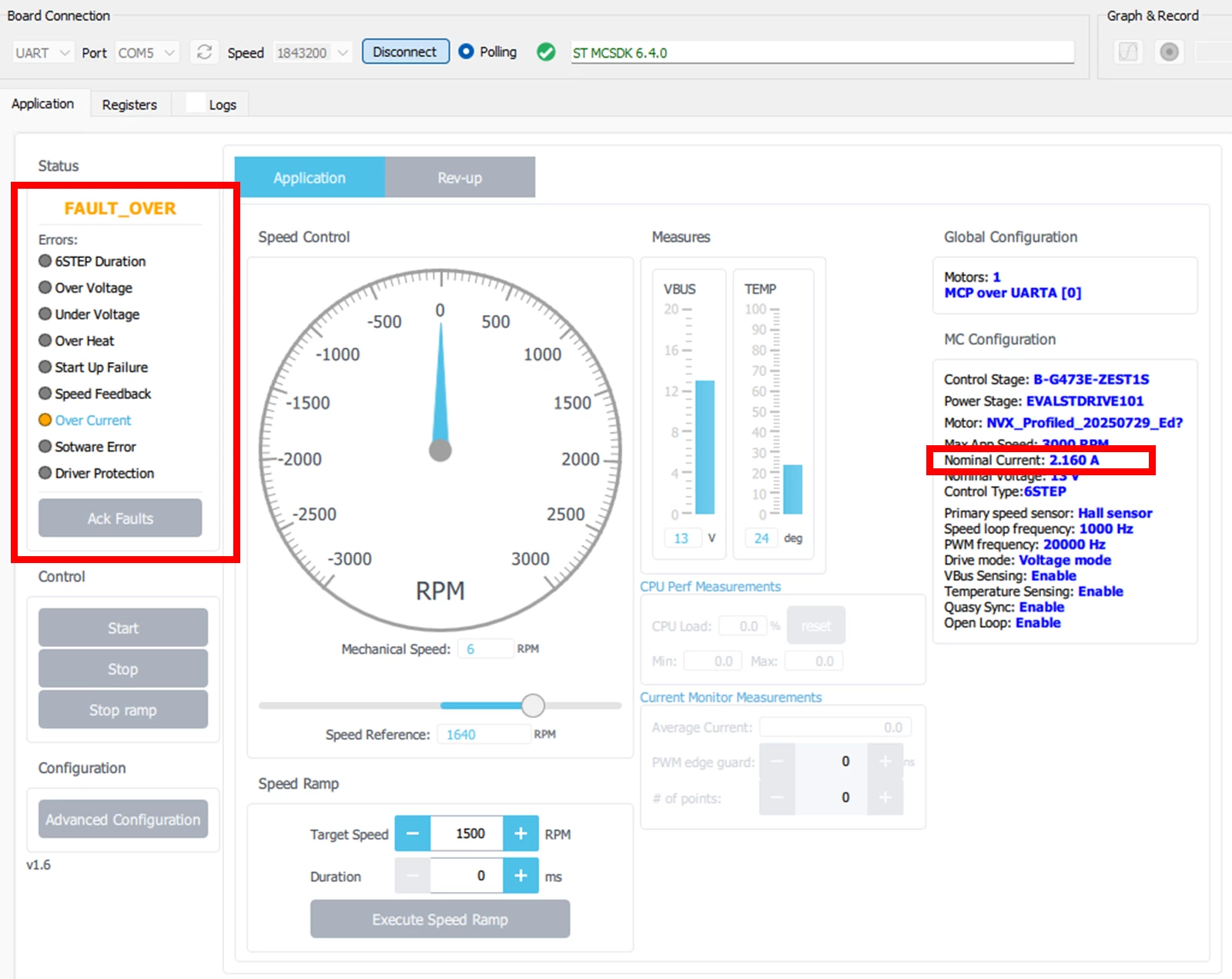

I am facing an Overcurrent issue while using Motor Pilot V6.4 in 6-Step + Hall Sensor mode. In MC Workbench, the current limit is set to 15A but the Nominal Current is shown as 2.16A in the Motor Pilot GUI. No matter what I do in MC Workbench, the Nominal Current doesn't change and always shows as 2.16A. Consequently, I can't start the motor as it there is always Over Current fault as the motor needs more than 2.16 to start.
I know that it's not a limitation of my Power Board as it is rated at 20A.
In MC Workbench, it's clearly stated 15 Apk is set and is within specification of Power Board.

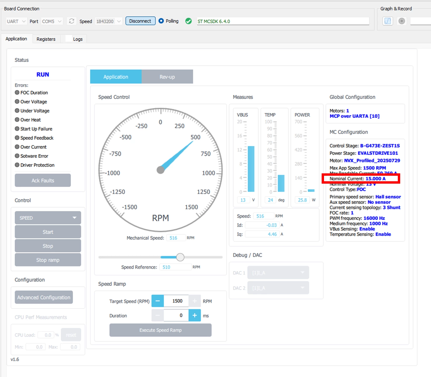

The strange this is, when I try FOC + Hall Sensor mode, this doesn't happen and the Motor Pilot GUI is showing the correct Nominal Current limit (15A) below. Somehow, this issue only happens in 6-Step + Hall Sensor mode.
May I know why this Nominal Current setting is different between FOC and 6-Step GUI?

Hi fmariz, I suggest you first to check this post:
hall-sensor-not-working-on-6-4
From my point of view, the problem you raised is only a display issue.
The firmware does not retrieve the current information from the MCSDK Workbench, and it is not displayed on the Motor Pilot (the default value of 2.16 A is shown).

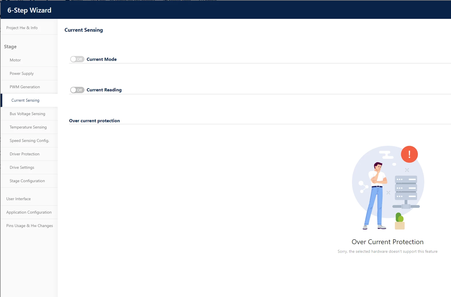

I have limited my power supply to just 5A peak and there's no Over Current option is unsupported anyway with my setup: 6-Step + Hall.

@Fabrice LOUBEYRE I've found out that the fault is actually from the Driver Protection fault from STDRIVE101's nFault pin, and not Over Current fault as indicated. I've confirmed this by manually shorting the nFault Test Point to GND.
There's a bug with the Motor Pilot software.
Fabrice LOUBEYRE
August 28, 2025
Hi @fmariz, thank you for your feedback. As described in the UM2781 - Getting started with the EVALSTDRIVE101 document:
https://www.st.com/resource/en/user_manual/um2781-getting-started-with-the-evalstdrive101-stmicroelectronics.pdf
In chapter 5.5 Fault monitoring, the protection nFAULT of the STDRIVE101 is triggered for overcurrent, VDS monitoring, UVLO, or overtemperature. In the current implementation of the 6-step firmware, the driver protection error is identified as an overcurrent error. However, you are correct; it should be mapped to the driver protection error, as is done for the FOC algorithm, for example. The issue is not located in the Motor Pilot but in the MCSDK firmware.
