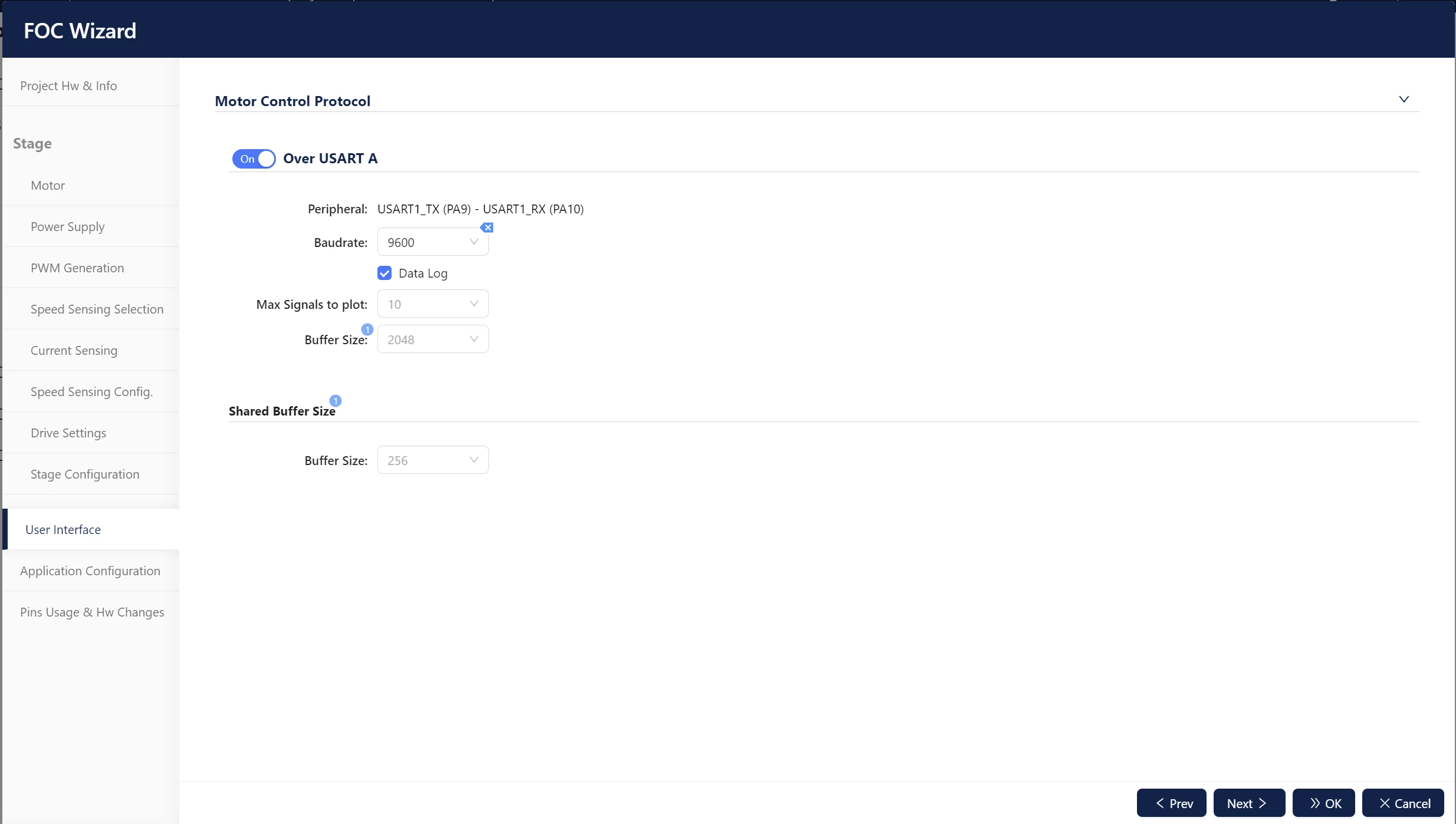

What are your "User Interface">"Motor Control Protocol" settings (as on previous snapshot)?

Here you go. I know the baud rate is pretty low, I've tested the default as well as 115200 though. Let me know if theres anything wrong here. Thanks!

Hello @dfshea,
Then an associated USART interrupt should be defined on stm32_mc_common_it.c (for latest MCSDK version).
