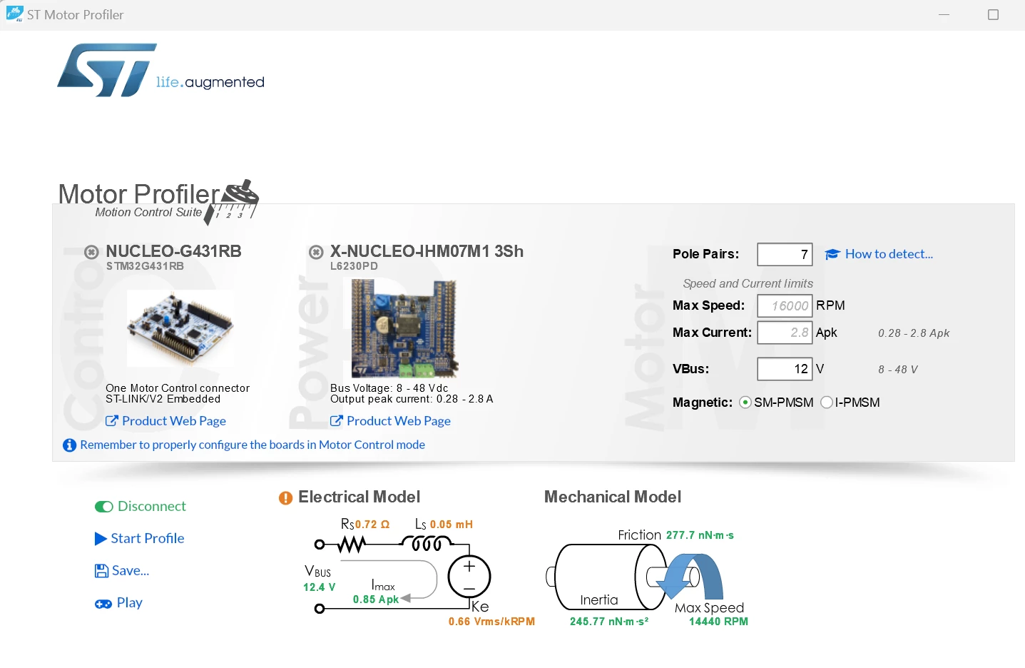

Same with B-G431B-ESC1 3Sh. Profiler 1.1.5 does not connect, however, Motor Pilot works fine.

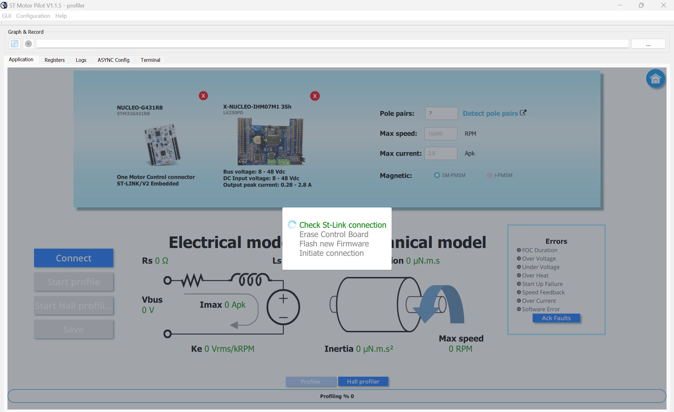

HI, I Try the same with Nucleo-G431RB & IHM07M1 with Motor Pilot 1.1.5 and do not work.
But if you use the older Motor pilot ( SDK 6.0.0 ) it will work.
0693W00000aIhfbQAC.png0693W00000aIhfvQAC.png0693W00000aIhgAQAS.pngI think that Motor Control SDK Team will fix it in the next Release only.

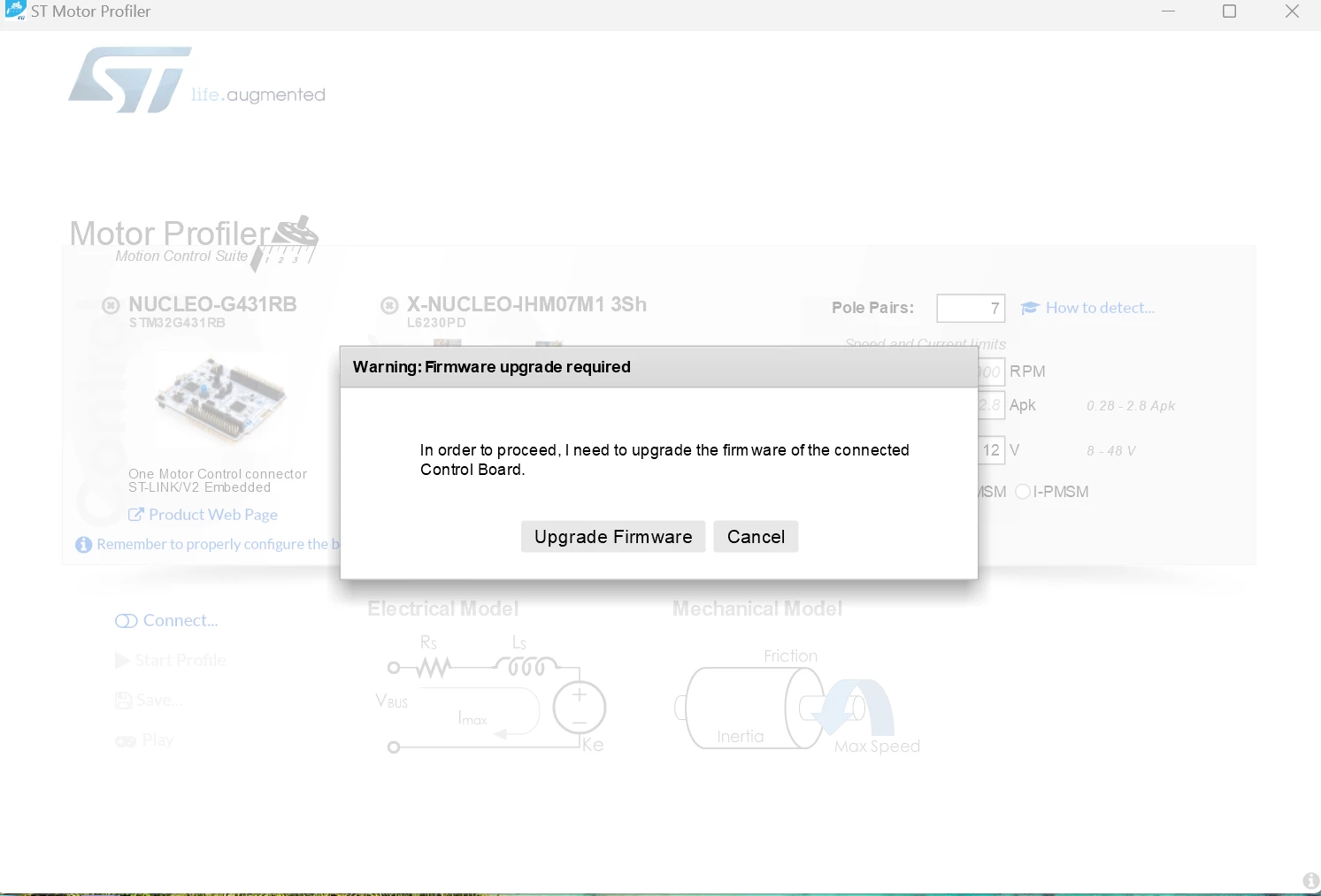

It seems that the motor profiler in some way communicate with the ST Link, because when i Start the STM32CubeProgrammer and connect to the ST-LINK, and thereafter start the ST Motor Pilot V1.1.5 profiler, I am getting the error message:
"No ST-Link Ready to use! Please check if ST-Link is not already used by other applications".

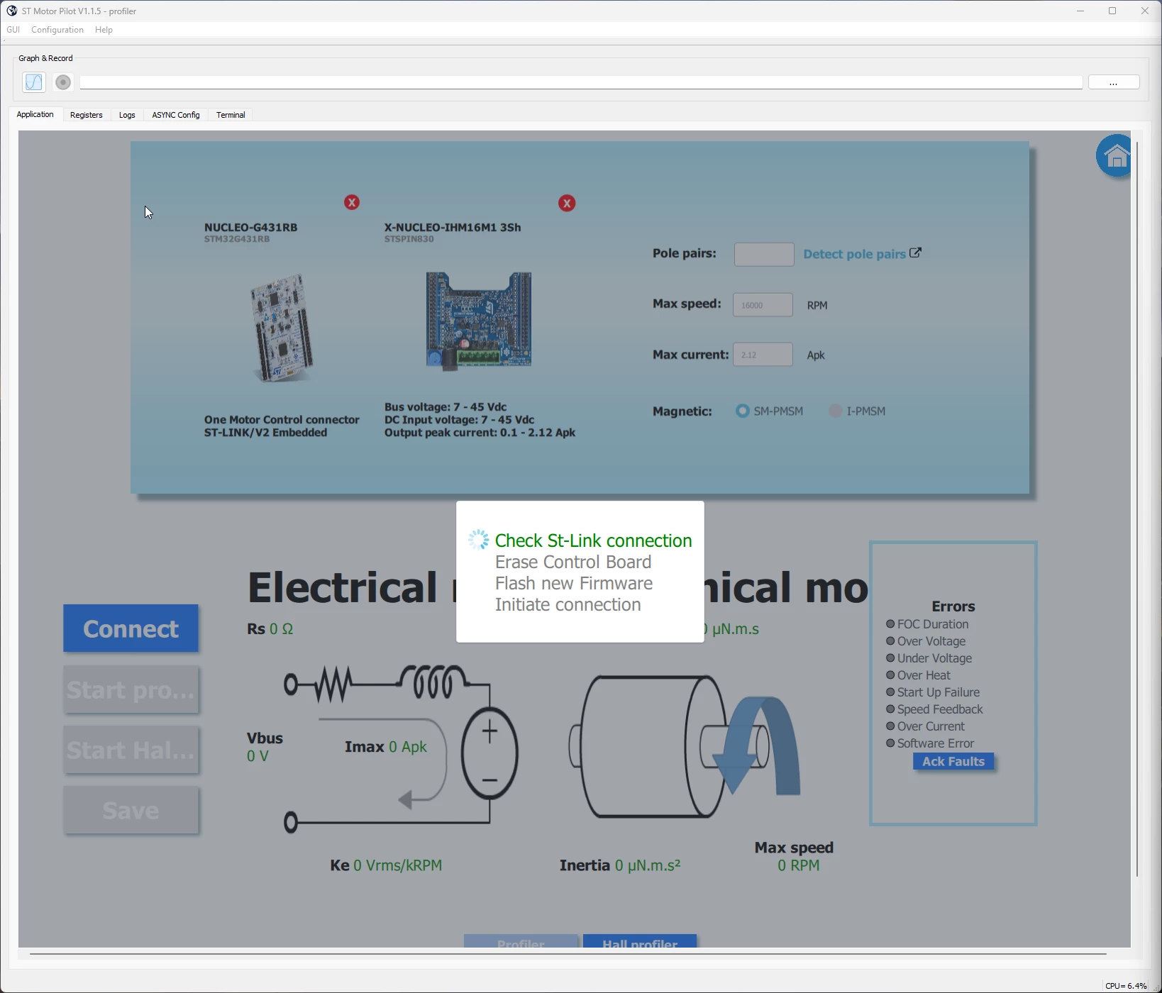

This is a correct message, because when I disconnect the ST-LINK form the STM32CubeProgrammer I am able to to connect but with a warning: Motor Profiler image required", when I then Accept to overwrite the current firmware, it just hangs (forever) on the message "Check St-Link connection"
