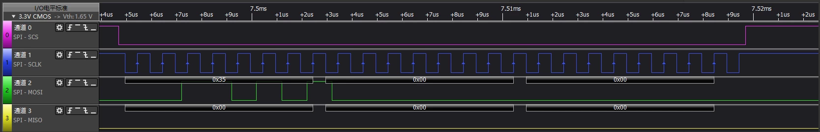

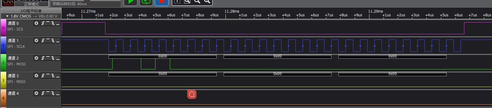

Hello, I encountered some issues while using SPI to control L6482:
1. My read/write SPI logic seems to have failed, unable to read/write normally. Is this a problem with my SPI timing?
This is the timing sequence for me to retrieve the status register.
This is the timing sequence for me to read the 0x15 register.
But their SDO pin has always been at a low level.
