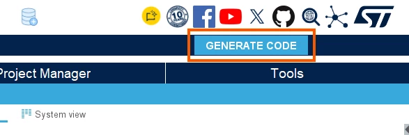

Hello ​@prathmeshpatil06,
After the STM32CubeMX SPI/UART modifications, use the STM32CubeMX tool to generate the project.
If motor control parameters must be changed, first load the modified .ioc file into MC Workbench.
