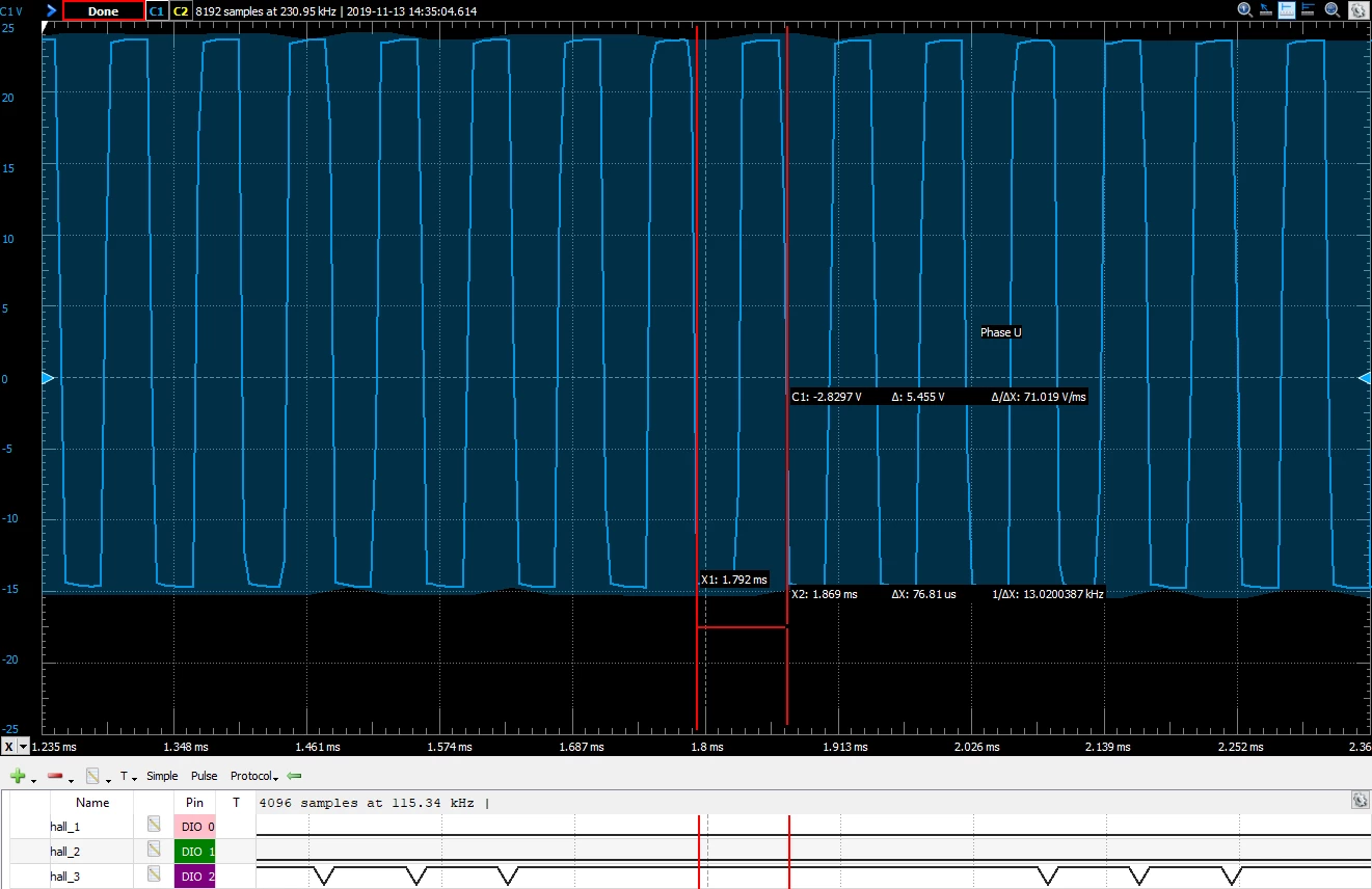

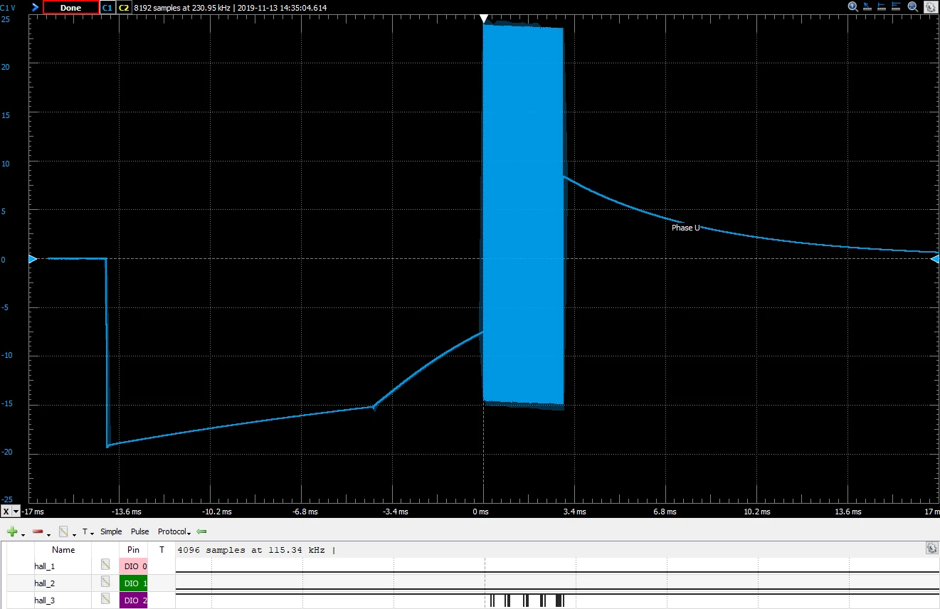

I have made a SM-PMSM project for a hub motor (10 pole pairs). I can compile the generated code in STM32CubeIDE (HAL) but when I run it I always get the fault "Speed feedback" in Motor Control Workbench Monitor.
There is 20ms of activity, where there is 3ms of 13kHz PWM wave from about zero to nominal voltage (p-p) at 50% duty, then "Speed feedback" fault occurs. The waveforms are identical on all phases. The motor does not move, therefore no encoder pulses.
It is strange that the pulse are the same on all three phase outputs, basically stalling the motor.
What is going on here?

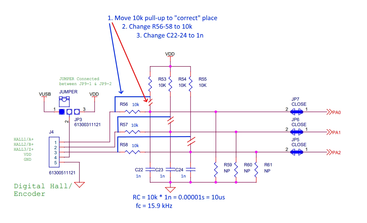

But the actual problem is noise. BLDC phase control results in very large noise transients due to the pulsed control by nature. Now when the HALL sensors are inside the motor (and wires go along the phase cables), they pick up the control noise. I debugged this with low-latency printouts at HALL timer interrupt which captures the HALL pulses and determines speed and direction. When I spinned the wheel, the printout shows perfectly corrent rotational speeds. But immediately when I clicked "Start motor", the interrupt logger goes crazy, displaying non-possible hall sensor states. I could track this down with oscilloscope and the HALL sensor information is just terrible!
Now when you look at the HALL sensor input (for example your STEVAL-SPIN3201) schematic, there's 1k + 10pF as input filter. This filters nothing. And the pull-up resistor is on the "wrong side" of the resistor in the RC circuit; increasing the R creates a voltage divider and eventually HALL sensor activation will not be detected by MCU logic state.
I modified my HALL input as in attached picture. It is taken from STEVAL-SPIN3201 schematic, but the interface is more or less the same in all ST motor control boards (mine is from X-NUCLEO-IHM08M1). The filter is 10k + 1n, resulting in 15kHz cutoff frequency. Rise time is around 10us, which is quite fast enough for this kind of big motor. My motor could have theoretical maximum speed of 1000 RPM, which would result in getting HALL pulses at a rate of 1ms. So no problem in time delay due to increased filtering.
And what is best, now my motor starts and stops when I want =)

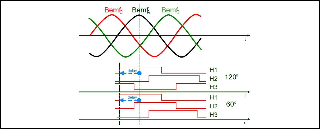

Few things are required in order to be able to use Hall sensors.

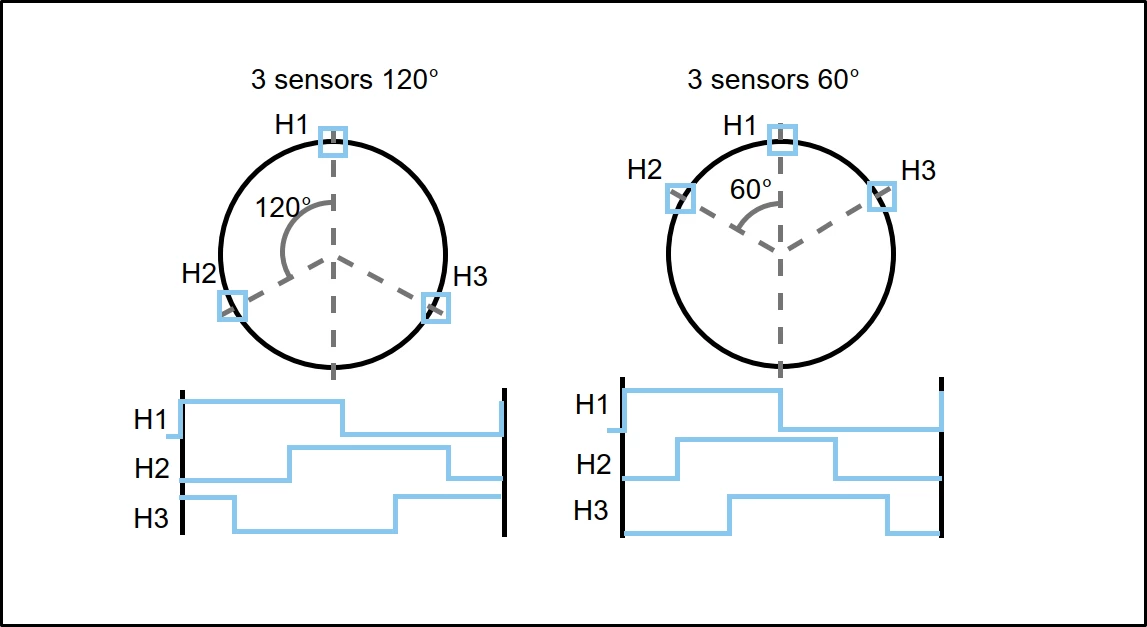

  • be sure that the angle of your hall sensors matches your configuration (120 or 60 deg)
  • You should know the "Placement electrical angle" value (difference between the electrical angle and the Hall sensor angle)
  • In Hall sensor mode, the order of the phases does matter, you can NOT switch U,V, W
  • Be sure that you did not swap the hall sensor connector.
Regards
Cedric

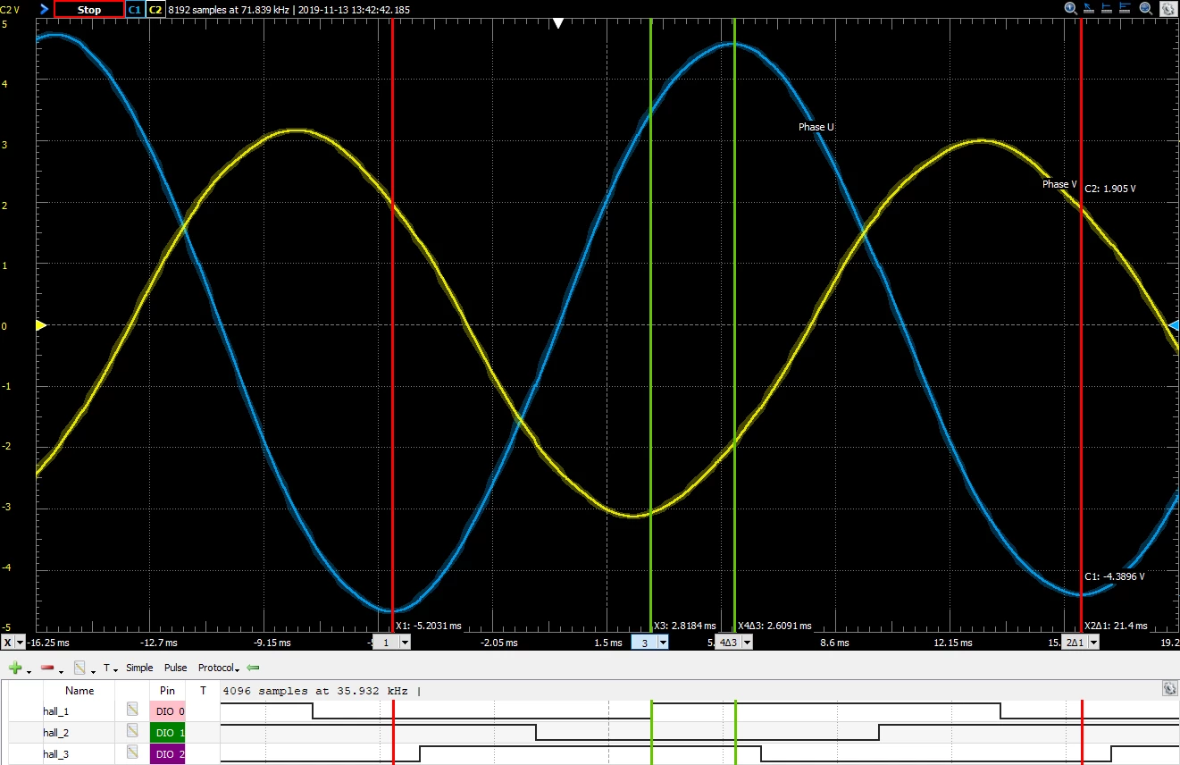

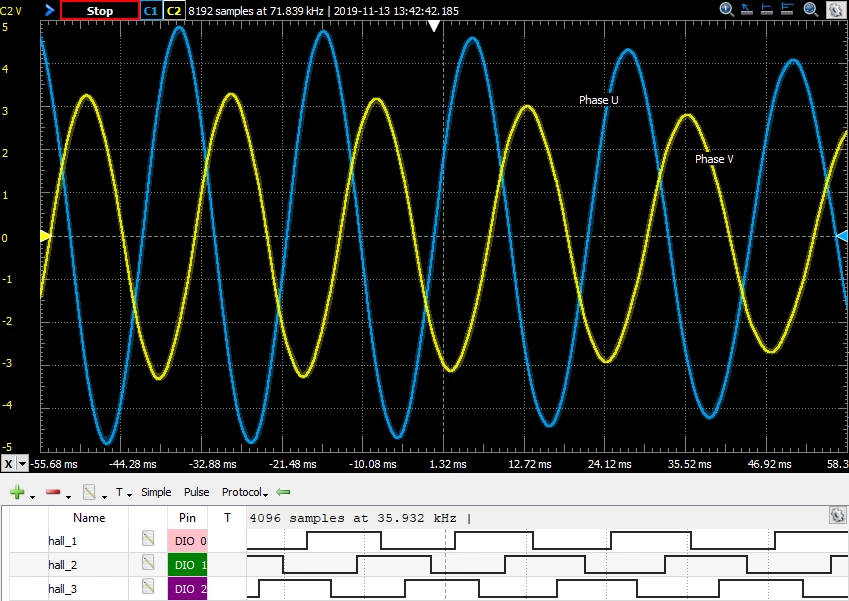

Hi Cedric,
Thanks for your reply.

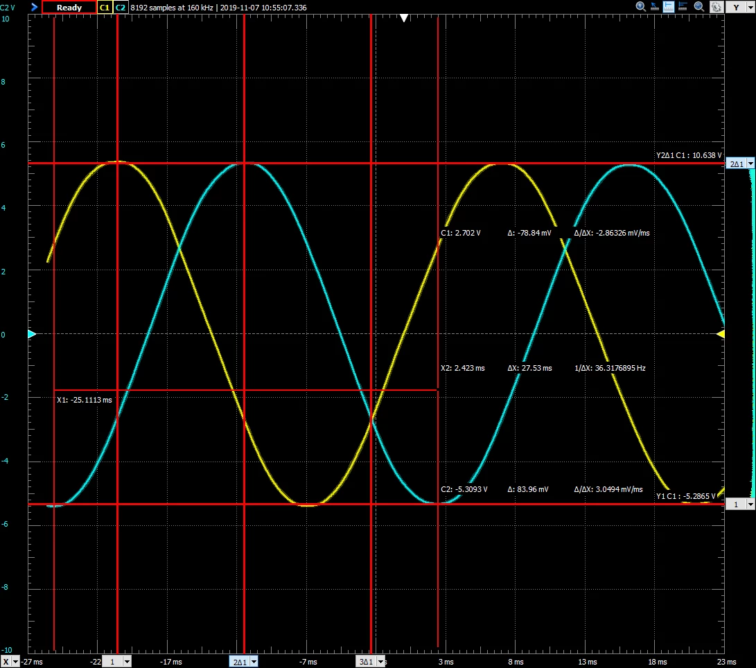

  • I have opened up the motor and measured the physical angle of the hall sensors, and they are 60 degrees appart from each other.
  • I have probed U and V with CH1 and CH2 and hall sensors digital signals (see image)... The setup is, all motor wires connected to the hardware and power on (idle).
The screenshot shows the correct U-V-W forward sequence and a hall sequence for a 120 degree arrangement (??) according to UM1052 fig 85 (see image). Why is it not 60 degrees like I physically measured?0690X00000ArxpOQAR.png
  • Now for the "placement electrical angle", when zoomed in on the capture, it shows the delay from hall_1 rising edge to the peak of phase-U as 2.61ms. The motor phase has a period of 21.40ms. How do I get the "placement electrical angle" from this? Is it simply 360/period*delay=43.9 deg? Does having 10 pole pairs effect the answer?
If I use 120deg, 43.9deg with the current setup, then I still get the following response before the fault "speed feedback" (see image)...
Thanks
Angus

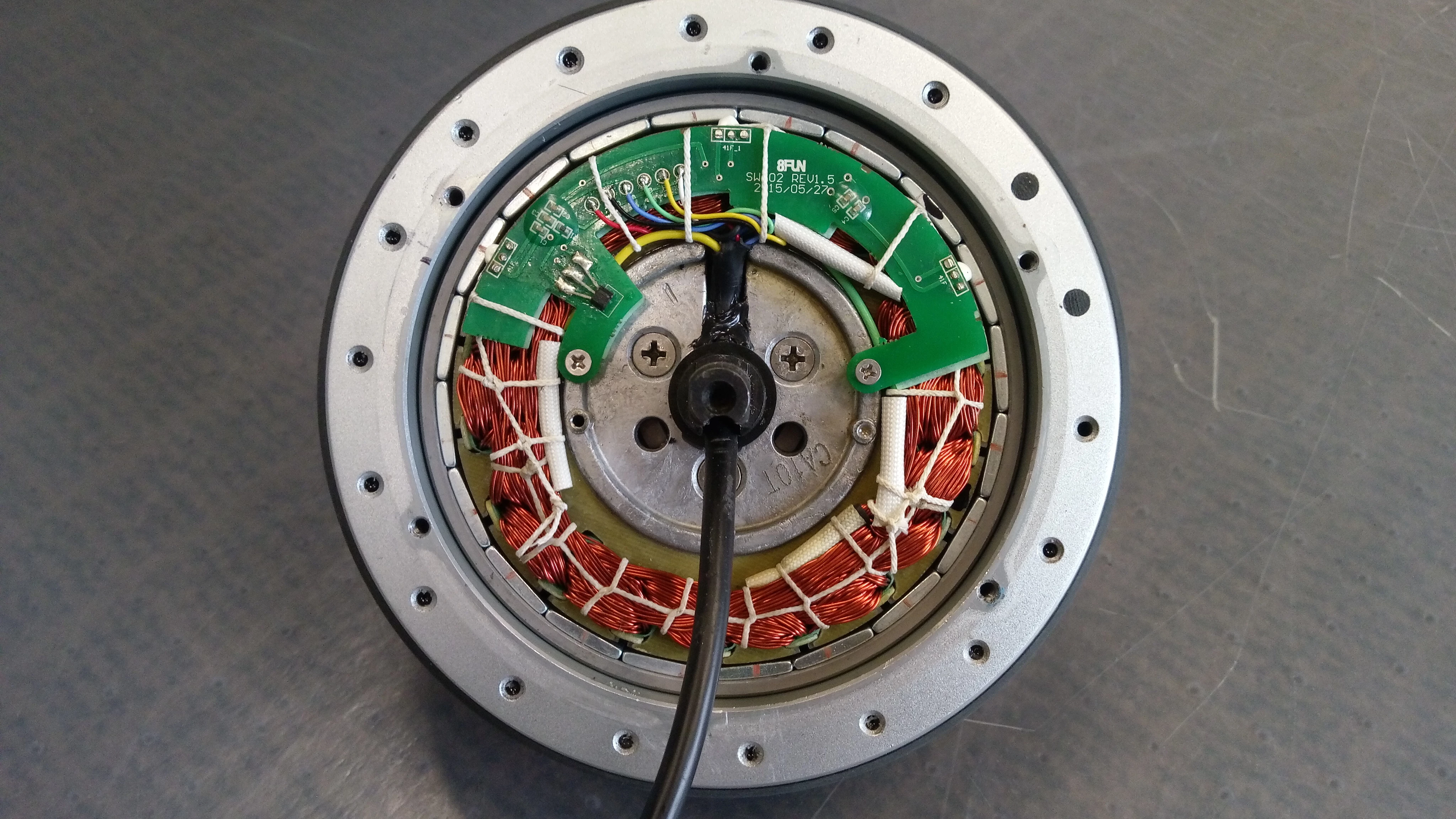

I have still had no luck with trying to get this motor going with STEVAL-SPIN3201 and Motor Control Workbench.
Here is an image of the motor internals...
0690X00000AsO6QQAV.jpgAny help would still be appreciated.

I solved my problem. Most likely here is solution for you too Gussius.
First of all, the phases and hall channels need to be correct. My motor has YELLOW-GREEN-BLUE phase wiring which corresponds my motor control U, V and W phases. The motor gives out HALL sensor wires also in same color coding; YELLOW-GREEN-BLUE and they match H1, H2 and H3.
EDIT: BTW @Gussius​ , you electrical angle is 316 degree according to my understanding. The rising edge of H1 is 2.6ms before the U peak value. From that point, the angle is calculated as 360 - 360*2.6/21.4 = 316 degree
