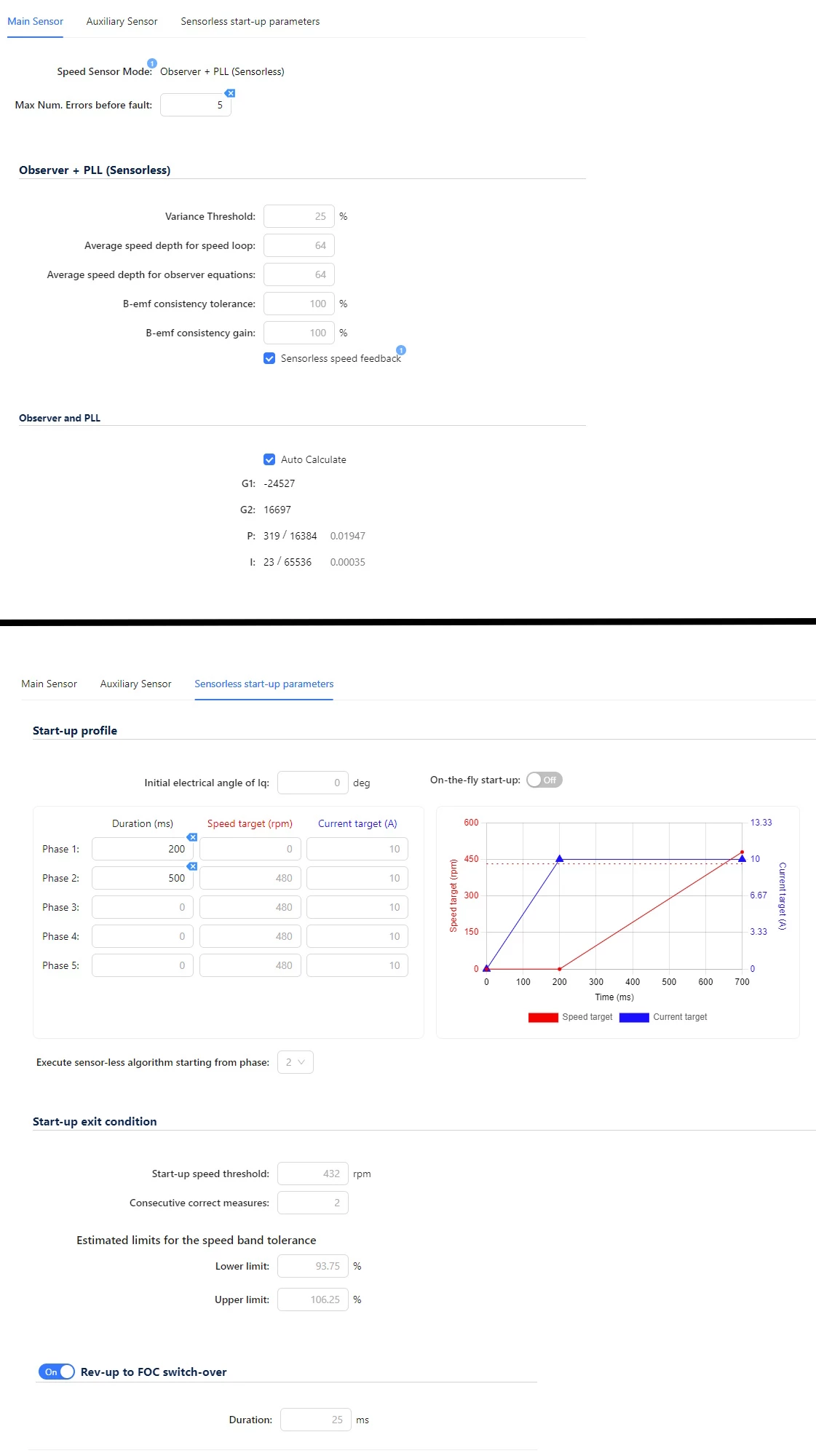

Settings: 20kHz, 100us regulator (2PWM), ADC Sampling 7.5adcclk (234ns), Sensing config see attached.

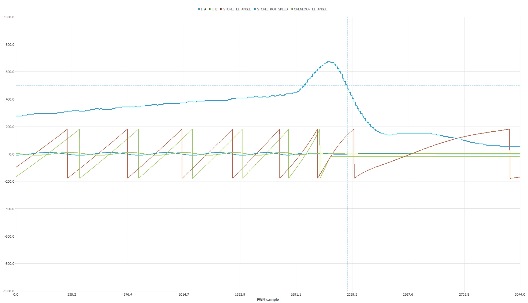

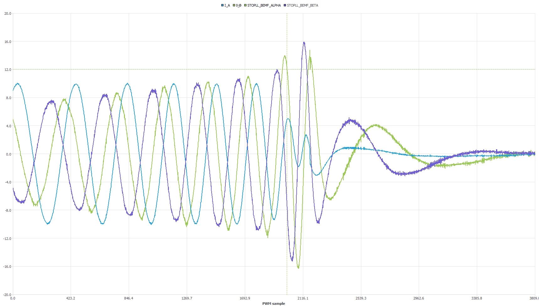

After startup, fails with "Speed Feedback". Plotted graphs show good BEMF response, proper angle and reasonable speed signals (see graphs attached), angle of PLL are somewhat behind OpenLoop. Arround start-up exit speed of 432rpm, the calculated speed of the PLL rises quickly while currents are being reduced, shortly after motor stops.
The set target speed in the Motor Pilot is 510 rpm. I tried to switch off UART interface to check if it is linked to MCU load, no success. Debug says "bemfConsistent = true, isSpeedReliable = false"

The point about using the motor profiler relates to the fact that the PID gains are also computed from the motor inertia and friction values.
As you mentioned, the switch from open-loop to closed-loop operation is complete, but the speed decreases after the transition. Did you try to increase the speed regulator PID gains to improve response?

Did you reduce the G2 gain when referring to the PLL settings as described in the wiki?
Did you try using a higher speed target, defined in the pilot or in Workbench Drive Settings > Speed regulator?

thank you for your answer. I have another board, but I read that profiling does not work with motors with that low inductance and resistance. Is that different with the new SDK versions? Apart from that, I don't see much sense, the motor is completely measured using micro-ohm-meter, LCR meter, intertia comes from CAD and BMEF constant has been measured at 100rpm steps up to full rpm.
I did reduce G2 gain as described, no difference could be observed.
I tried also using higher rpm, and shorter or longer startup ramps, result is always the same.

Sometimes is see also that the motor stops after the failed startup-exit-transition, but it is being still commuted and the PLL still generates a RPM signal. But there's no visble BEMF anymore and currents are near zero.
