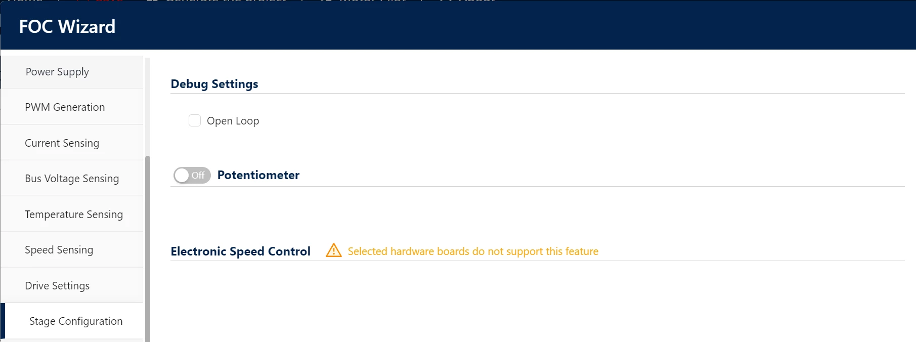

Speed control
how we can change the speed of motor in STEVAL -SPIN3201 using external Potentionmeter?/or inbuilt Potentionmeter (Variable resistor )?
    Gael A
    Gael ABest answer
    July 19, 2023
    Hello Ranjeet Singh,
    Using the MCSDK 6.1.2, you can enable the potentiometer while configuring your project via WorkBench.
    Under Stage Configuration, check the Potentiometer box :
    The generated project should include a speed control using the board's potentiometer.
    Hope this will help,
    Gaël A.
    If you agree with my answer, please consider accepting it by clicking on 'Accept as solution'.

    how to solve this in old software 5.4.7 ?
    Gael A
    July 20, 2023
    Unfortunately, the potentiometer feature was not available in MCSDK 5.4.7 and was introduced in version 6.0.
    However, you can still implement it yourself with a bit of coding.

    sir ,can i know how i can add this coding?
    Gael A
    August 7, 2023
    In my opinion, the easiest way to do it is to generate two projects using MCSDK 6.1.2 : one with potentiometer enabled and the other without, and see what the differences are so you can copy the potentiometer related part of the code to your 5.4.7 project.
