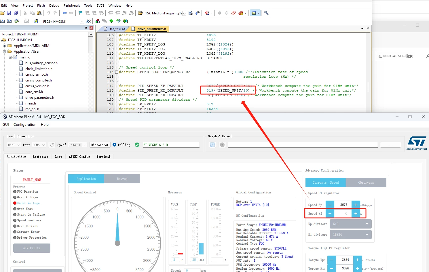

Some confusion about MCSDK 6.2.0
[VERSION]: 6.2.0
[TOOL]: ST Motor Pilot/ MotorControl Workbench 6.2.0
[DETAILS]:
1.The speed ki ‘s numerical values ​​do not correspond.It is different from 5.Y.4.
2. About the Board Maneger. I want to add my own board but no documentation guidance.
3. About the Phases Current Sensing. I want to change it to Isolated Current Sensors, but the same reason.
I'm expecting a reply.

For your first question, this is an error that I reported to be corrected for the next version. In the meantime you can resolve this error locally by following these steps:
1.Go to the directory where the Mcsdk is installed, then open the folder: MC_SDK_6.2.0\Utilities\PC_Software\STMotorPilot\RegisterList
2. Open the RegListSTMV2.json file with a text editor
3. Find the "SPEED_KI" register and delete the "Scale": "CURRENT_SCALE" line, which is associated with this register.
4. Save, then restart the Motor Pilot, normally you will have the correct value.
