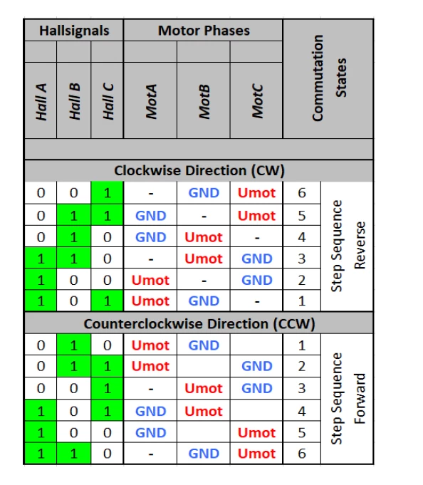

    I have been trying to run the motor in the Clockwise Direction(CW) i.e step sequence Reverse. When i try to run in the sequence 6,5,4,3,2,1 i am not getting the hall values as shown in the below image, Instead i got the hall values as 001 for sequence 6, 101 for sequence 5, 100 for sequence 4, 110 for sequence 3, 010 for sequence 2, 011 for sequence 1.
    What shall be done to solve this one.

    For 6 step commutation there will be one time calibration procedure to be performed to find the correct sequence to drive the motor.
    For example
    If H1, H2, H3 are fixed you have to find the right phase sequence to switch ON the PWMs
    Ex:
    H1=0, H2=0,H3 = 1; U Phase=PWM ON, V Phase = PWM OFF, W Phase = Not Connected etc
    so for the six states find the correct sequence of switching ON the pwm's.
    Once this calibration is done, you can drive the motor based on the Hall position.
