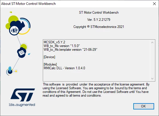

Keeping your hints in mind I:
1.) installed MCSDK version 5.Y.2
2.) opened the 6S_IHM16_HS_VM.stmcx file with ST Motor Control Workbench and saved it to an empty location

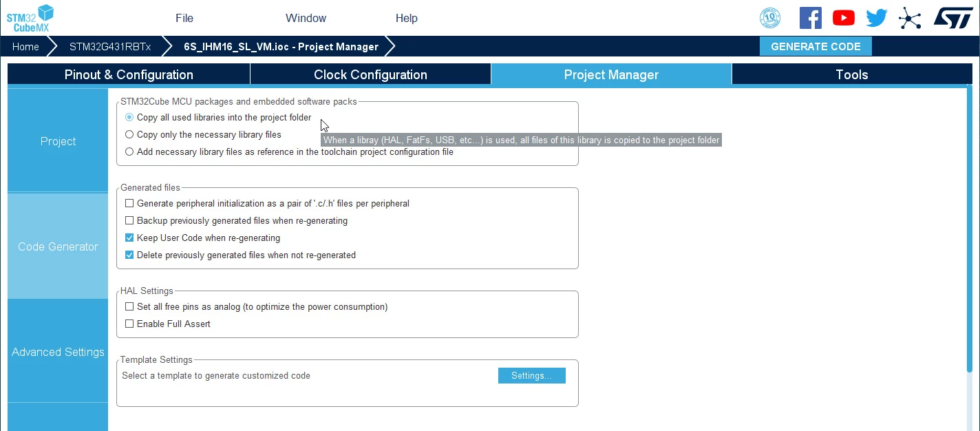

As far as I understand your trouble, I can see two ways getting the example source files from our MC SDK.
1st one is to generate the example for another IDE, like EWARM.
2nd one is to update the example like you do for steps 1) to 3), then to open the 6S_IHM16_HL_VM.ioc file with STM32CubeMx, then going to the Code Generator sheet (within Project Manager tab) to select the "Copy all used libraries into the project folder" as shown below and to click on generate button inside STM32CubeMx. Finally, you can compile using CubeIDE and download the elf file
