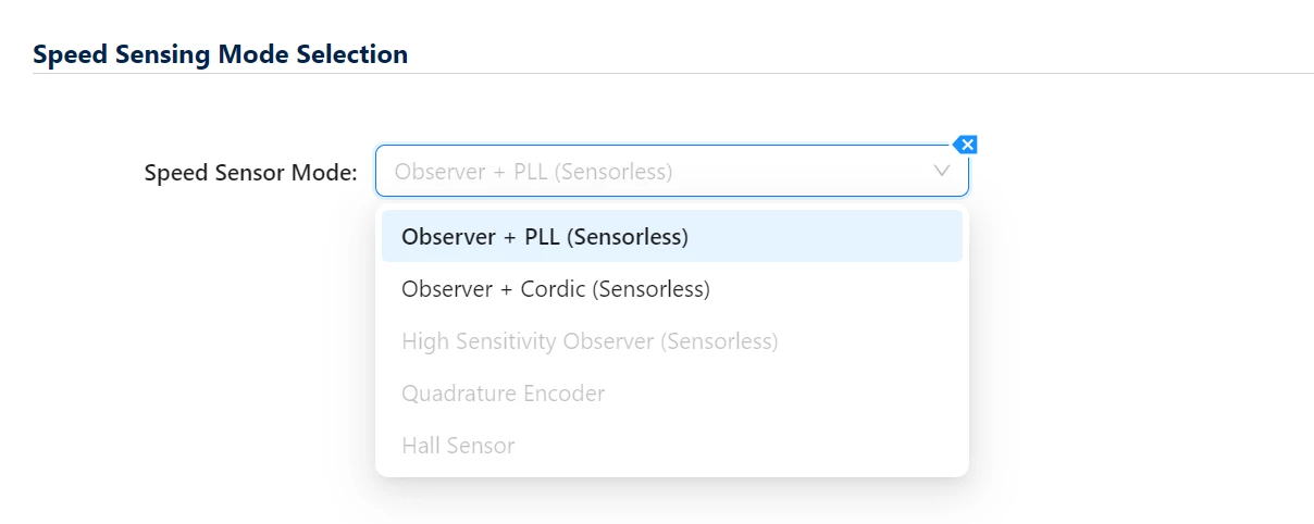

Hello Everyone,
I’m using sensorless FOC to control a BLDC motor with 3-shunt current sensing for closed-loop control. At startup, the motor slightly moves backward before starting to rotate in the correct (forward) direction. I understand this is likely due to the lack of initial rotor position information. There are no position or speed sensors involved—everything is handled via FOC and current feedback.
I verified that 6-step control on the same hardware supports Initial Position Detection (IPD), although I haven’t tested it yet. That said, I am not switching to 6-step control. I want to stay with FOC and retain the 3-shunt topology for current sensing in closed-loop mode.
My questions:
  1. Is there a way to prevent this backward motion using FOC only?
  2. If IPD is the only viable solution, how can I integrate IPD into the FOC framework, using my current hardware setup (STM32F401RE + 3-shunt topology)?
  3. Can I reuse the 6-step IPD logic just for startup, and then transition into FOC with 3-shunt current sensing?
Any guidance, suggestions, or example implementations to help integrate IPD with FOC would be greatly appreciated.

Jul 18, 2025 3:21 PM UTC
Hello @Mani2,
As you mentioned in your attached snapshot: "HSO requires at least 2 ADCs to sense both currents and voltages".
In this same HSO Overview chapter, a figure "Three-shunt topology hardware architecture" shows the needed Phases Voltage ADC topology that is not available on IHM16 HW topology. Only Current via R shunt is available.
HSO is only available on STEVAL-PTOOL4A inverter and B-G473E-ZEST1S/STEVAL-LVLP01 for the moment.
Hardware IHM16 topologies are different for 6-step IPD and FOC. Generating projects for both modes you will have a list of hardware modifications to be done.
We do not plan to adapt this IPD feature for FOC. IPD description is available "Initial Position Detection" chapter of User Manual "six-step Firmware Algorithm" part.

I’d like to clarify that I’m planning to go sensorless only, and I’m already committed to using the STM32F401RE MCU. I’ve checked that this hardware does not support HSO in the STM32 Motor Control Workbench, which is why I’m exploring other options.
Specifically, I want to reuse or adapt the 6-step IPD logic just for startup, with necessary modifications to make it compatible with FOC. I’m not planning to switch between 6-step and FOC modes dynamically — the goal is to keep everything within the FOC framework, using the existing 3-shunt hardware setup.
If there's any guidance or example on how to implement IPD purely for startup before switching into FOC with this hardware, that would be very helpful.
Thank you.

Hello @Mani2,
HSO is only available on mentioned boards.
6-Step IPD feature is based on HW topology (BEMF measurement / Single Shunt current measurement, refer to documentation available through "Workbench tool">About>Documentations>Documentation>"User manual" tab "Six-step Firmware Algorithm" link), that is not compatible with FOC Sensorless HW topology.
