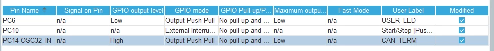

I'm currently working on sending signals through FDCAN or UART of B-G431B-ESC1 while driving a motor.
I have written a debug code which sends UART data when a button is pressed.
However, the function is called once and never called again, nor the motor won't start.
"stm32g4xx_mc_it"
uint8_t mc_it_debug[64];
void EXTI15_10_IRQHandler (void)
/* USER CODE BEGIN START_STOP_BTN */
  sprintf(mc_it_debug, "StartStop Button Pressed\r\n");
  HAL_UART_Transmit_DMA(&huart2, mc_it_debug, sizeof(mc_it_debug));
  if (  0U == LL_EXTI_ReadFlag_0_31(LL_EXTI_LINE_10) )
    /* Nothing to do */
  else
    LL_EXTI_ClearFlag_0_31 (LL_EXTI_LINE_10);
    ( void )UI_HandleStartStopButton_cb ();

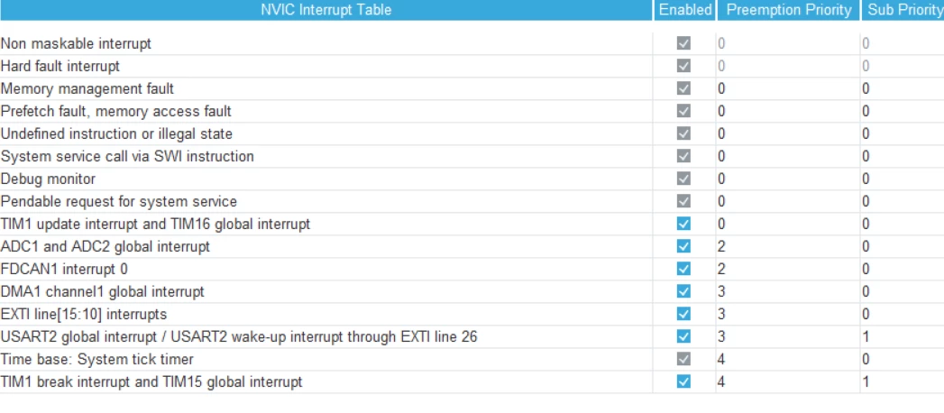

I am assuming it is a priority issue, which is set as
Any advice will be helpful.

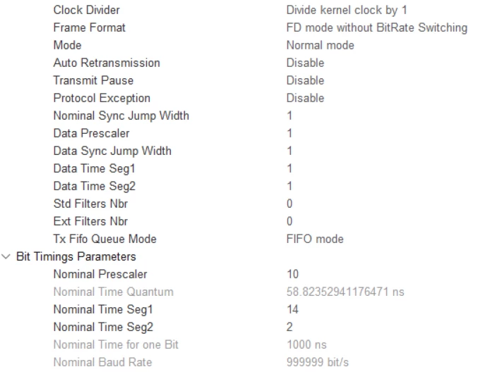

    Update : FDCAN also works, so anyone who tries to use FDCAN,
    my setting is (for 170MHz clock)
    I don't know what's wrong with DMA really.
    mƎALLEm
    July 6, 2023
    Regarding your FDCAN bitrate config, I see 999999bit/s. So please try to find another values for NSEG1 and NSEG2 to have exactly 1000000bit/s (1Mb/s)

    I cannot imagine that 1ppm deviation of the FDCAN bitrate is the problem here...
