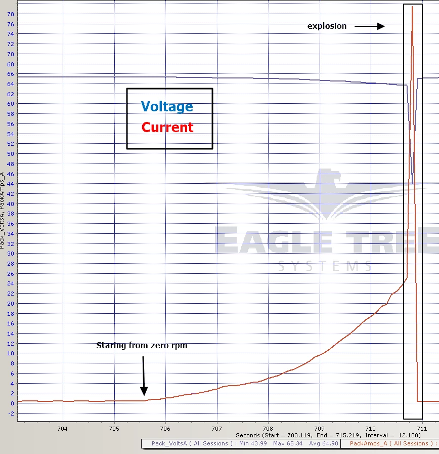

4. My team is using the library to run the motor of the personal electronic vehicle and using hall sensor to get the position. Sometimes the current goes up so high than usual when I start it while it's spinning(It even exploded last time). Is this normal?
In an effort of preventing this, I tried to modify the library to make a PWM-off state for the first 1~2 seconds of the motor start so it can determine the speed and angle(like On-The-Fly feature). However, the attempt failed and exploded the PCB.
As an alternative, modifying the library, I put the library on the start state all the time and change the current reference to 0 when it should not spin.
5. When using SetCurrentReference, it works fine once it's running, but blows up when it starts fast. I have attached the photo of current logging, so if you have any opinion or recommendation, I'd be glad to hear it.
