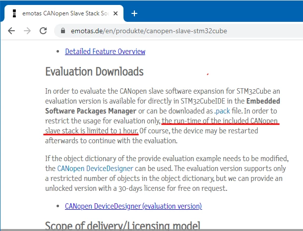

The CANopen protocol can be added in STM32Cubemx6.5.0, which is great! I added the emotas. I-cube-canopen.1.1.2 extension package to CubeMX Software Packs. After the Build was set up, the code was compiled normally and started to run. However, after running for a period of time, a message indicating hardware failure is displayed.CANopen is said by Emotas to have copyright restrictions, is that the reason? Hope to guide the solution.

@Dldw.1​ "after running for a period of time, a message indicating hardware failure is displayed"
Would that "period of time" happen to be 1 hour, by any chance ... ?

Hello, Yes its very likely that this is the cause.

@Dldw.1​ "CANopen is said by Emotas to have copyright restrictions, is that the reason?"
Have you asked Emotas that question?

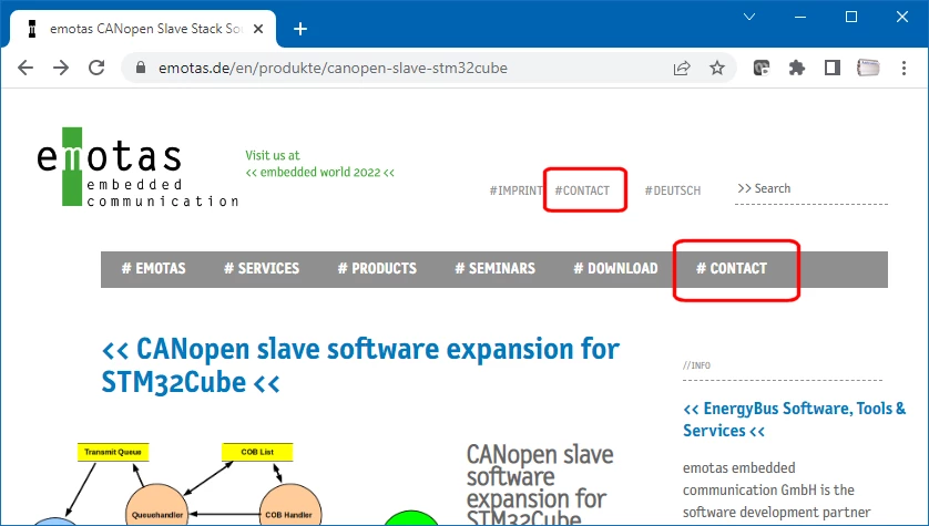

I went to the website of Emotas, but could not find the entry for obtaining a complete licence.
Best regards to you.
Dldw.
Andrew Neil
June 9, 2022
Go on - there's two 'Contact' links at the top of the page::
(might be spelled the German way - "Kontakt")
