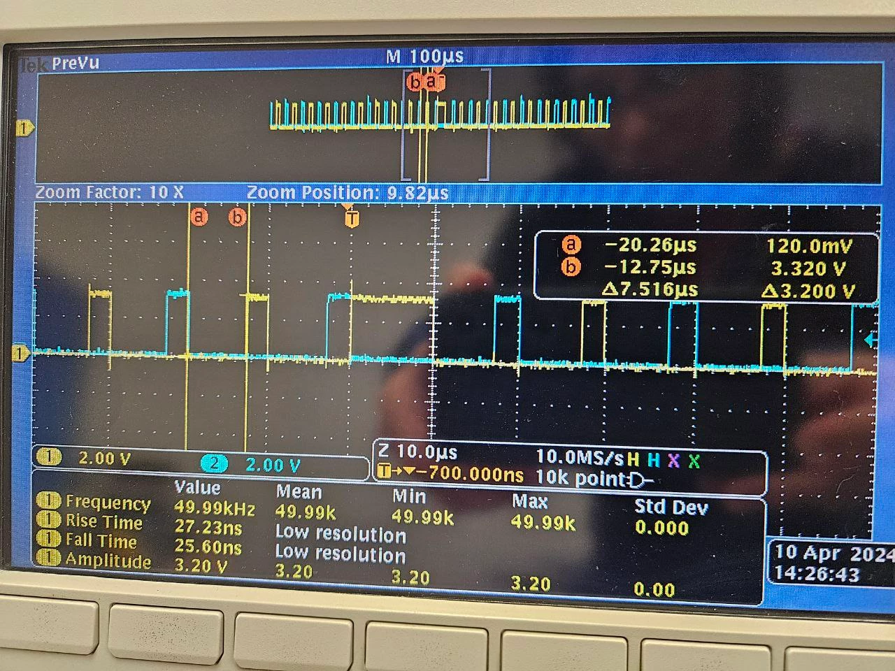

I'm having some issue while updating the deadtime of the PWMs on Advance timer TIM1 during PWM operation is running.

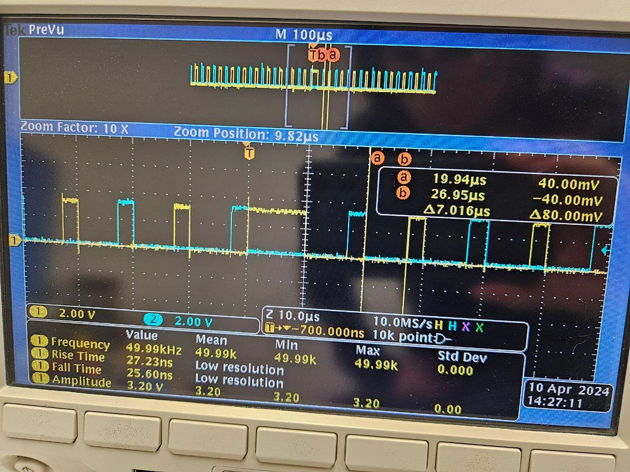

I'm attaching the scopeshot with the Channel 1 and 1N pulses, during deadtime register(DTGbin) update ,the deadtime is zero.
In the scope shots we can see the dead time before and after the deadtime update where the CH1 signal stays high for a longer duration, the pulses also seem to cross (x) switch at the wrong time also. I observe this happening at some deadtime updates but not every update.
Would you know why it does this or how to fix it?
My application needs to have large deadtime in the PWMs during startup which I ramp down to small value during normal operation to limit the current in converter.
Thank you,

Which STM32?
I have little experience with deadtime, but generally, this:
	TIM1->BDTR &= (TIM_BDTR_DTG_CLEAR_MASK);		// Clear the lower 8 bits of the BDTR register
	TIM1->BDTR |= (DTG_bin<<TIM_BDTR_DTG_Pos); // Set the lower 8 bits of the BDTR register to the dead-time generator setup
is incorrect, in that there is a period when deadtime is set to zero.
So, read in the current BDTR value into a variable, modify it in that variable (both AND and OR), and write back the result.
I don't think this fixes your problem but you should do that anyway.
As BDTR fields are not preloaded, if you want to avoid any problem, generate an interrupt by a different channel somewhere in the middle between the edges, and change BDTR there. Have the computation done beforehand, so that the latency is as short as possible (Cube/HAL is not  helping in this).

I was indeed setting the deadtime to 0 and then setting the deadtime at the following instruction.
After changing both lines you mentioned to the following :
TIM1->BDTR = (TIM1->BDTR & TIM_BDTR_DTG_CLEAR_MASK) | (DTG_bin & TIM_BDTR_DTG_SET_MASK) ;
I no longer could see the issue and the deadtime was respected.
Thank you for your help it was much appreciated,
