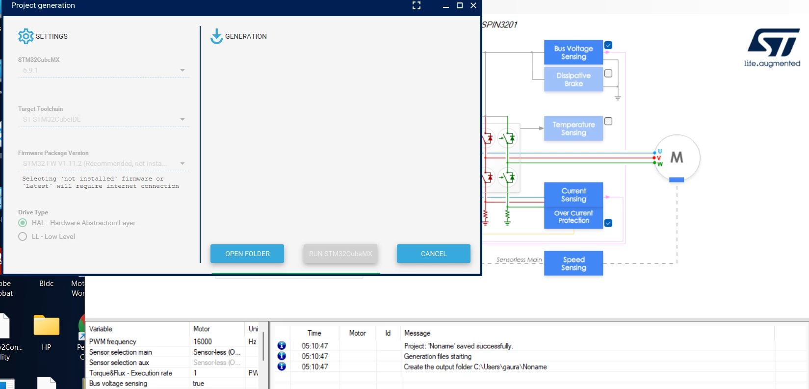

project generation issue
when i generate the  project in the mcsdk then it continue showing like this .
i have wait long time its still showing same, what i am doing wroing ?
Zied b.Best answer
September 19, 2023
hello @Ranjeet Singh
you seem to be using a version 5.Y.4 or close, but these versions do not support CubeMx 6.9.1, download CubeMx 6.4.0 then select it, the generation should work better

Ranjeet Singh
Senior
September 20, 2023
thank you @Zied b.
