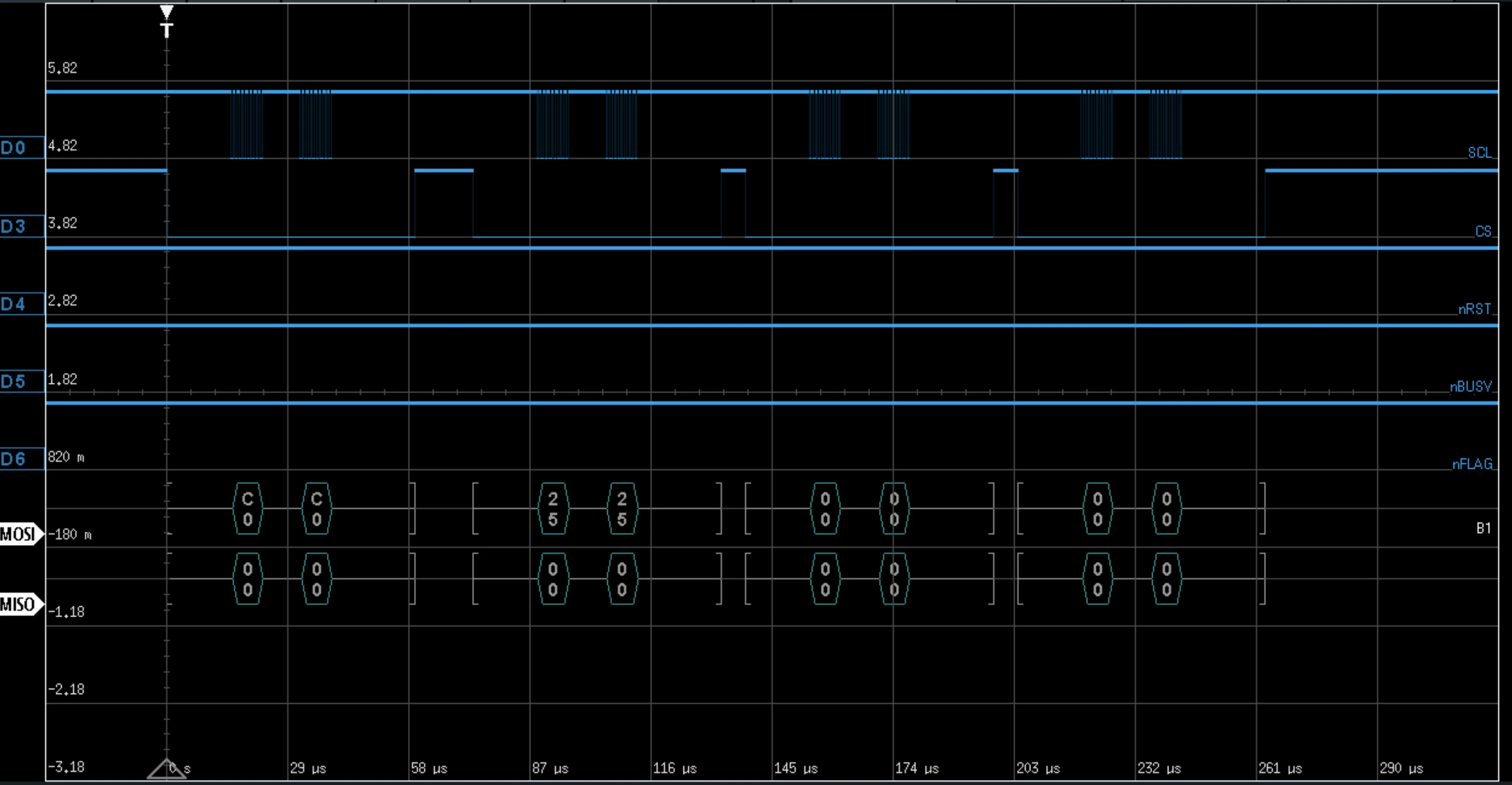

I am using IHM02A1 expansion board (on top of L073RZ), which has two L6470 connected in a daisy chain configuration. I cannot receive any data from the devices. What do you think the reason can be ?
Below is the bus status of a reset and get param for register ACC (0x5) since its default value is not 0:

Hello @mete​ ,
I confirm that the device must be supplied through VS main power supply and the VREG voltage is internally generated starting from VS.
The VDD pin voltage sets only the logic output pin voltage range, is not sufficient to operate the SPI.
Let me know if we can consider solved the problem ;)

Hello @mete​,
did you check the SPI lines solder bridges configuration?
In the user manual UM1964 you can find (at page 11) how the SPI lines are mapped on the ST morpho and Arduino connectors.
The NUCLEO-L073RZ is not supported by the X-CUBE-SPN2 software package, are you using a custom firmware?
Please check and let me know, so I try to help you.

Hello @Cristiana SCARAMEL​ ,
Yes I think so, I actually more than triple checked the connections. I think 072RB and 073RZ is same in terms of the pins, and I also checked through Arduino naming too, so actually the default solder bridges should be fine, so I did not change anything on the board.
I am not using the SPN2 package other than looking at it for reference. So basically this is what I am doing:
  • disable/assert low nRST, wait 5ms
  • I also do an empty HAL_SPI_TransmitReceive here, because I realized SCL stays low even if SPI is configured as CPOL High before the first transfer so I thought maybe it can be a problem. After this SCL stays high.
  • enable/assert high nRST, wait 5ms
  • send SPI reset command (this is on the output above)
  • send SPI get param for ACC (this is on the output above)
While sending SPI reset and get param, I wait at least 1us after asserting nCS low and high.
I copy below the SPI and GPIO configs for you to look at, esp. GPIO config is not something I am 100% sure. (sysclk is 32MHz, I am using /32 for SPI).
