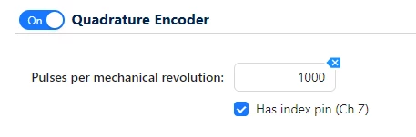

I have configured the MC Workbench with the following options:

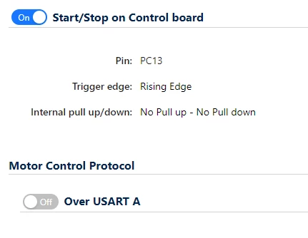

Not using the MC Pilot so I have the following in User Interface:

I have the following BLDC motor:
BL17E40-01 | BL17 Series | BLDC Motor | Lin Engineering
and I have installed the following encoder:
AMT11 Series | Modular | Incremental | Rotary Encoders (cuidevices.com)
The problem I think is these are relative encoders, and the MC workbench calls encoders with Z pins as absolute encoders.
