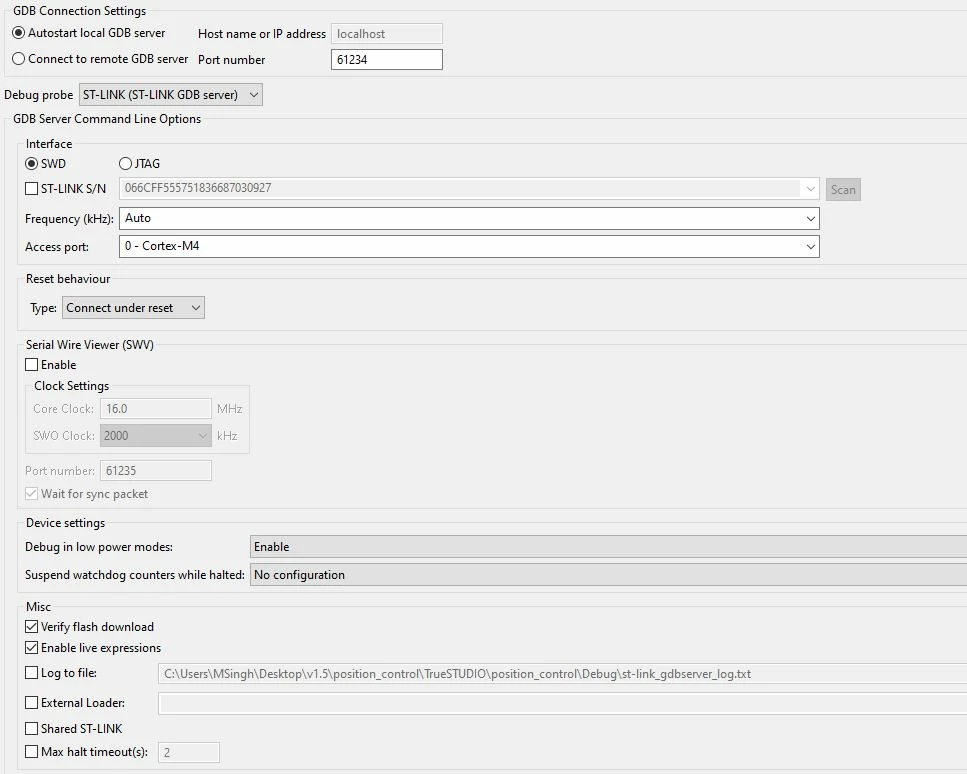

I do not see any PWM signals being generated I'm guessing that's the reason for it not to move? can the debugger configurations affect this? I had changed them to try implement printf. Here's what they look like now.

Laurent Ca...
Senior III
October 20, 2020
Dear @msingh (Community Member)​
Did you try:
  • 1. to come back to the previous configuration of the debugger (just in case of)
  • 2. and to run you board without physical connection to the debugger
Best regards
Laurent ca...

Dear @Laurent Ca...​ ,
Since I am using the nucleo-f303re the debugger is in the same PCB, but I have moved the JP5 jumper to power the MCU from the IHM08M1 instead of USB, This results in more current used, 0.085A (probably because now I also supply the control board and not only power board) but still no movement is achieved. I have actually noticed something now. The PWM was being generated but with 100% duty cycle on the "TIM1_CHxN" channels while 0% duty cycle on the "TIM1_CHx" channels. I have noticed this because after 2/3 minutes of drawing 0.085A it jumped to 0.126A but still no movement is achieved. and the motor rotor is harder to rotate compared to before. It seems like the programmer on board is faulty? I have an additional ST-LINK/V2 which I could try using to program? what do you suggest doing next?
Hope this will help you identify the issue. I really appreciate your quick replies and effort to help.

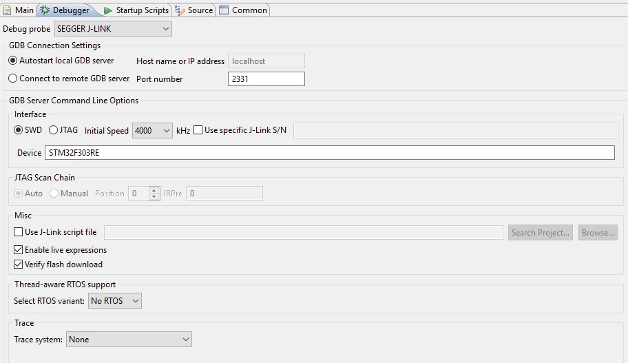

KKuma.3
October 22, 2020
0693W00000591eyQAA.png@msingh​ " STM32 Motor Control "I have used a similar set up as you have used, same controller and power board.
The motor is also very similar , and it works perfectly fine with the position control application of 5.4.4.
ST link could not provide live watch variables , hence I changed to Segger using a script provided at ST website/ segger website I do not remember.
I have attached the screenshot of the debugger configuration.
The only step which I perform is clear the build after any changes to the code and rebuild the project to generate the flash.
I am using Atollic studio,

@KKuma.3​  Thanks for sharing your debug configurations, I assume the frequency depends on the debugger ? as I do not have 400kHz available in my list. I have tried doing a clean that didn't help.
KKuma.3
October 22, 2020
@msingh​  You are right , I am using the STlink but on borad Jlink . refer this https://www.segger.com/products/debug-probes/j-link/models/other-j-links/st-link-on-board/
