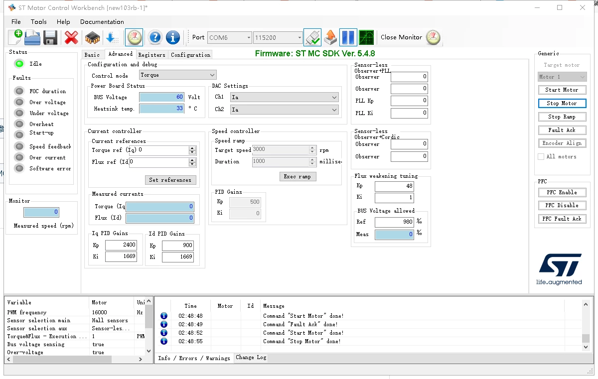

sunboy_351_1-1703141714429.pngMCSDK5.4.8版本 相最大电流270A,采样电阻0.0009欧,Lq 0.0991mH,Ld 0.04115mH,定子电阻0.01974毫欧,三电阻采样,相电流采样放大倍数3,电机相移角295度,PWM  16000Hz, 扭矩环调参后电机轴抱死,无法启动。

    Hello @sunboy_351
    Correct me if this translation is incorrect.
    > The MCSDK5.4.8 version has a maximum current of 270A, a sampling resistance of 0.0009 ohms, Lq of 0.0991mH, Ld of 0.04115mH, a stator resistance of 0.01974 milliohms, three-resistor sampling, a phase current amplification factor of 3, a motor phase shift angle of 295 degrees, and a PWM frequency of 16000Hz.
    After adjusting the torque loop parameters, the motor shaft is locked and cannot be started.
    Have you tried reducing the gains? Have you tried X-CUBE-MCSDK-6?

    Workbench:
    test
    1 first start  status  under voltage
    2.clear  the  fault  next  start
    motor Vibration  status  Run  is not faults
    Stop-> next start:  motor is not rotate
    Open loop   motor Normal rotation
    I use STM32F103RBT6, 64MHz, the above problem occurs, how to find the problem point?
