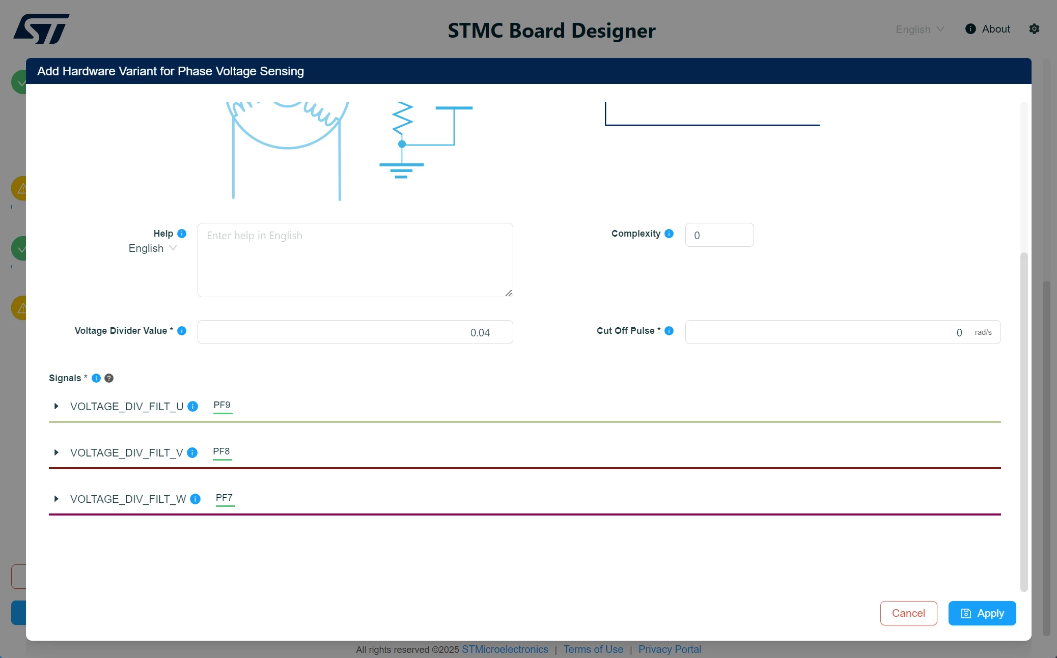

pin conflict on MCSDK board designer

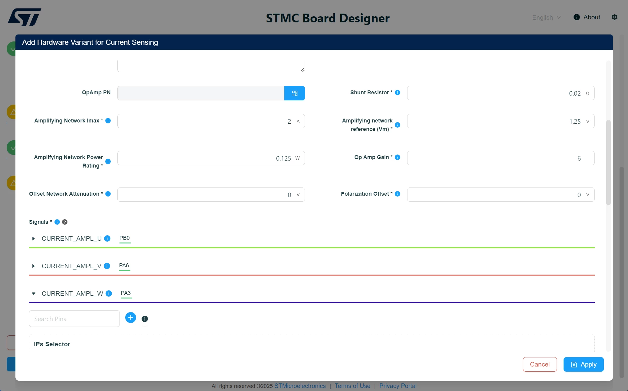

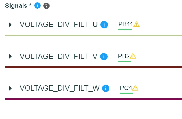

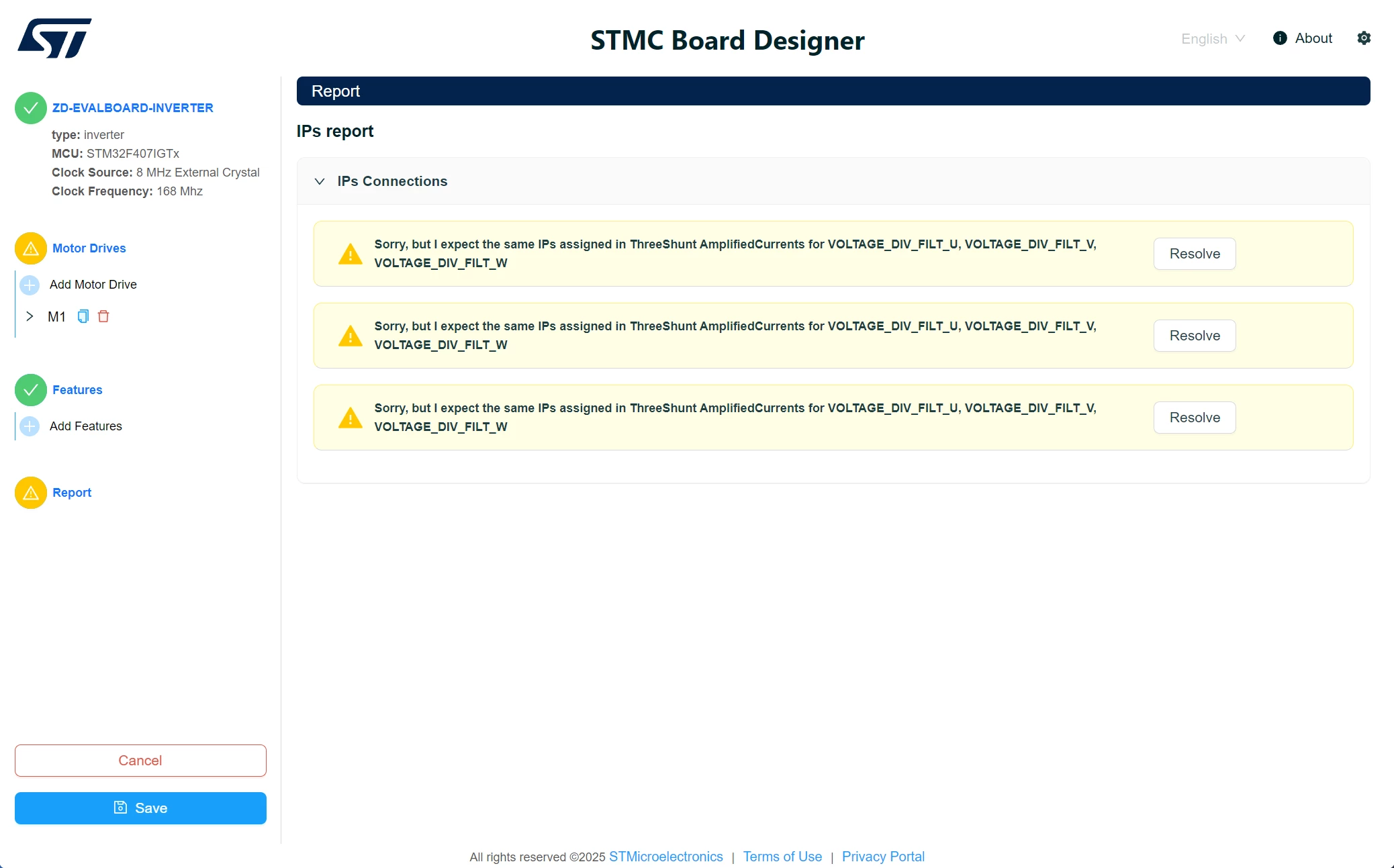

picture tells all. the resolver says these two functions have conflicting IP settings but the settings themselves apparently not.

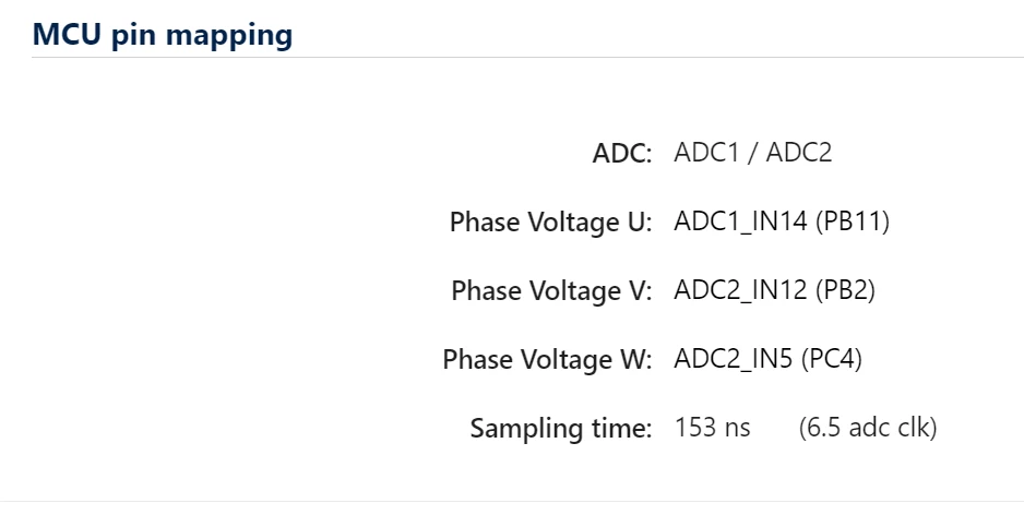

The Phase Voltage Sensing is always used in addition to the Current Sensing feature, it must observe a few rules :
  • It must use the same number of ADC than Current Sensing (2 or 3, since this is an HSO only feature)
  • It must use the same ADCs as Current Sensing too, but the order does not matter.
    • Ex : Current Sensing: U->ADC1 ; V->ADC2 ; W->ADC3 and Phase Voltage: U->ADC3 ; V->ADC1 ; W->ADC2 is possible
  • In case of 2-ADC, the used ADCs for Current Sensing and Phase Voltage must be complementary !
    • Ex1 : Current Sensing: U->ADC1 ; V->ADC1 ; W->ADC2 and Phase Voltage: U->ADC1 ; V->ADC2 ; W->ADC2 is possible
    • Ex2 : Current Sensing: U->ADC2 ; V->ADC1 ; W->ADC2 and Phase Voltage: U->ADC1 ; V->ADC2 ; W->ADC2 is NOT possible

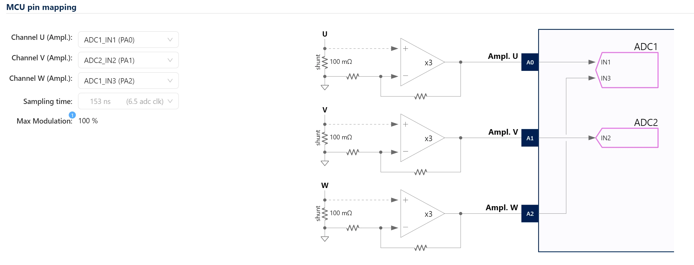

I encountered the same issue.
Everything works fine when I generate the HSO project using MCSDK 6.4.0 with a custom inverter board,
but when I open the project with MCSDK 6.4.1 Board Designer, an error occurs.
MCU: STM32G431CBU6
Pin assignment in project generated by MCSDK 6.4.0:
