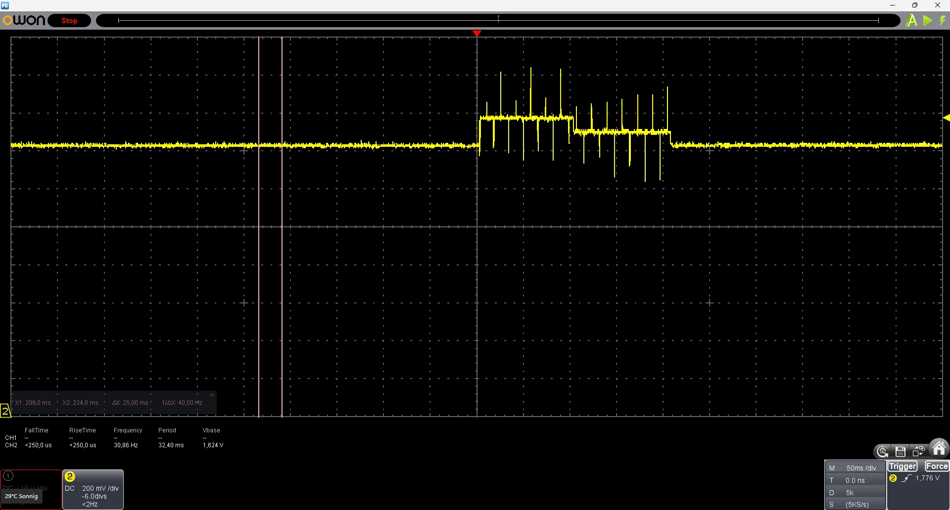

Hi everyone,
I am currently testing the Current Regulator Step Response as described in the ST Motor Control documentation.
I do get the sharp edges, but I see short peaks/overshoot in the current waveform.
Setup:
What could be the reason for the peaks?
1 reply
AScha.3
Aug 25, 2026 11:36 AM UTC
Typical measuring problem: you some induced magnetic - > voltage spike.
Try better points for ground at the probe, maybe even the usual ground clip connection is too long, so need these ground spring at the probe.
And check for any ground loop with the scope and its connection to mains ground.
