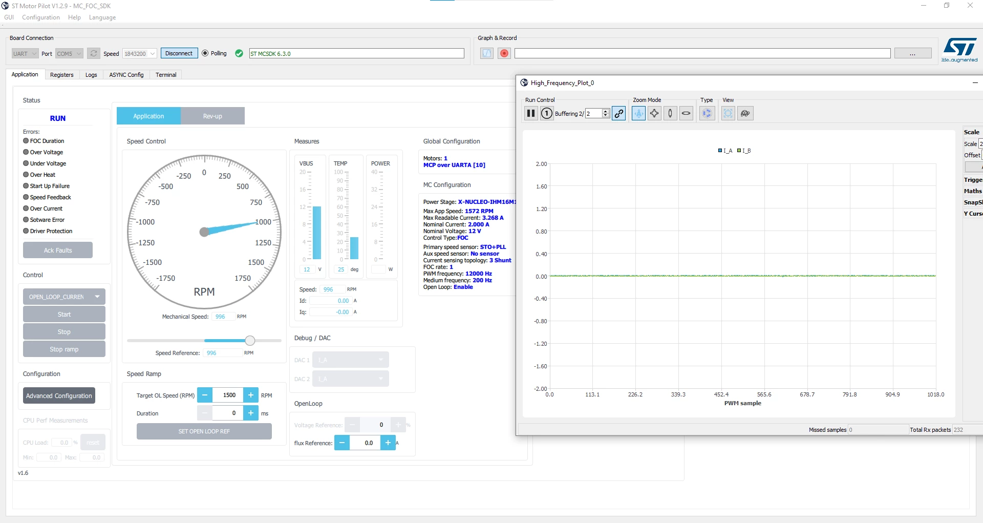

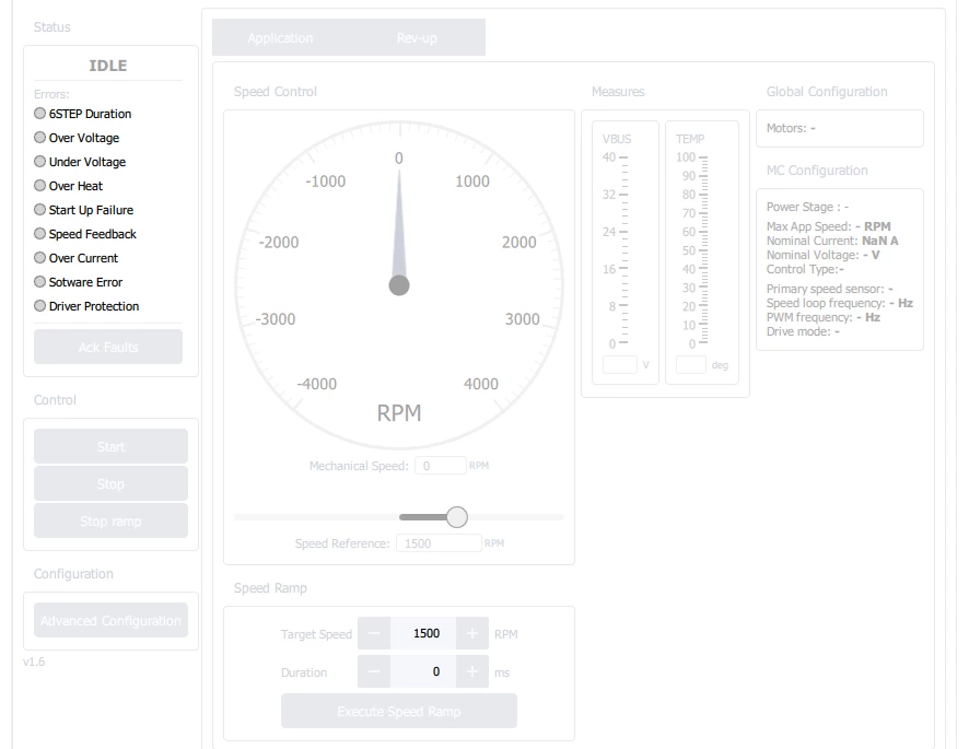

Where is the option for reducing the target current to 1Amp in Motor Pilot (see screenshot below). I tried increasing ramp time but it didn't work.

You can access the revup procedure by clicking on the "revup" tab next to "Application"
I recommend modifying the start-up time using the revup table. The "Speed Ramp" square is more useful for creating speed ramp when your motor is already turning.

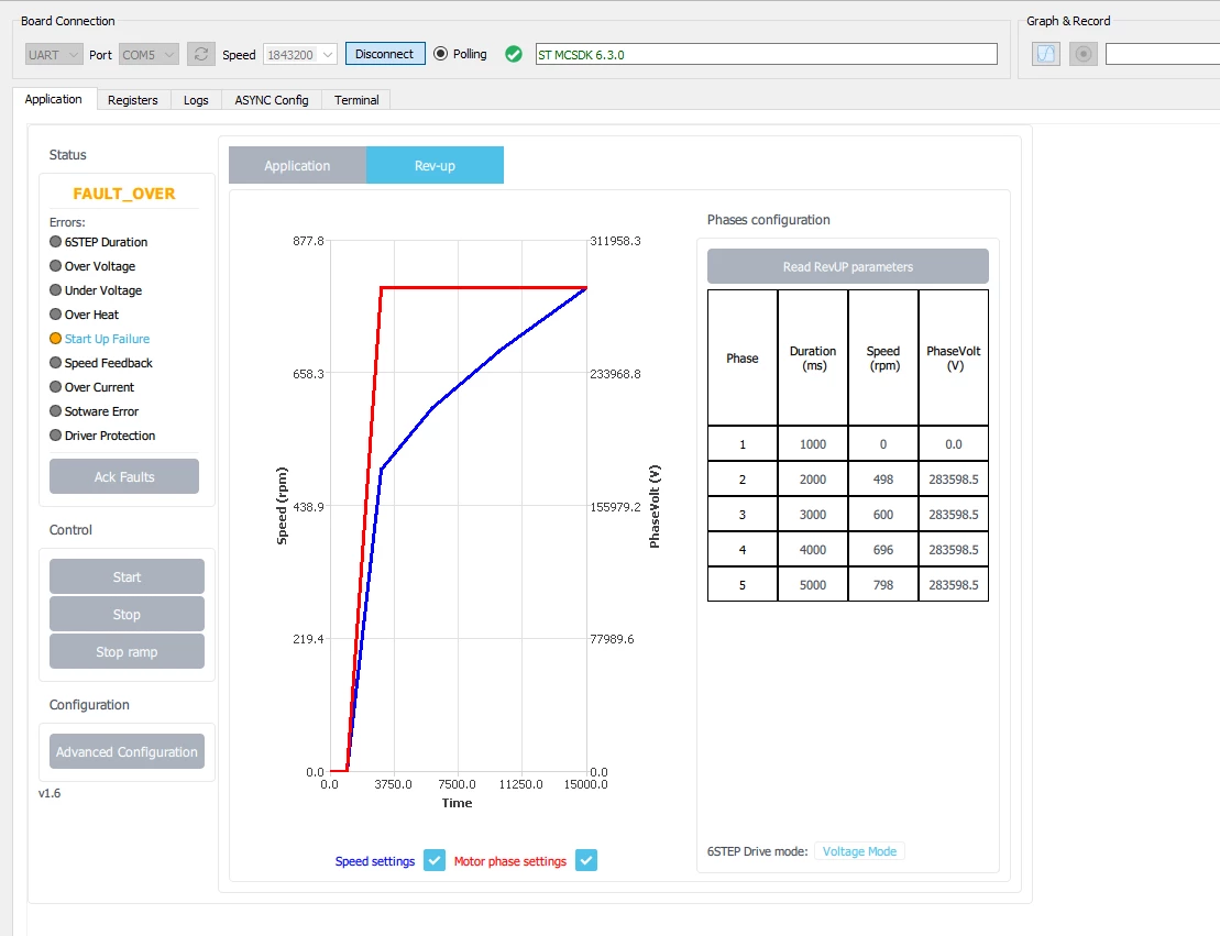

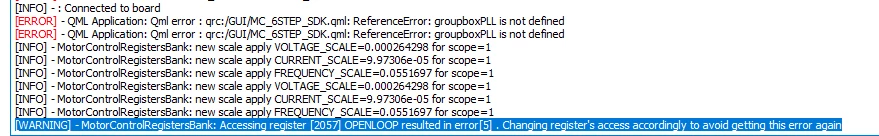

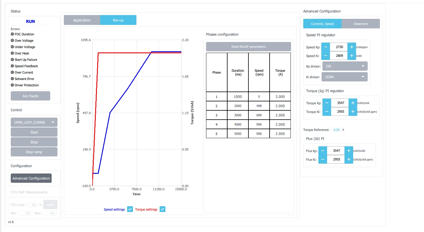

It has started working better. When i feeded the table in revup section (see screen shot). But after reaching the last entry of the table, Pilot again shows Startup Failure. Whatever last value, i feed in the table it goes till it and then startup failure. Why so? this3.png
I am getting this in logs

The way I see things here, you have a 6-STEP project (or you loaded the MotorPilot with the wrong GUI), which is not the default setup of the IHM16 when shipped with a P-NUCLEO-IHM03. Have you checked that your IHM16 hardware is correctly set ?

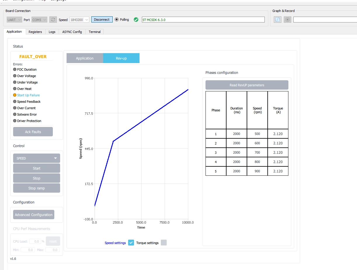

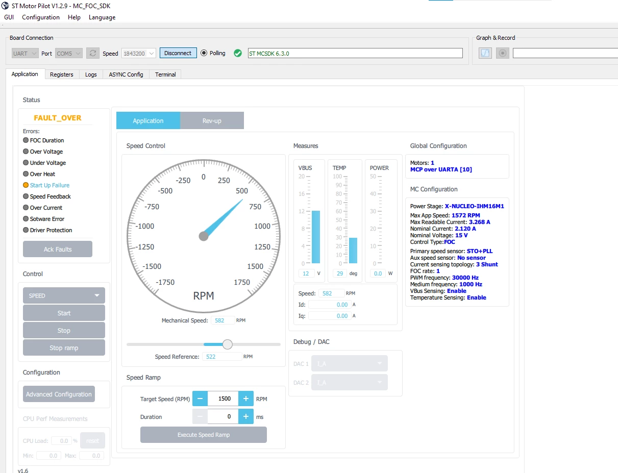

Okay. I have loaded correct version now but still issue is same. Running till last entry and then startup failure. Please help.
When it reaches 900 rpm, it stops and shows startup failure.

Okay then could you try to Reset GUI to Default in the MotorPilot GUI tab, and then try the Discover Board button and then see how that goes please ?
If you agree with my answer, please consider accepting it by clicking on 'Accept as solution'.
tejas_ampAuthor
June 12, 2024
Done. Please see edited reply above.

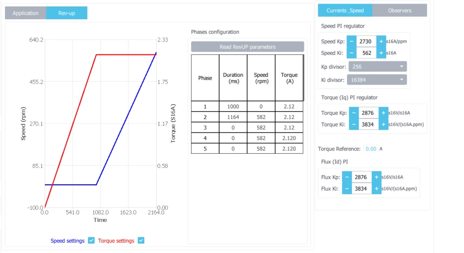

The following setup is working fine for me, have you tried with something similar ? Don't hesitate to have a look at the Advanced Configuration.
You could also try to reduce the target speed to 400rpm (leave the first line at 0rpm, otherwise your motor won't align)
Another idea would be to increase the duration of the 2nd phase (1164ms one in my snapshot)

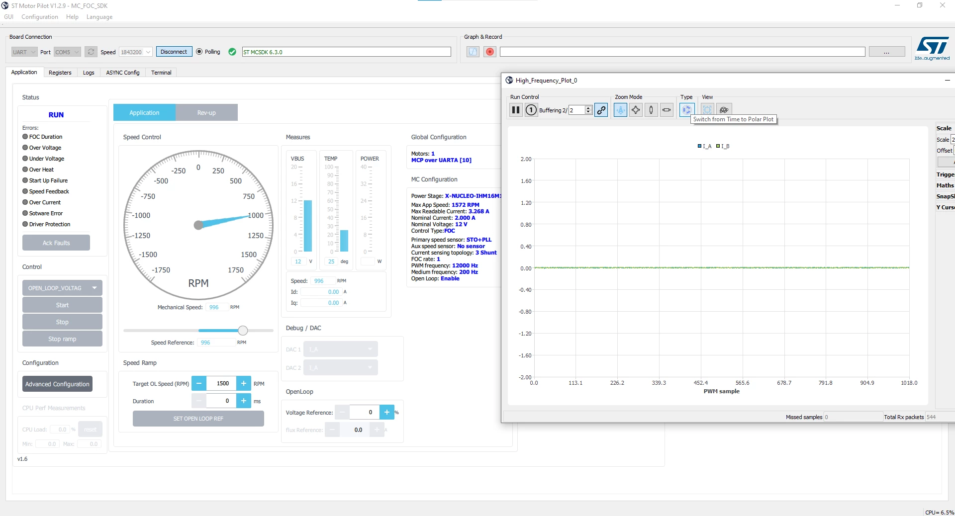

Open Loop Voltage Mode Ia and Ib Motor state is "RUN" but its not spinning.
Open Loop Current Mode, Ia and Ib, same thing happening:
Parameters:
What does this open loop result shows?

Hello tejas_amp, I hope you had a lovely weekend too,

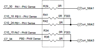

By looking at your current curves, it seems that there is a Hardware issue. At this point it could come from anywhere in the IHM16, but please first make sure that it is configured correctly, especially JP4 and JP7 for Shunt configuration, and J5 and J6 for current sensing :
If this is ok, the next step would be to have a look at the IHM16 schematics and see if any component is missing.
Maybe there is a resistor missing in the current feedback part :

Can you please confirm what is meant by "Solder bridge at bottom"?, JP4 and JP7 are already Open.
For others, I have checked the connection and schematics and they are correctly present.
"By looking at your current curves, it seems that there is a Hardware issue", In Open Loop test, since Ia (Blue) waveform was coming approx 0. Is this the reason that there is possible Hardware issue?

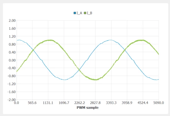

Ia and Ib currents are current phases from your motor, they should look like that :
If you have absolutely no current on one phase, then yes, it means you have a HW issue, because nothing is received from the motor, even in Open Loop.

The image you have shown is of Open Loop or Closed Loop?

The picture was taken with an Open Loop setup, however you would expect the same behavior from a Closed Loop.
