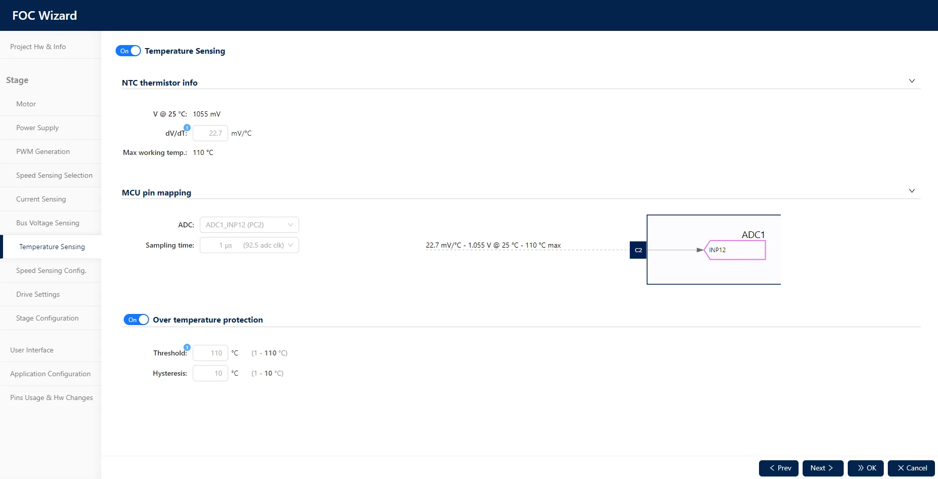

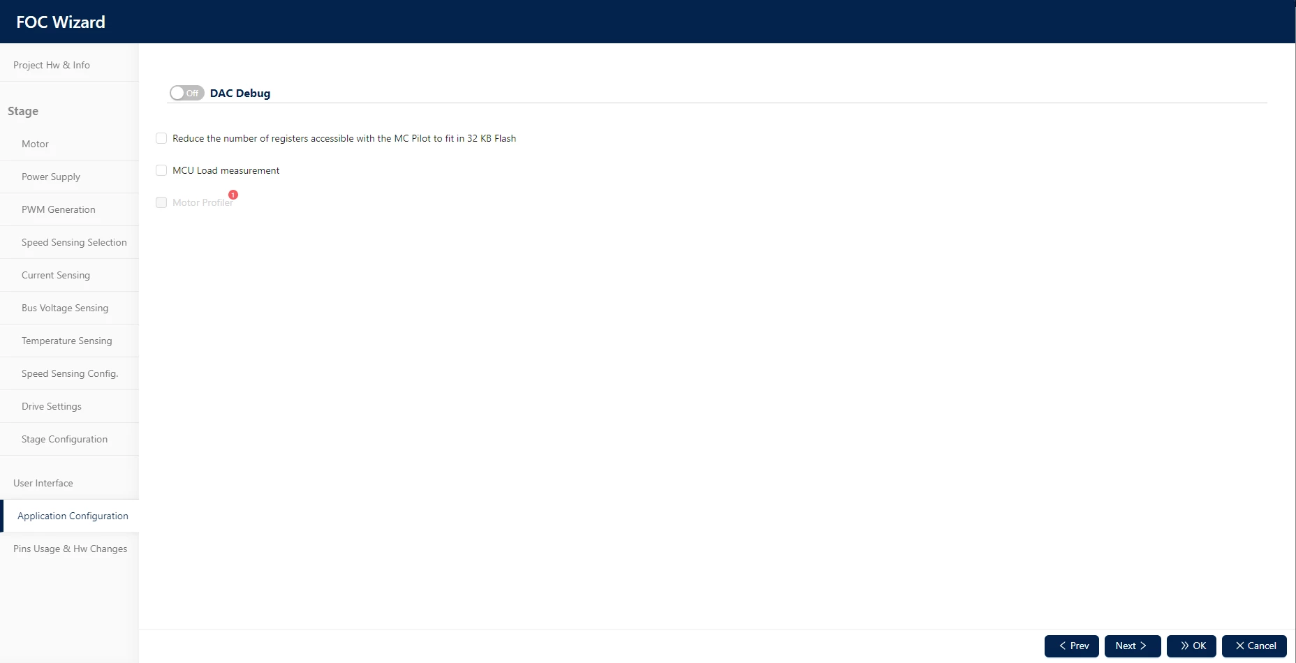

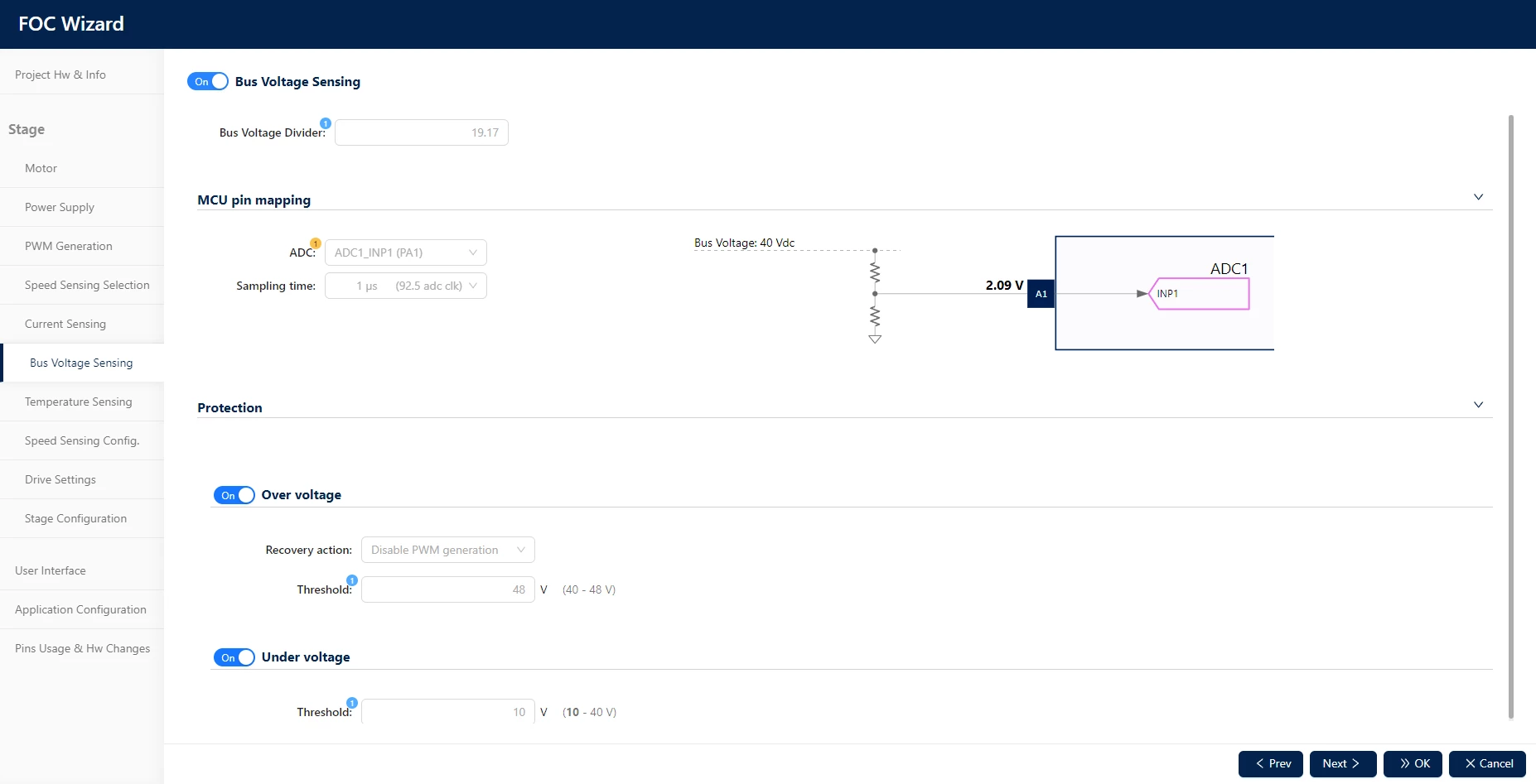

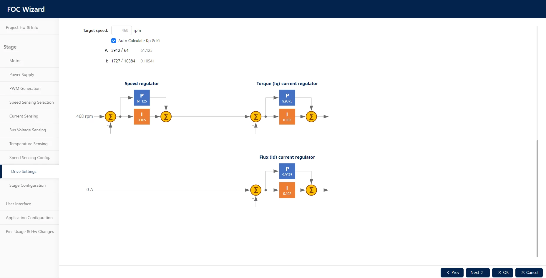

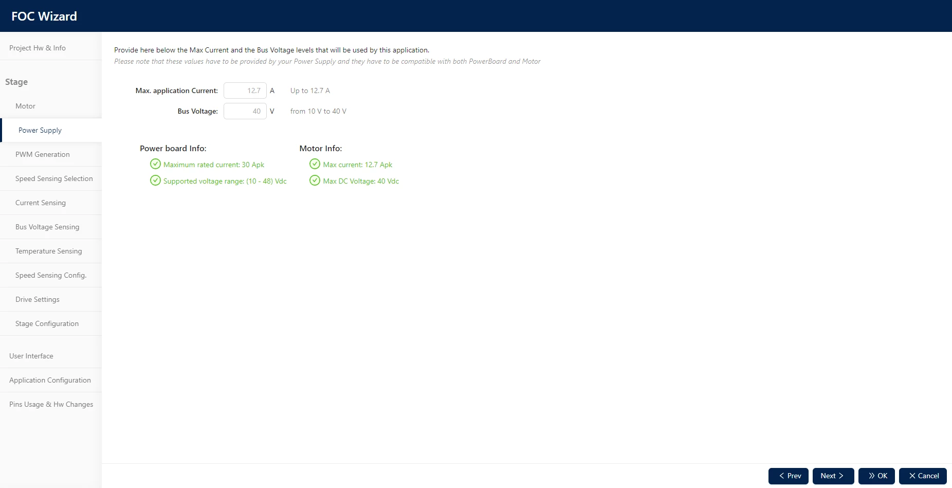

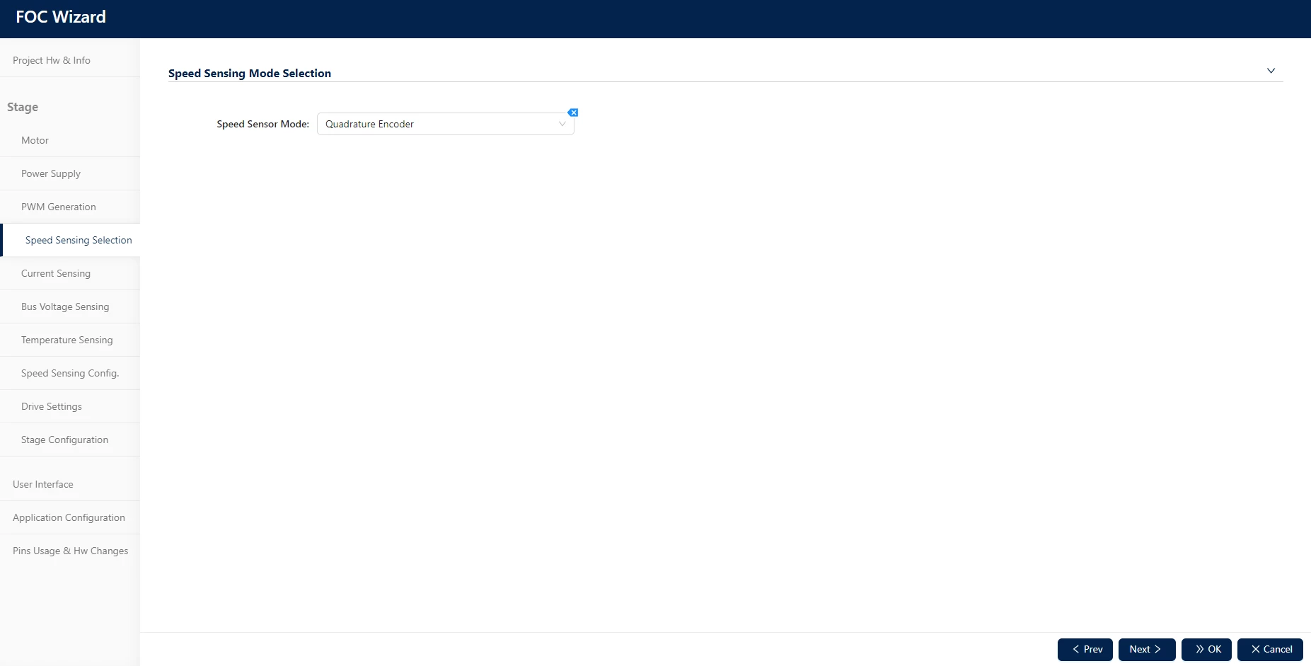

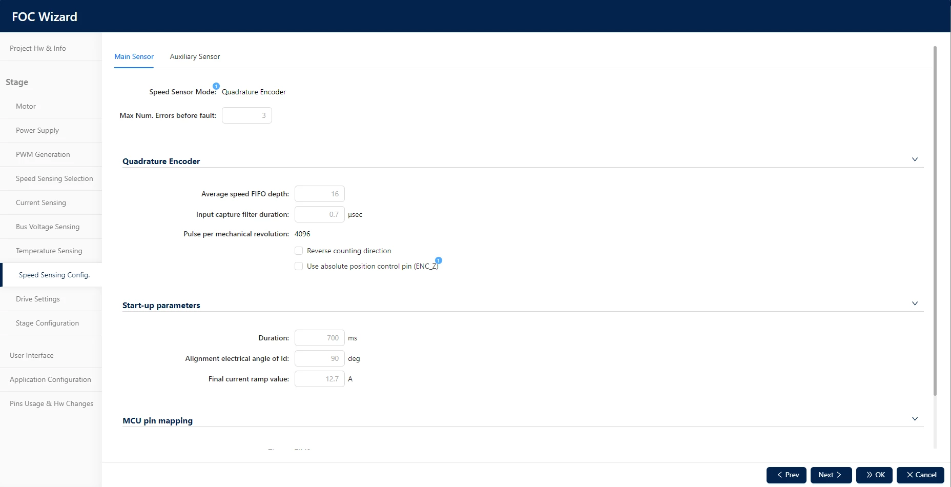

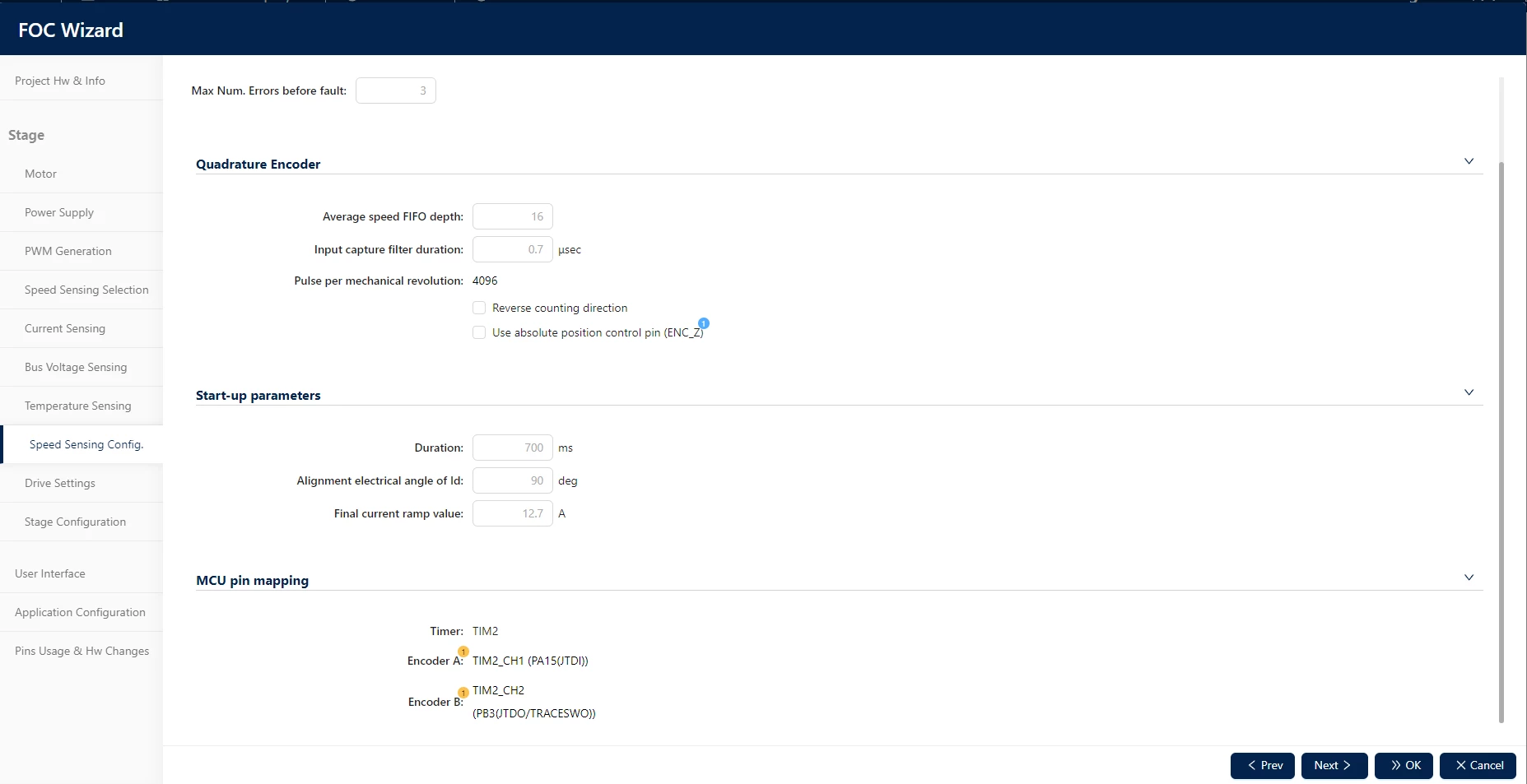

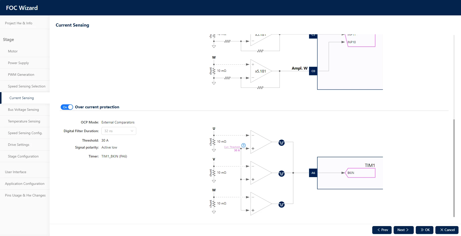

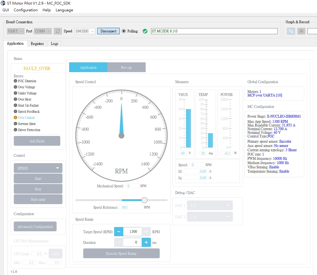

Over Current Fault while I start to control the motor

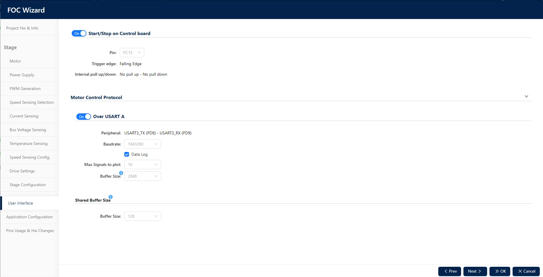

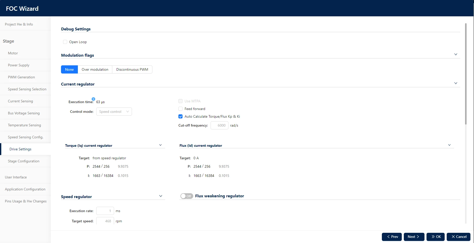

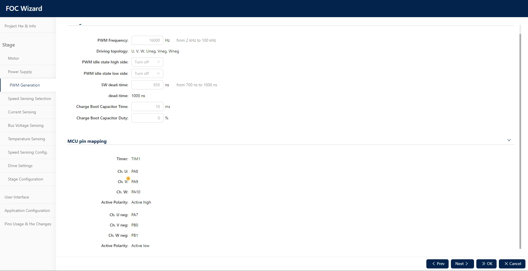

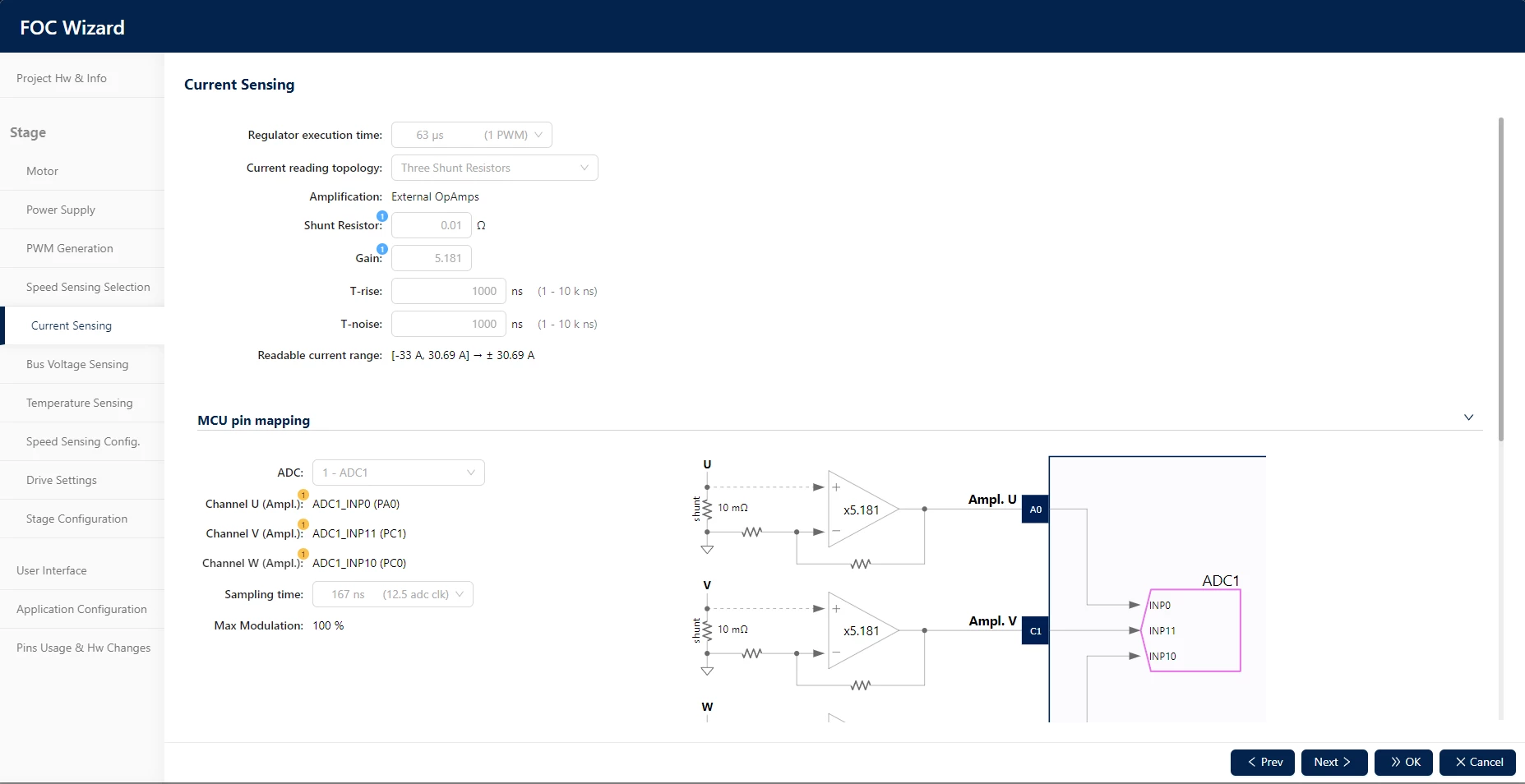

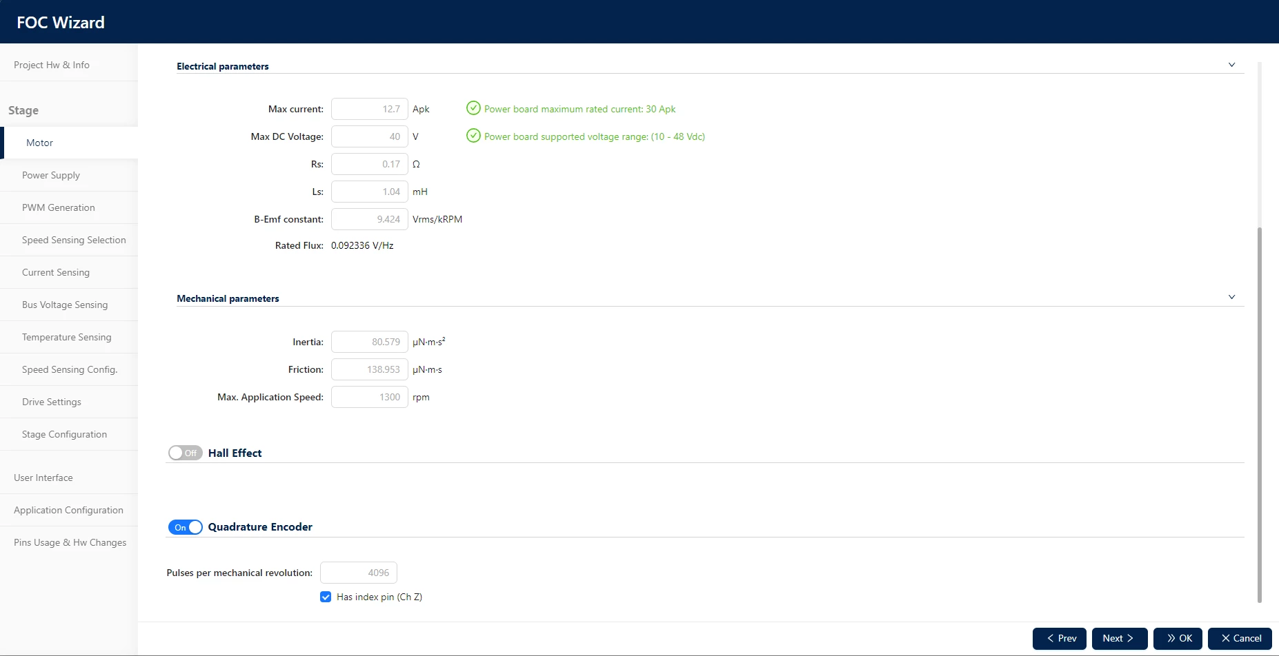

Dear all,

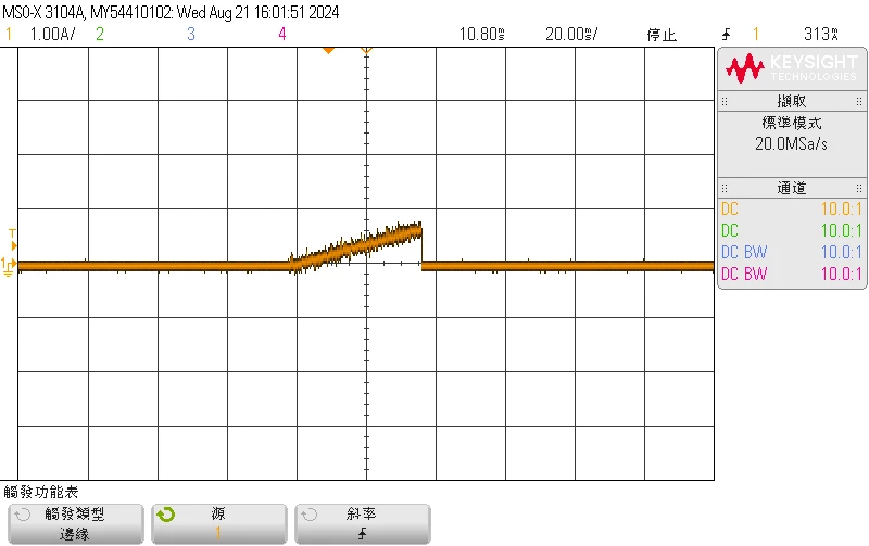

I always encounter a "Over Current" fault once I click the "Start" button.
I have traced my phsae current by current probe, but it is shows less than 1A.
I have no idea what problems it is, has anyone can resolve it?
I list my platform and configuration as follows:
1. Motor Control Workbench 6.3.0
2. CubeIDE: 1.15.1
3. Control Board:NUCLEO-H563ZI
4. Power Board:X-NUCLEO-IHM08M1

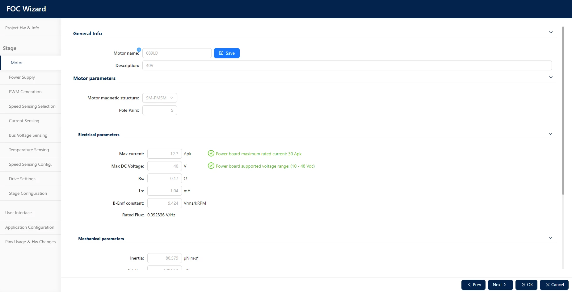

5. Motor: SPMSM, 40V, 12A with an Encoder, 4096 cnts per revolution

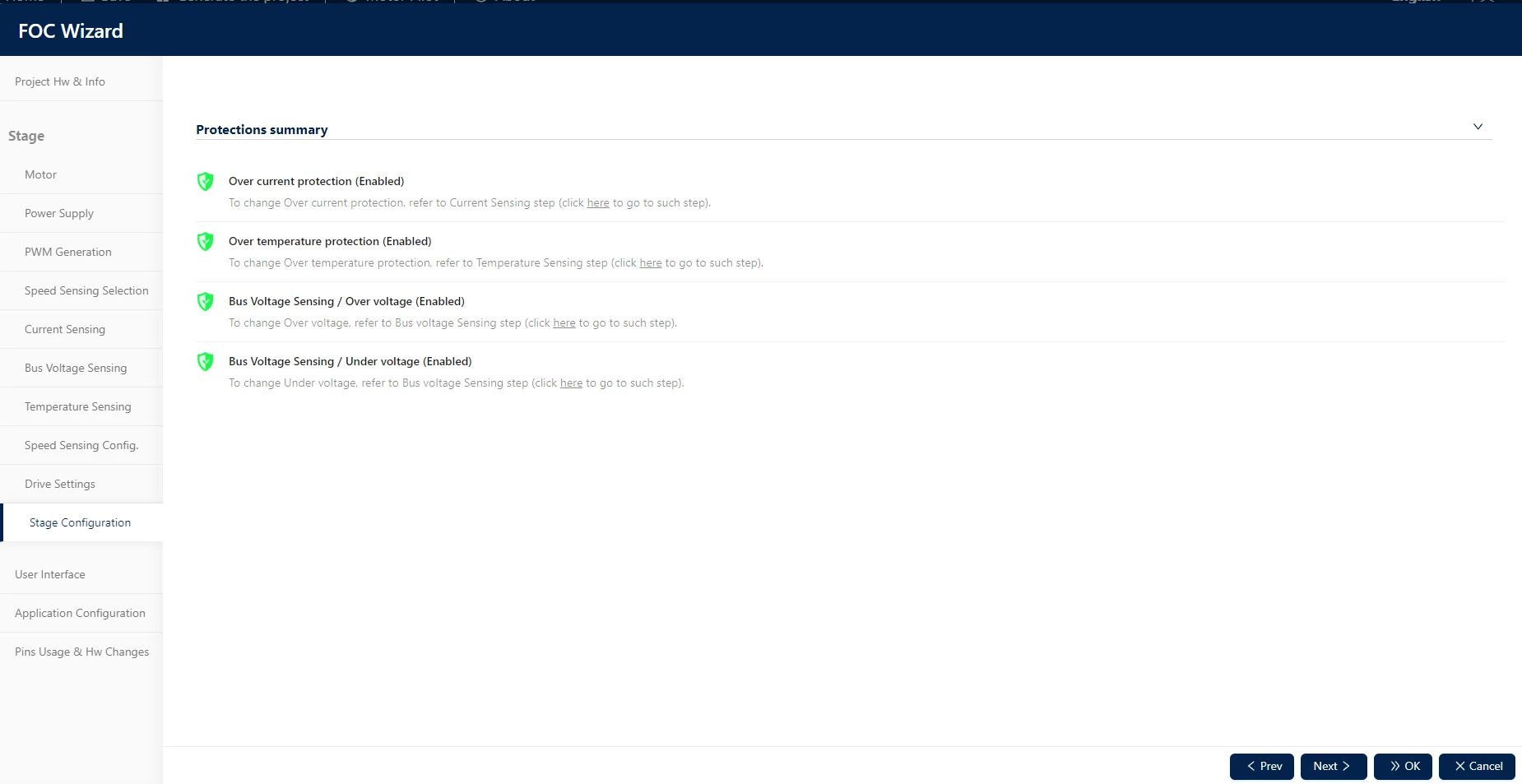

Also, I have modified the HW configuration base on document description and workbench description
The other workbench configuration is listed as follow:
yang2_4-1724230503802.pngyang2_5-1724230536199.pngyang2_6-1724230560750.pngyang2_7-1724230582774.pngyang2_8-1724230604625.pngyang2_9-1724230616991.pngyang2_10-1724230627584.pngyang2_11-1724230636190.pngyang2_12-1724230651205.pngyang2_13-1724230662469.pngyang2_14-1724230673704.png
yang2_17-1724230725780.pngyang2_18-1724230740427.pngyang2_19-1724230753223.pngyang2_20-1724230766862.pngyang2_21-1724230777844.pngyang2_22-1724230787321.png

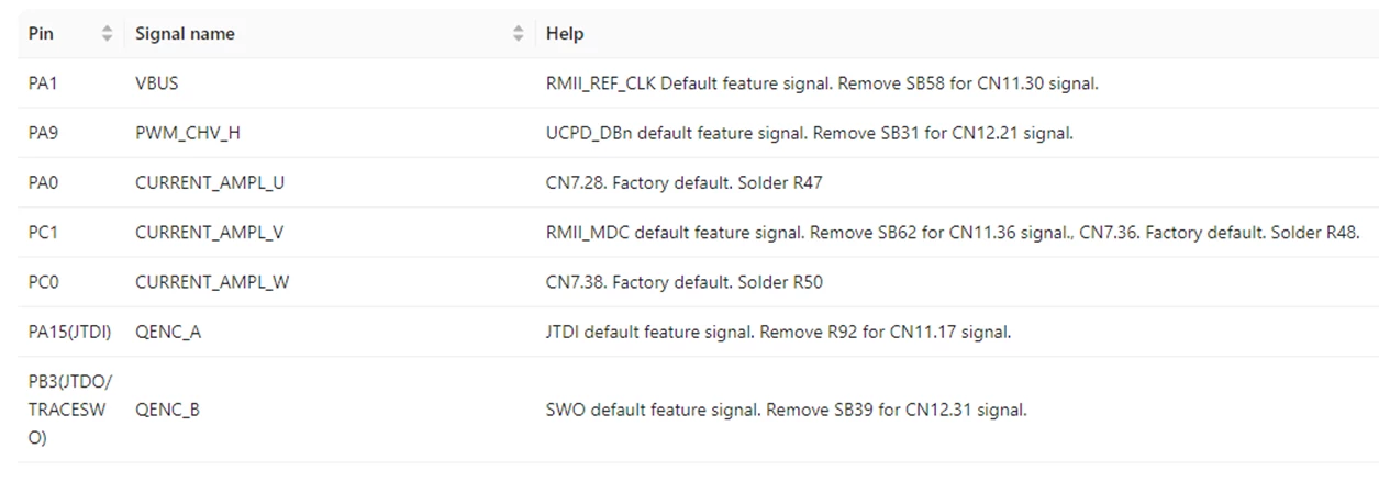

    Hello @yang2,

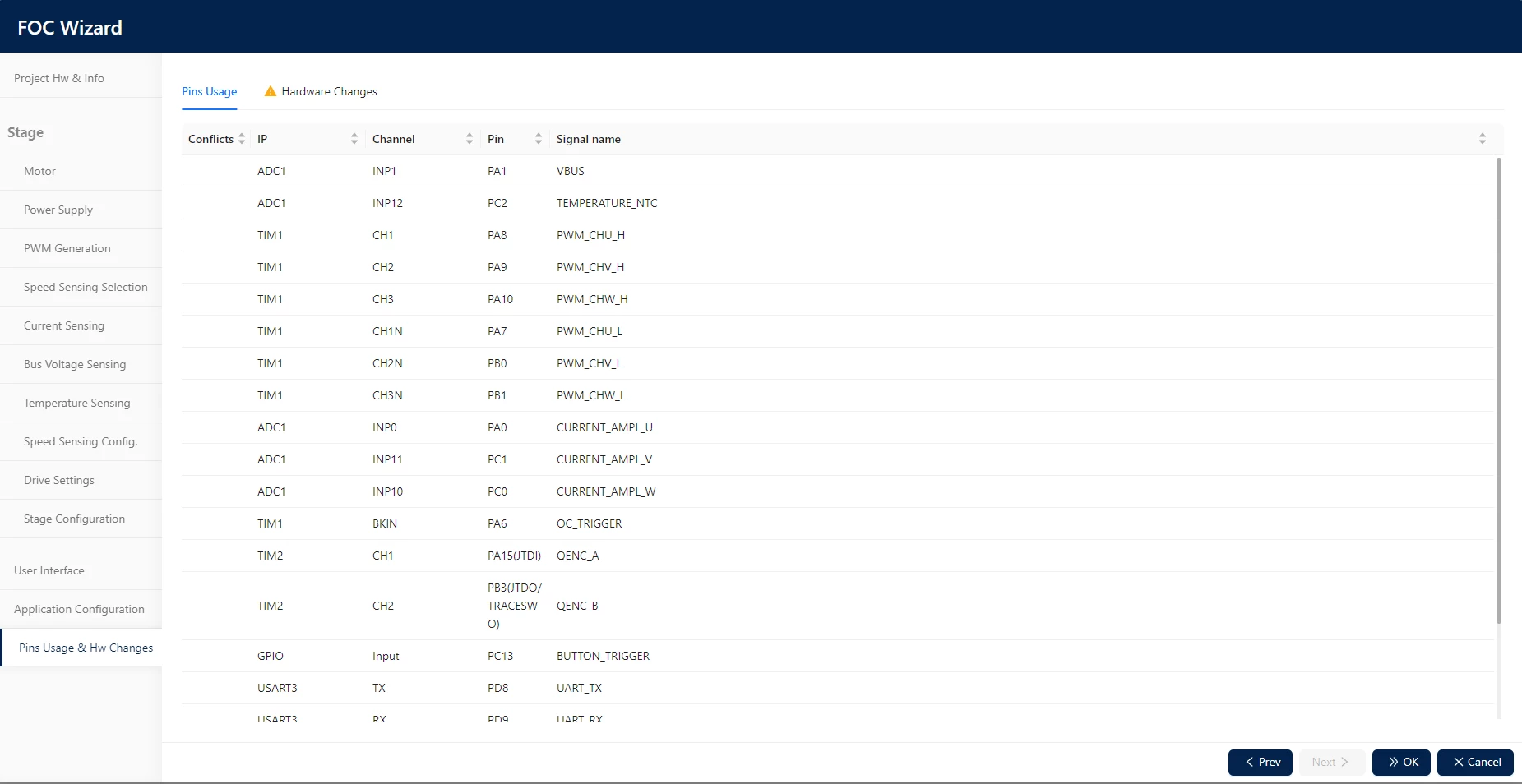

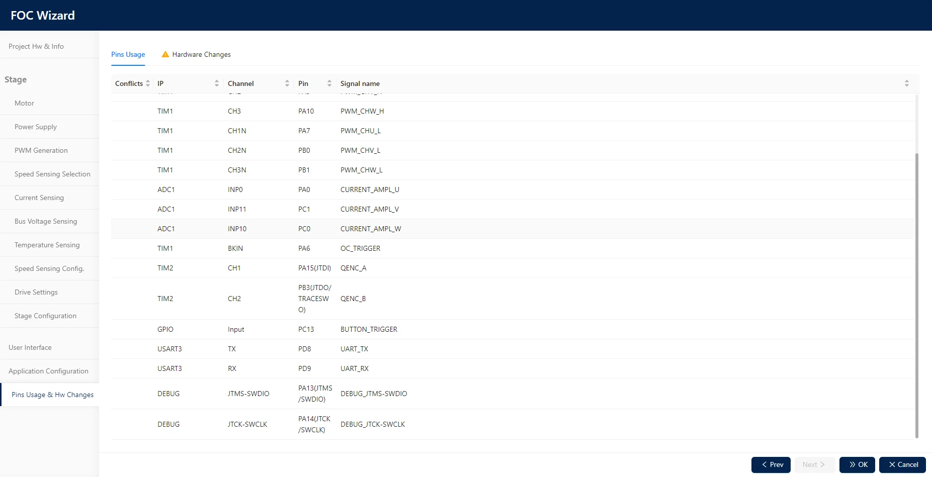

    On Workbench "Pins Usage & Hw changes>Hardware Changes" tab, some HW modifications on NUCLEO-H563ZI board are mentioned like for PC1 connection used by CURRENT_AMPL signal. PA1, PA9, PA15, PB3 inputs require also solder bridge or resistors to be removed.
    If you agree with the answer, please accept it by clicking on 'Best answer'.Best regards.GMA
    yang2
    yang2Author
    August 22, 2024
    Dear GMA,
    Thanks your reply, but I have already solder and remove the resistor per Workbench mention.
    Just as follows,
    Best Regards,
    Fan
