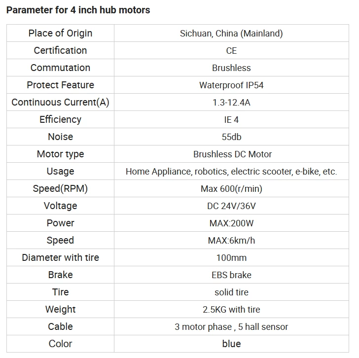

I working with a motor that has very few info : motormotor
Based on the picture, to do the profiling (in ST Motor profiler) of this motor.
Pole pairs : 42
Max speed : 600
Max current : 5A
Voltage : 24V but the application show 23V (therefore 12V as under voltage threshold and 28V as over voltage threshold)

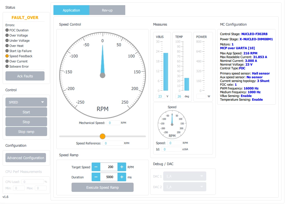

I didn't notice any change with changing the current. Should I just considere 200 RPM as the real max RPM then move on?
If yes then I saved it and used it for my project. I generated the code with MC DSK then ran it but nothing happens, so I opened ST motor pilot and saw that I'm having a speed feedback error : Capture d’écran 2023-09-11 155935.png
What should I do?
GnahoreAuthorBest answer
Senior
September 12, 2023
I solved the speed feedback error by myself by filtering the noise that come with the hal sensors. I changed the capacitor associated with a lower value (from pF to nF). I'm working with 200 RPM max
