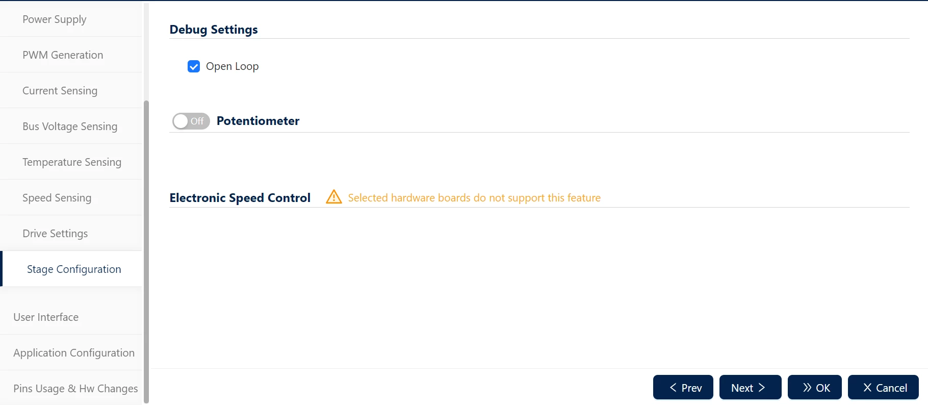

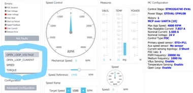

Hello SRedd.5,
Those two options are for a Motor Pilot feature that can be enabled by checking the "Open Loop" box in the "Stage Configuration" tab while creating your project via workbench :
Using the MotorPilot, the two Open Loop Control Modes now become available :
The Open Loop Voltage Mode is used by varying the Voltage Reference value, and the Open Loop Current Mode by varying the Flux Reference Mode. Both are available by clicking on "Advanced Configuration" on the left of the window. Be sure to set a low target speed to ensure your motor manages to start.

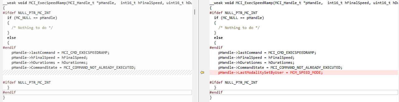

Now I have landed in confusion when you give the last command Mci_execSpeedRamp it does not stay in open loop mode it goes to speed mode, could you please explain me this?​

It is my mistake
