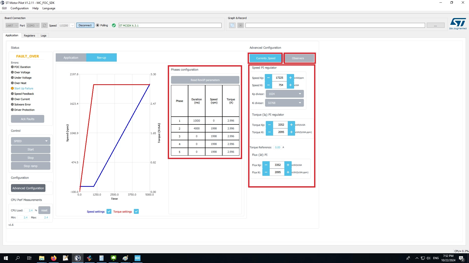

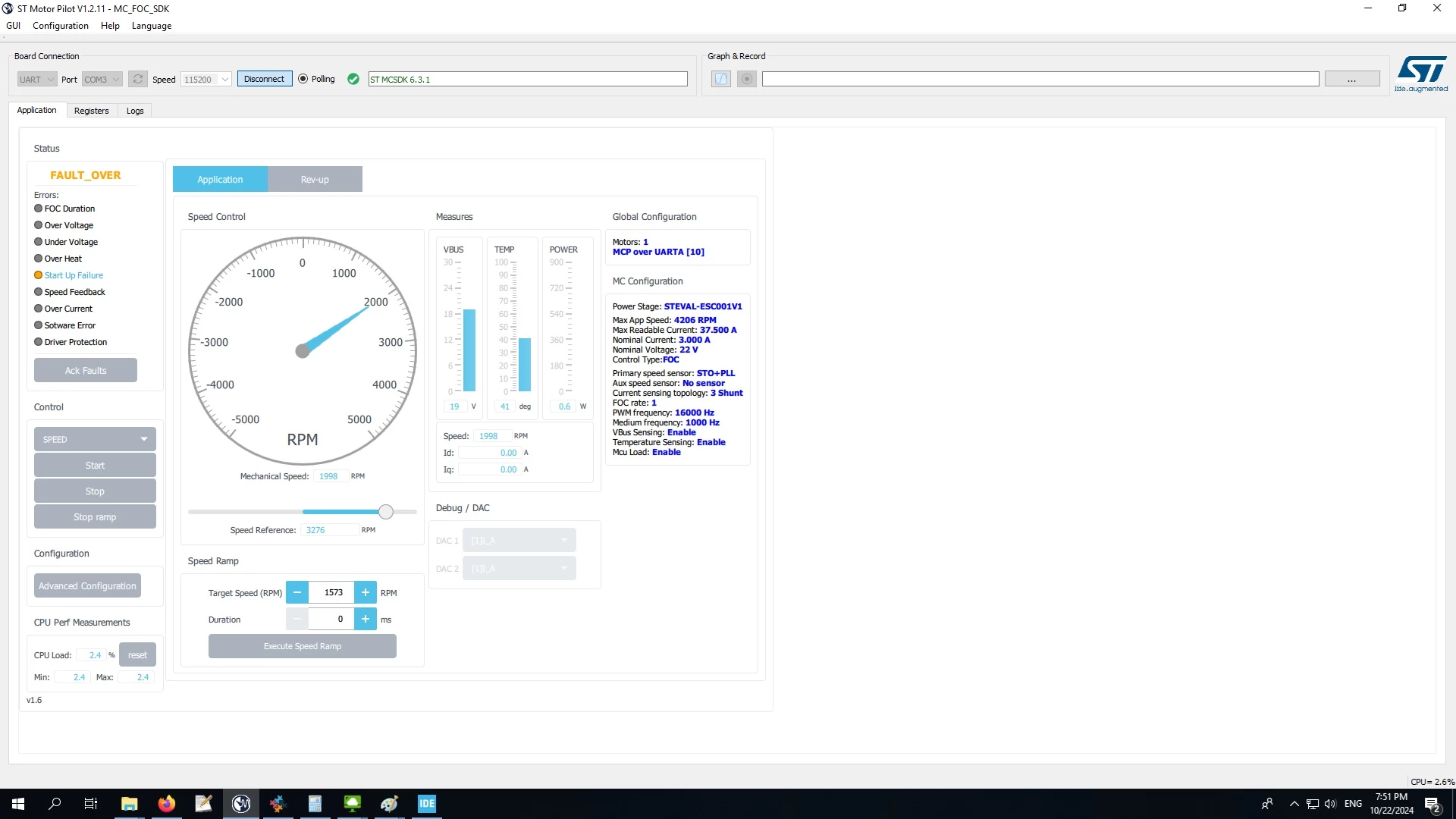

I am using the MC Workbench V6.3.1. When I generate the code and the profiler is activated, I can run the profiler and the profiler learns motor parameters and turns the motor. After that, when I go to "Motor Pilot", I can turn the motor. But when I build a new project with the profiled motor and generate the code, in the "Motor Pilot" the new code only rotates the motor for a few seconds and then the "Start Up Failure" happens.
I tried to copy "Rev-up" and "advanced Configuration" from the motor pilot after I run the profiler to the similar parameters of the new generated code. But still motor stops after a few seconds. Specially when I copy "Torque" and "Flux" parameters, the ESC currents reach its maximum (3A) and it generates loud sounds.
What should I have to do, so I can transfer all configuration from profiler to the main code?
