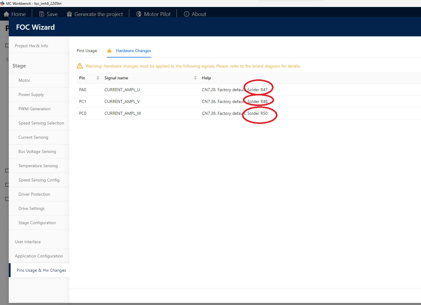

NUCLEO64_G4531RB + X-NUCLEO-IHM08M1 + FOC project "HW Changes"
I'm having trouble understanding what the instruction below wants me to do.....
It says: "Solder R47".
-On which board?
-Solder it where?
-What value is the resistor?

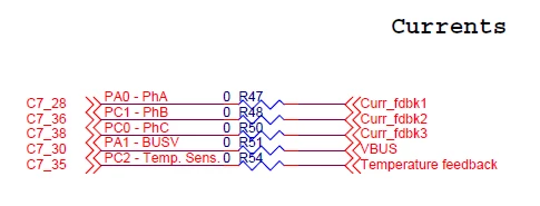

    Thanks! Just realized that schematic isn't searchable (its an image) which is why my search yesterday turned up nothing

    Dear sgordon777,
    These warnings only point out that R47, R48 and R50 from IHM08 must be present in order to have current signals available. From X-NUCLEO-IHM08M1_schematic.pdf document.
    If you agree with the answer, please accept it by clicking on 'Best answer'.Best regards.GMA
