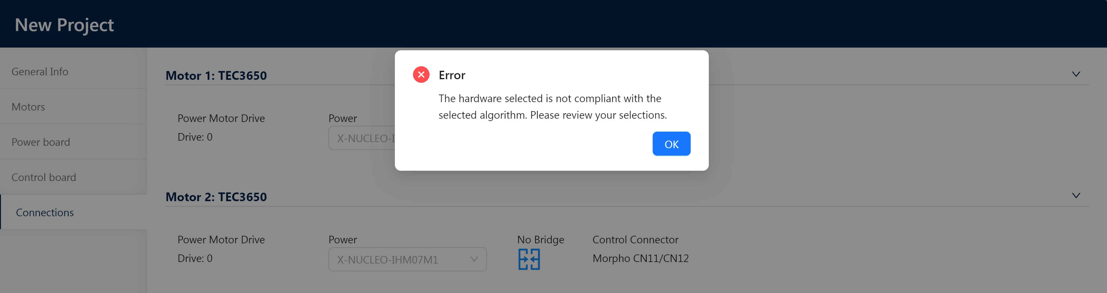

apexyzAuthor
Jan 6, 2025 2:15 AM UTC
Thanks for the prompt reply! But when I config 2 motors in MC Workbench, I got the following error message:
How to set up the wiring and power handling properly?
GMA
GMABest answer
Jan 7, 2025 2:25 PM UTC
Hello @apexyz,
You can filter control boards that support dual drive by using "Filters" feature (NUCLEO-F446ZE board is not available on current MC Workbench version):
If you agree with the answer, please accept it by clicking on 'Best answer'.Best regards.GMA
